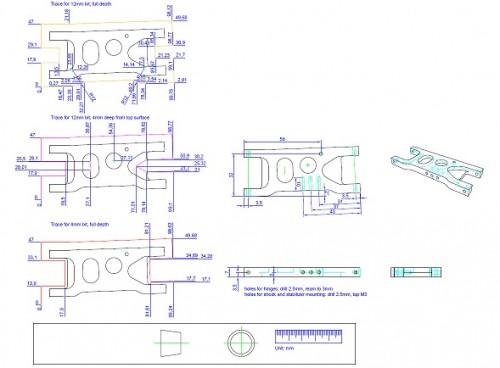

Mr. ED wrote: Sat Jan 28, 2017 6:40 pm It took me quite a bit more than 5 minutes to do this . But it went pretty smooth. I'm glad you like them.
They are easy enough to modify, so maybe some day I'll make some slightly shorter ones to use with cvds and hex wheels with more neutral offset.
You did a great job. In no way did I mean to downplay the work involved here. I was just trying to convey how blown away I was by your work. I'm going to find someone to produce these as soon as I can. I want a set right now! I will be getting a cnc mill capable of making things like this but it may be a little while. Unfortunately I'm not as wealthy as I would like to be :lol: They aren't extremely expensive however it will take some time to put the money together. What file system have you used so I know what to say when I find someone to make them for now? I will also have to get your information so I can compensate you for your work. I would never take advantage of someone else's work without fair return.

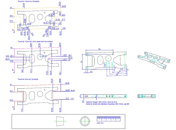

If you ever get that cnc mill, I'll get behind the pc again and you can make me some small stuff.
I'm in Belgium, but you may find old posts from my time in Japan (2 years). I also lived a year in China, but that was before I joined the forum.
I made the design in Rhinoceros but their native format is not something that you're likely to be a able to import in a cnc software.
Rhinoceros will export to quite some different formats. Which format you need, that depends on who will make the parts and how they will make them.
So, send me your email by private message, and I'll send you a technical drawing in pdf format. That way you have something to communicate with a potential supplier.
Since you're in the US, I suggest you take contact with forum member GoMachV
PS:
I just finished the drawing for the left front arm. I guess the mirroring is no problem.
Now on to the rear arm: bit harder with the angled stuff inthere.

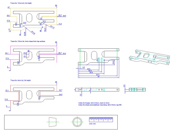

Unless there's anything to correct, clarify or improve... the drawing for the rear right arm is done
Allen, just to be sure: you do know the wheels of the 91-92 yokomos are quite particular and need special mounting hubs right?
I mean you won't be able to use the 12mm hex wheels wheels you have, not even if you have a fitting U-J or cvd. The offset on your wheels would put the wheels too far out still to be legal.
[/quote]
Yes I'm aware. I assumed that you were designing these for use with stock carriers and wheel hubs. That's no problem. I'll pick up a set of wheels and hubs before all is said and done. One question though. Are the yr-4 carriers and c hubs anything like the yz10 set up or will I need to pick up a specific 91-92 yz10 set? I'm sure they are different somehow but do you think they will work?

Yes they are very similar if not the same. There are a bunch of subtleties with the cars but most stuff can cross.

They were identical with the stock yr4 items. Later versions of the yr4 used some different versions.
