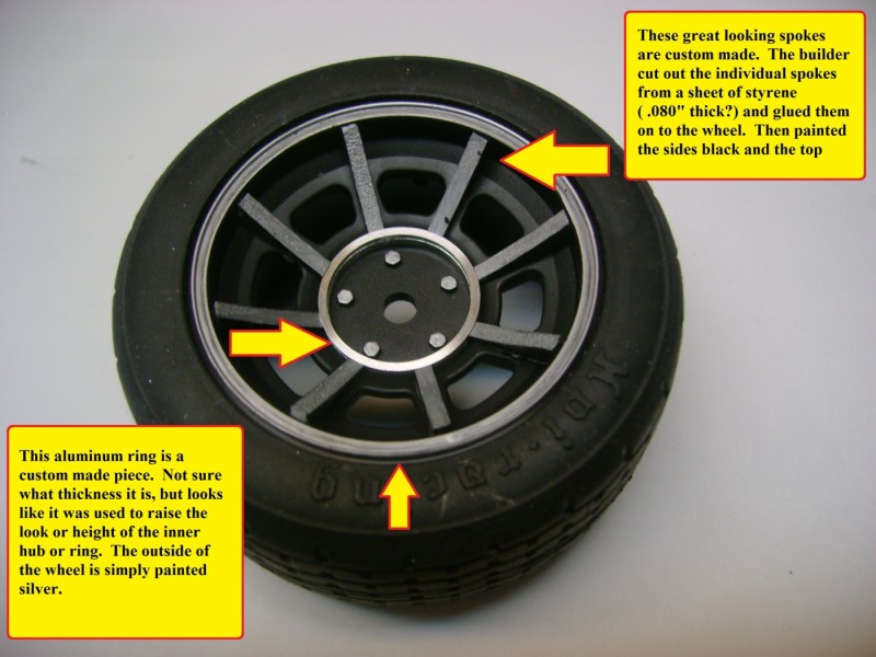

Diamond Dave wrote:Just a suggestion, but maybe some orange on the wheels somewhere to offset the look? Or some white lettering on the rubber to break it up abit?
Dave, I'm going to be modifying these wheels to look like these. I just need to find some center rings and then I can start making the fins. :D
ratrod63 wrote:That looks really cool. Now you need to build Rosco's police car.
Thanks! I need to finish this one first. :wink:

Tedious for sure, if you follow some of the ideas in the picture I am sure you will get it.

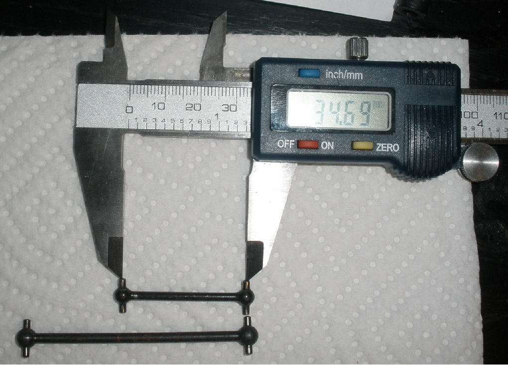

Well, I ordered some TT-01 dog bones and well, they are the right length, but they are double the thickness and are not even close to fitting in the drive cups. Back to the drawing board I guess. Anyone here have any other ideas on a dog bone that would work with the TL-01?
Stock TL-01 dog bone is on the left. I need between 30-34mm to make it work.

Coelacanth
Posts: 7350
Location: Alberta, Canada
Been thanked: 270 times
Re: TL01 General Lee project
Post by Coelacanth »
Jeff, I was going through my Optima dogbones and found this one, it's about 34.5mm from the center of crosspin-to-crosspin. The ball is a bit smaller though, as you can see compared to an Optima stock dogbone. It's yours for the cost of shipping. The only problem is, I only have one. :? I don't know how I ended up with only one, but my guess is this dogbone might be for the narrow front end of the Kyosho EP/GP-10 series of on-road cars, basically on-road versions of the Optima chassis. Maybe somebody else can hook you up with a second one, or happens to know what car or part number belongs to this dogbone?

Thanks for looking for me! :wink: I think I found what I need after hours of searching last night. I ordered part number 9805583 Dog Bone set for M chassis cars. It took me forever to find the length but it turns out that these are 31mm. I hope it is right, if not I will take you up on your one. :wink: I hope this is the last hurdle for this build.

Well, the 31mm bones did not work, too short. They measurements on them were actually 30mm pin to pin. Man, I’m going back to the drawing board on this. I need 34mm bones to make this work but can’t find specs on all the different types out there.
I have some spare axle carries from my Sprint that I am going to retro fit onto the arms but will be going back to the longer arms in the rear to make up the difference. I want this to be perfect so I won’t stop until it is. :)
Coelacanth, I would take you up on your offer, but trying to find another one will be difficult and is so close to 36mm, it might not work. I'm tired of buying bones that won't work... :evil:
