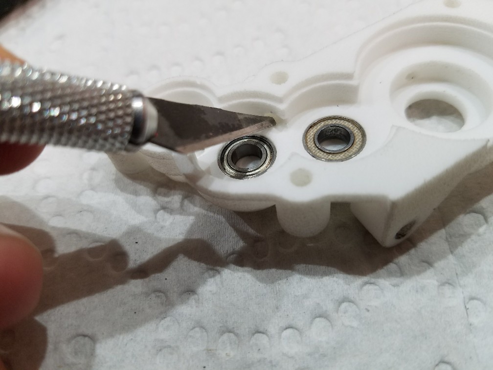

Preparing the transmission case
The transmission case may need a little detailing before assembly. Sometimes the bearing bores can be a little tight. I like to take an X-acto type blade and gently scrape the inner surface of the bearing bores in the case as shown below. This is usually sufficient so the bearings will be a nice snug fit without being overly tight. At this time, you should also tap the holes on top for #4-40, the bottom #4-40's (if you plan to use them, such as on a chassis drilled for a Stealth), the bottom front #8-32's, and the bottom rear #8-32's (if you are using a non-Stealth chassis)
