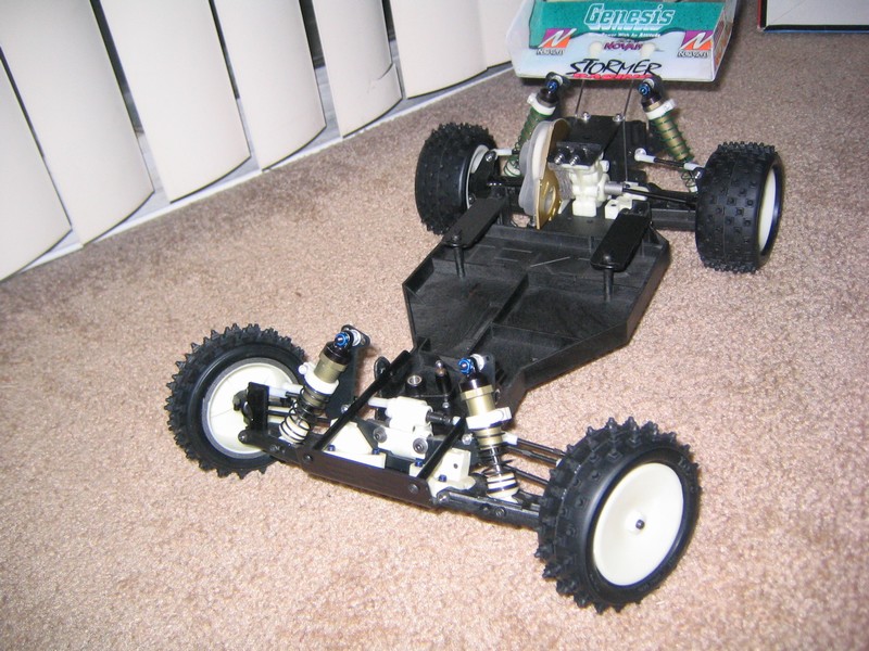

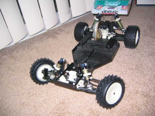

There was a thread called the "MIPKIN" wich combined a Tekin Mid-Motor chassis with the MIP 4x4 kit.
Check it out HERE.
That is NOT my project, but I liked it so much I saved all the pics from it, I'll add one here 4 now.
The biggest challenge with any mid motor conversion with 4wd is to get the belt past the motor wich will the be in the way.

I never finished he projec bu I got a good end on a 4WD ultima using the mip idea.littlescreamers wrote:
Has it been done before??
Thanks
Scott
Basically I used origianl gearboxes with longer top shafts, a pair of pulleys and a belt o connec them.
You could do the same with 2 stealths but like me you'll end up with a very high front... I considered making it a stadium truck racer but as there's no 4WD truck class I didn't see the point and quit on it
