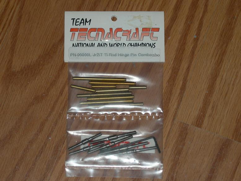

The first parts for this project were NIB Tecnacraft titanium hinge pins & turnbuckles. Thanks again for this member who sold them!

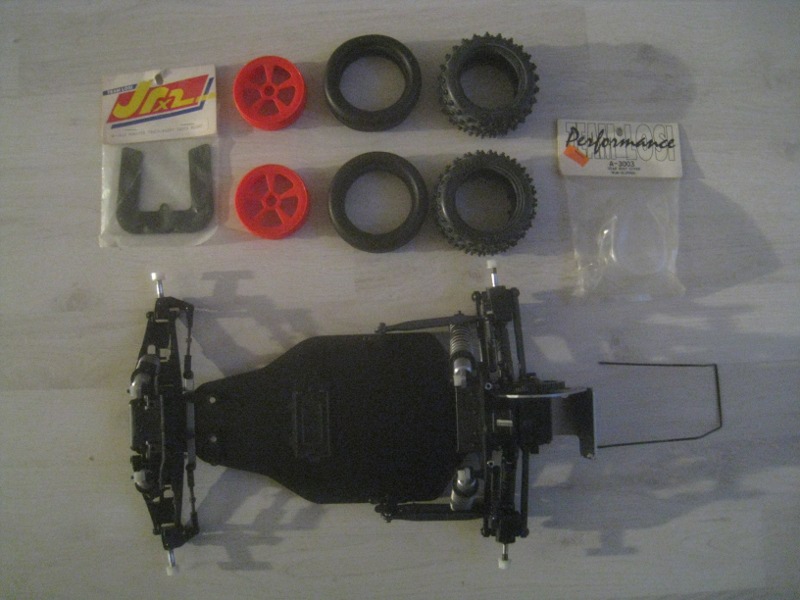

I got this Jrx2 from rc10talk member and it arrived earlier this week. It was a little coincidence that I got this Jrx2, I was first only asking some Losi help from him, since I had a feeling that he have it much more Losi knowledge than I. Lucky me, he had one unused Jrx2 for sale and soon that car was on it way to new home. I also got some other needed parts for this project from him: Red wheels, JrxT front shock tower, "Kit" compound front tires and "High Traction" compound rear tires, NIB gear cover. The car have also correct rear shock tower, the one with four lightening holes:

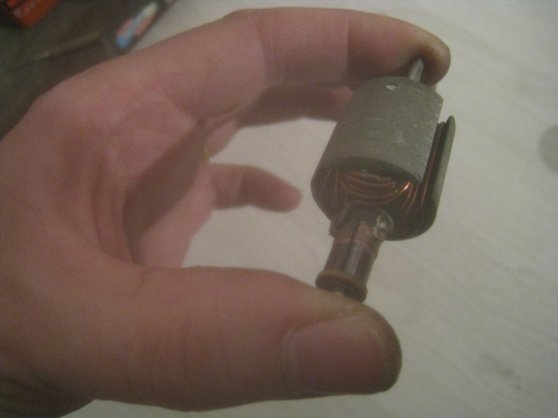

I also have some parts left from my Losi era: Team Losi "foam rings", some hardware, firm rear springs and Jack Johnson's Motown Missle 12x1 motor. That motor is in EPIC can. I don't know which is the right can: EPIC or Yokomo.

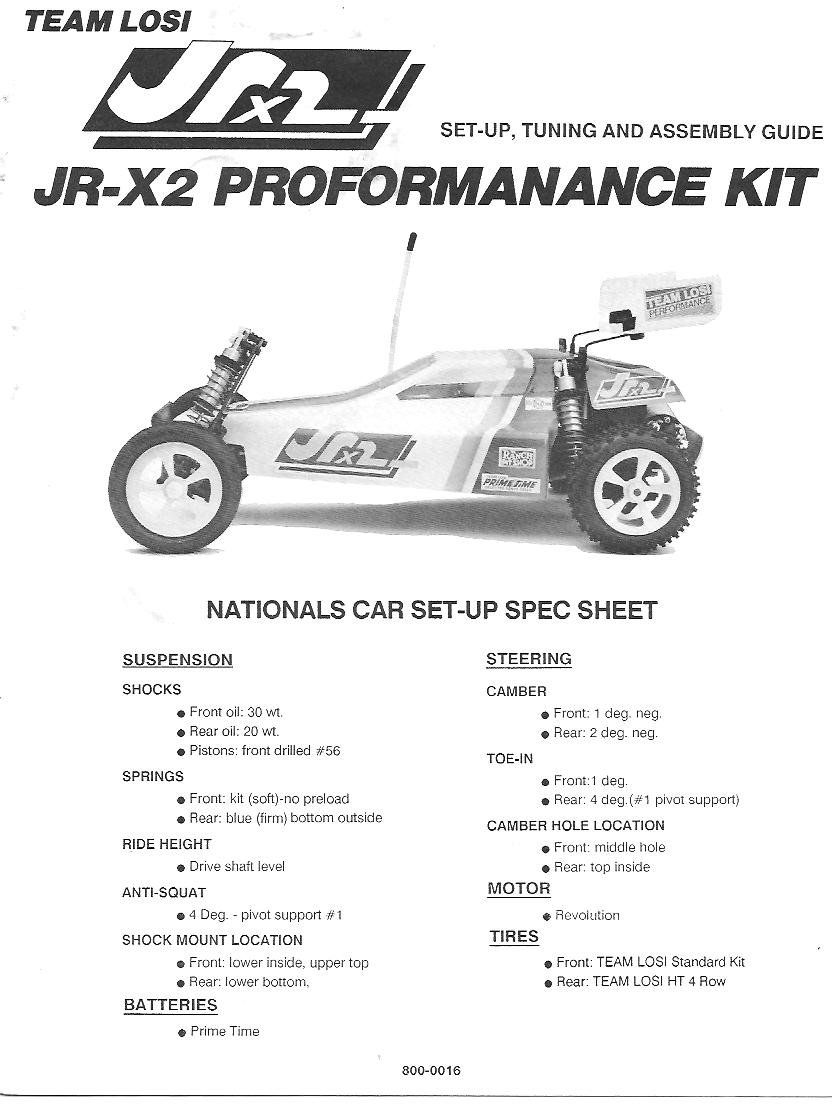

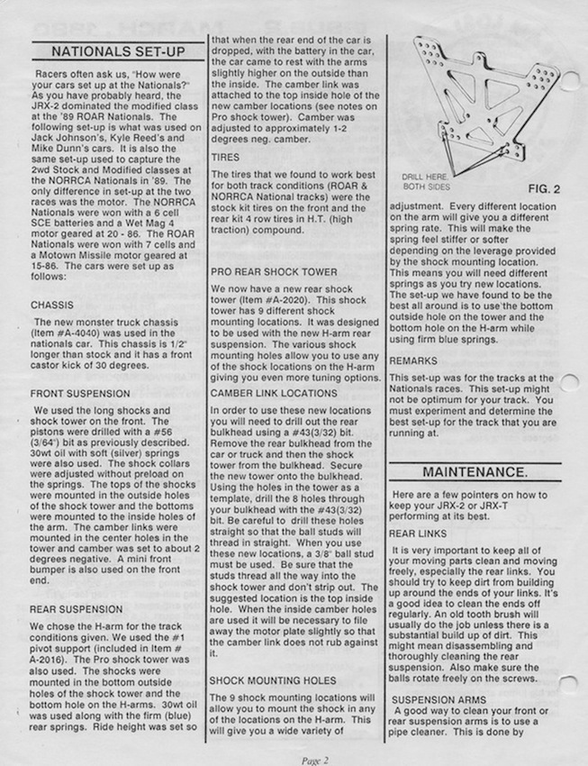

There is also really good setup info available:
There is some conflicts in setups between those two, but I will somehow trust more the "Tech Sheet 2" info.

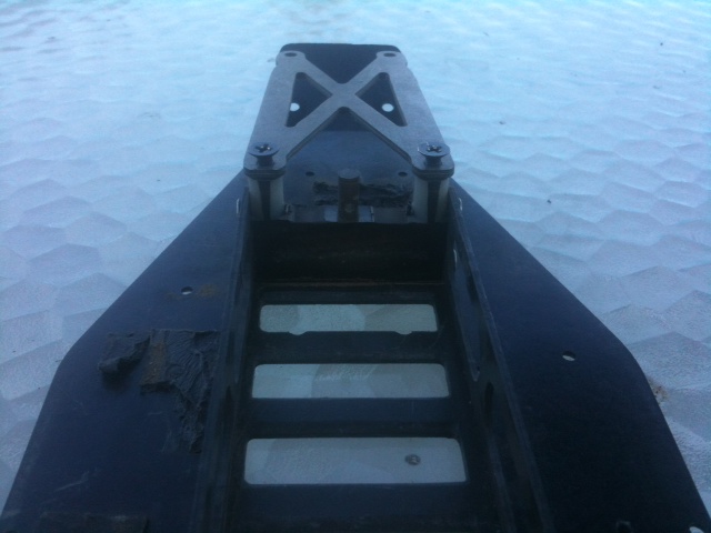

And now the chassis:
Chassis photo 1.JPG (31.71 KiB) Viewed 6210 times
The bottom of the chassis is early JrxT chassis without the servo saver hole. There are holes for cells and because the battery sits lower the battery supporter will fit under the rear bulkhead. Since the chassis is hand made all the chassis here and in previous posts looks a little different: slightly different rounding, different number of holes etc. Also interesting are the holes (5 pieces) around the chassis. Alternative mounting hole for antenna on right hand side of the battery. Four on left hand side are for lexan transponder mount, see Ron Rosetti's car above.
Jirka
EDIT: The chassis in pictures above is not mine, I was just very very lucky to get these pics!

Great pictures of that chassis - was it an original from BITD or is it someone else's replica of the original team cars?
Interesting looking at your various photos, there seems to be both LWB & SWB versions? Jack Johnson's car looks to have been built around the original SWB chassis but the other photos seem to show LWB chassis' (in some cases shaped around the sides?) . . Looks like JJ's chassis doesn't have the battery slots either? - just my casual observations :wink:

Derby Dan: The chassis pics are from original car. If the owner himself wants, he may introduce himself here. But the chassis on Jack's car, to me it looks like he only wanted to use SWB Jrx2 body on his car and therefor he have cut a little his chassis around servo area. To me there seems to be slots for the cells in the chassis, but if there are only 6 slots then it must be SWB chassis. If however there are 7 slots then it must be LWB chassis. But I definitely like to hear others opinion here.
