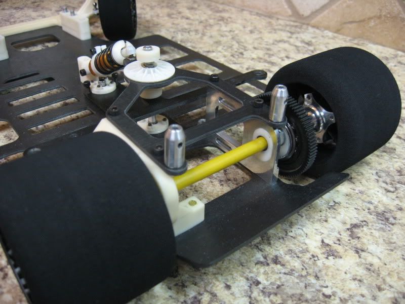

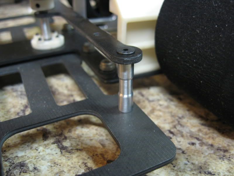

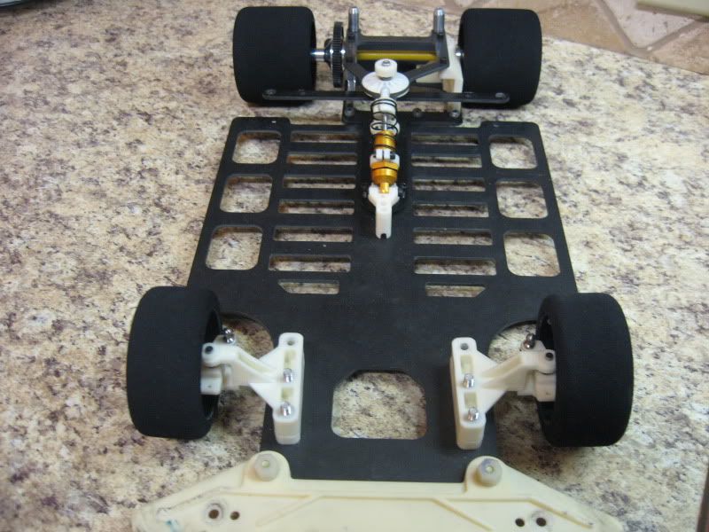

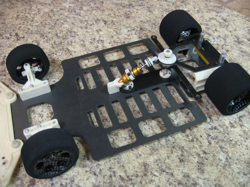

I have been collecting parts for this car and took a pretty big break from working on it. I finally got most of the car together but still have a few minor things to do. I ended up machining some new axles for the front to bring the front tires out roughly 1/4 inch. The outside edge of the front tires are now even with the outer edge of the rear tires.
I installed an IRS rear axle on the car and I beleive and HPI bottom pod brace witha small kick up and a Composite Craft upper pod brace.
After consulting with the experts the front brace I made has been removed from the car. I am going to machine another brace that will not interfere with the castor in the front of the car.

I have an IRS hub on the right. The left side has the standard 10L hub. I need to find a left IRS hub to match.
The car is turning out nice, Just a tad more to go. Then comes tuning questions for a basic setup to start with.

The front axles are cool and will not hurt anything, however most pan car racers run 1/8th axles cause the balls are bigger and last longer/suffer damage less often. Love the machine work you're doing.

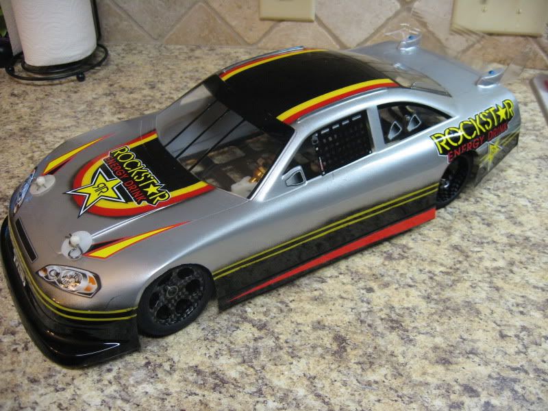

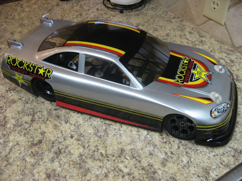

I got the body painted and partially mounted.
I decided to go with my own Nascar theme on this one. I found the Rockstar decals on eBay from a drift car. Did some modifying of the decals to work on this car. I still need to find some numbers and buy some fender decals to make it look the part. Like an idiot, I should have drilled my body post holes before paint. It is very difficult getting the body to line up with the wheel wells. I need to do some more trimming.
I also machined some posts for the rear support. I still have a few other things to do to the car including machining a new front brace for the front suspension. I am waiting for the material to arrive. Other than that I think the car is ready for electronics.
