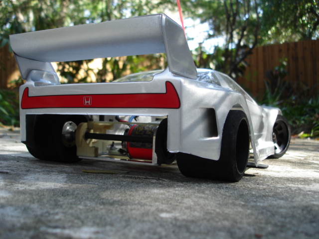

nice, what size body is that? More pics would be great.

Sorry, you are looking at the only remaining pic. The body was bashed, duct taped, bashed and recycled. I know it was minimum 200, maybe 235 hpi. The rear wheels tucked behind a flared rear end if you bumped the body out over the worn nerfs.

what motor are you planning on running in it?
I got my first 10L runner almost ready, but have no idea what to use for a motor. I'm going to use a brushless system in it, but if I had an idea of even what brushed motor, it would give me a starting point.

I run the pan cars with a variety of motors, the fastest being a 9t single reedy ti. You will have a blast with a stock motor, trust me. Figure out how to set up the car and make it stick with a stock motor and work your way up. If you go this route you will find that you learn how to drive the car. I promise you will not learn anything if your first pan car run is brushless, or modified brush, for that matter.vintage AE wrote:what motor are you planning on running in it?
If you are just having fun in the street, swap out tires or you will be replacing softer compounds in a hurry. I prefer dual stage fronts as the fronts tend to wear quickly. I also prefer the original front arms over the dynamic front end as I have yet to break one. One good shot on the dynamic and you are buying parts. I add a mixture of baking soda and crazy glue to fill the void in the riser on the original arms. I have not broken an original arm with or without the glue trick.
I was amazed to see 12th scale pan cars run brushless on a prepared asphalt track. Pan cars, 10th and 12th scale, are just plain crazy fast. To put it into perspective, I plan to go brushless for my buggies but honestly do not see the need in my pan cars. I would venture to say that I am very close to 40 mph with the 9t reedy and heavy nimh batteries, maybe a little faster with lighter matched nicd. I can pass cars at will that travel through the neighborhood at 30 mph. That is with a 81x16 48 combo. The novak cyclone and reedy are barely warm when I'm done with a run. All that to say I can put taller gears on and go a little faster

Use a 17.5, 13.5, or 10.5 turns, depending on the track size (17.5 or 23.5 if not running on a track). With a 10.5 you should be able to hit 60 mph with ease, but you'll need a good body (e.g. Corally/Protoform Nissan P-35).
