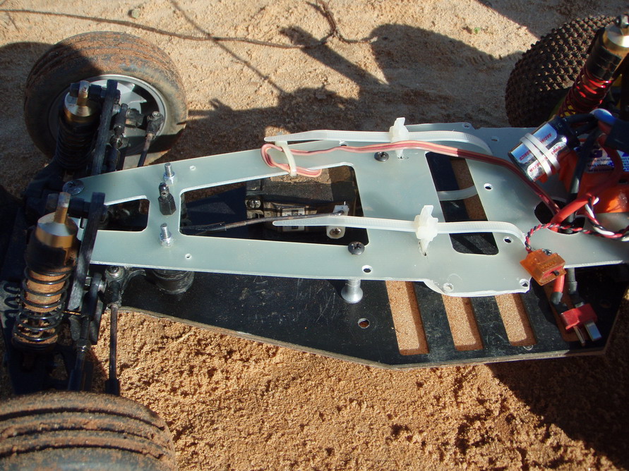

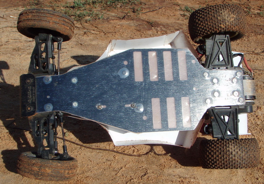

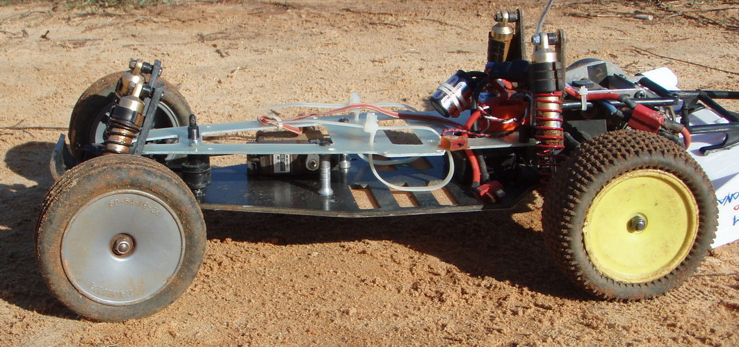

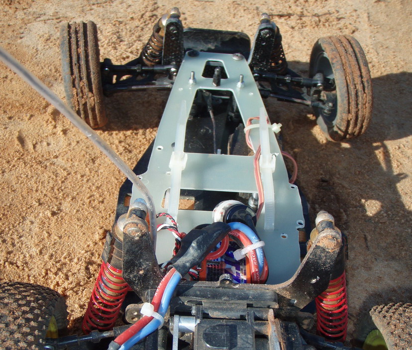

OK, mounted the carbon chassis on my vintage racer, so thought I'd share a few pics. I used a fiberglass plate as an upper brace/battery straps anchor/ESC tray which makes the entire assembly VERY rigid. I used Associated chassis protector on the underside to avoid scratches. The original front shock tower broke in a bad landing, so I used it as a template to make the new one from carbon fibre, you can see it in the last pic.

Cool!
Very nice you could fit that butterfly body still.
The rear looks a bit narrow with the lower offset wheels.
Did you take a look at the new ultima or lazer CVD's and hubs yet?
I'm pretty sure you can use those to bring it up to the legal 250mm.

I'm trying to keep it as period correct as possible but still remain competitive, The 2.2'' wheels & tires where a must since I didn't know of any vintage tire that would give the traction of the M3 Bowties on the track (and vintage tires are quite expensive for everyday run anyways). I don't feel the smaller rear width hinders the performance (and I'm racing against RC10 CE & Worlds!) so I'll keep it original for the time being.Mr. ED wrote: The rear looks a bit narrow with the lower offset wheels.

I'm using some tamiya wide wheel axles om mine. They just fit straight into the standard hubs and use hexes with a crosspin. The axles are longer and the hexes about 2 times thicker than the standard ones.
I think they are F201's option parts (not sure about the number)
