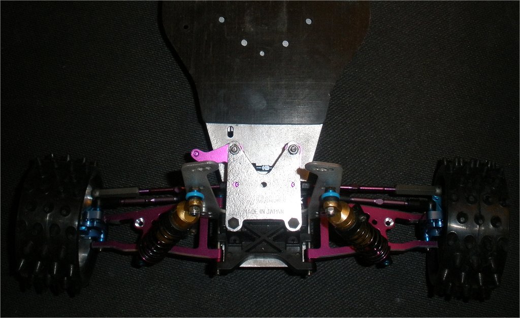

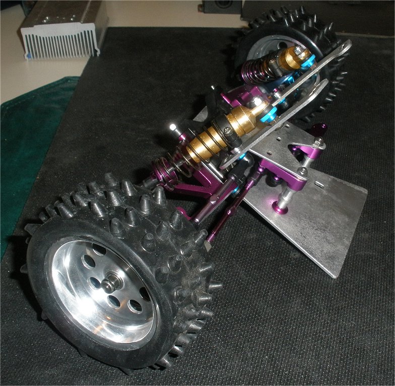

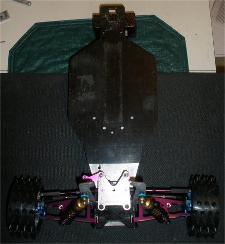

Got the front part of the Outlaw Rampage chassis chopped off. Measured carefully where to chop the middle section of a Losi chassis plate so that the widths of both sections--with about an inch or so of overlap--were even. I chose this Losi plate to be the middle section because it's really beefy, thicker than the graphite Optima Mid chassis donor plate I picked up months ago. I'll chop off the rear end of the Losi plate and splice on the Optima Mid rear end--mainly because I don't have any Losi gearbox stuff or gears. :P I have plenty of Optima/Mid parts.
The middle & rear sections will probably be connected flush, with sections of Optima frame rails bolted on top, connecting the two. In the end, I'll have a wheelbase that's probably 1:8 scale or longer and I'll have the battery mounted longitudinally down the center.
I have no idea what I'm going to do for a body...I might go with a partial body & rollcage theme. This project isn't really intended to be pretty, it'll be a basher.

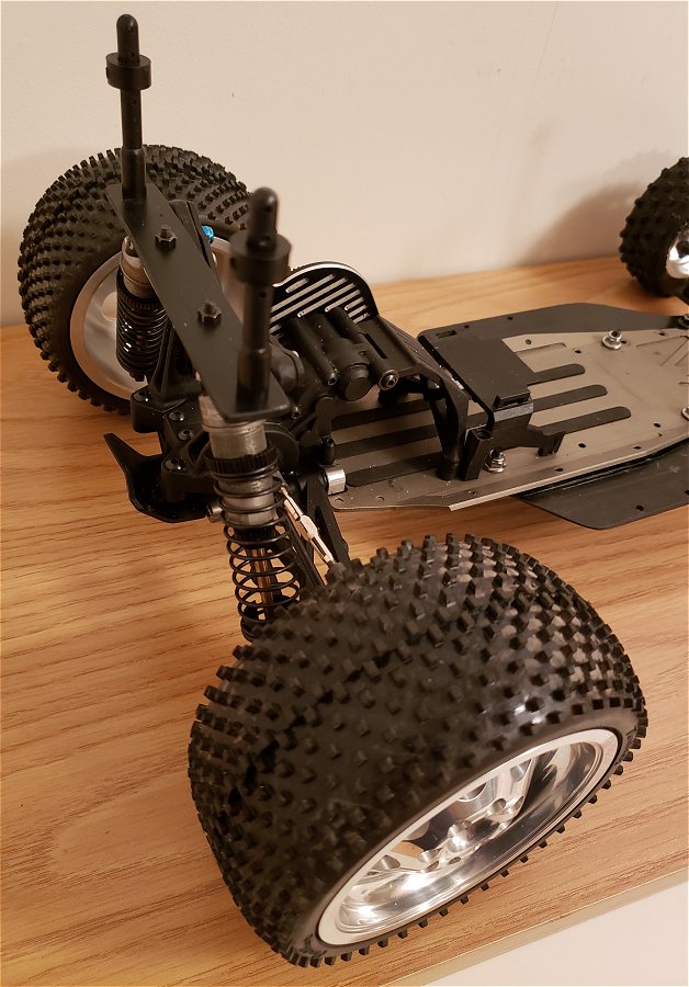

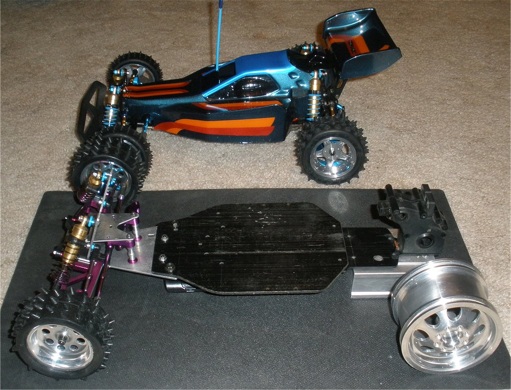

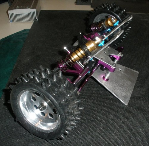

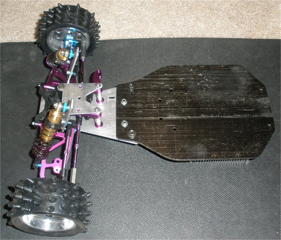

After lots of careful measuring, drilling & cutting, I spliced together the Losi chassis plate, forming the midsection, to the Outlaw Rampage front end. I also cut down the shock towers.

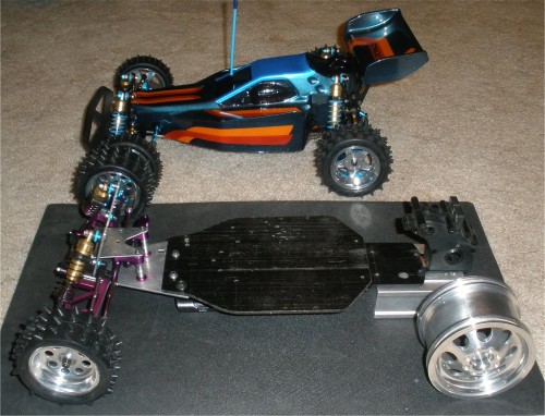

I also cut the graphite Optima Mid plate, which will form the rear section. Here's a mockup showing the overall length of the chassis, with the cool rear wheels (3.2" x 2") that will eventually have more or less the same track width as the fronts. The SWB Optima Mid helps show the size difference.

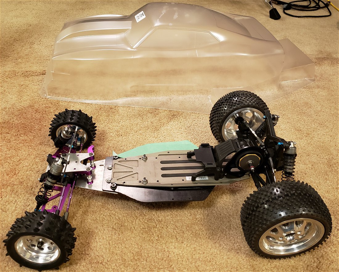

I have most of a Kyosho Rampage nitro front-end, that I chopped the rear-end off. I have a Losi graphite chassis mid-plate, and recently bought a Losi TLR 22 roller that will make up most of the rear half. Thanks go out to klavy69 for answering my request for spare parts, he luckily had a TLR 22 truck chassis that will come in handy for spare parts and a few missing parts I needed. Thanks Todd!

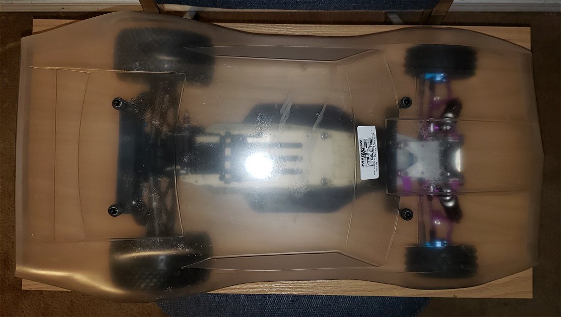

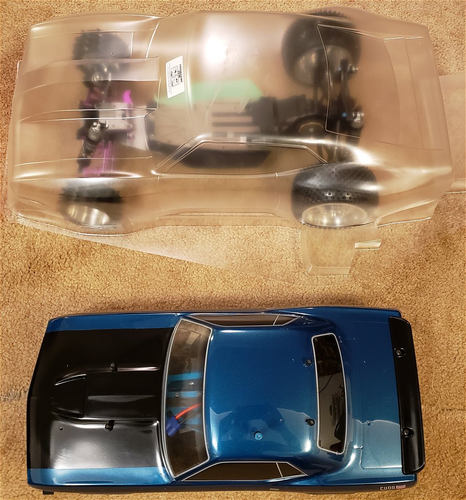

Here's the hybrid, Franken-chassis carefully drilled and assembled to fit the Pro-Line Octane body. The last pic shows a size comparison of this body with a 1:10-scale HPI 'Cuda body...you can see how much bigger it is.

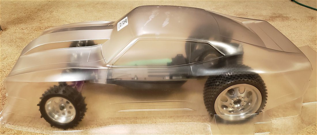

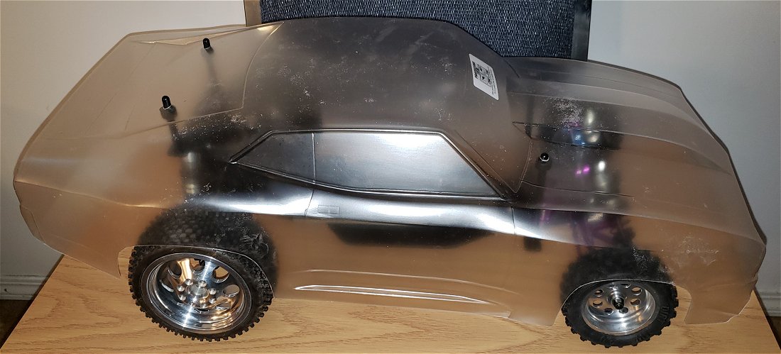

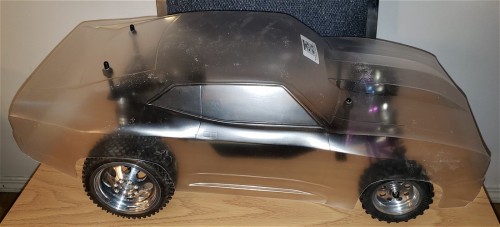

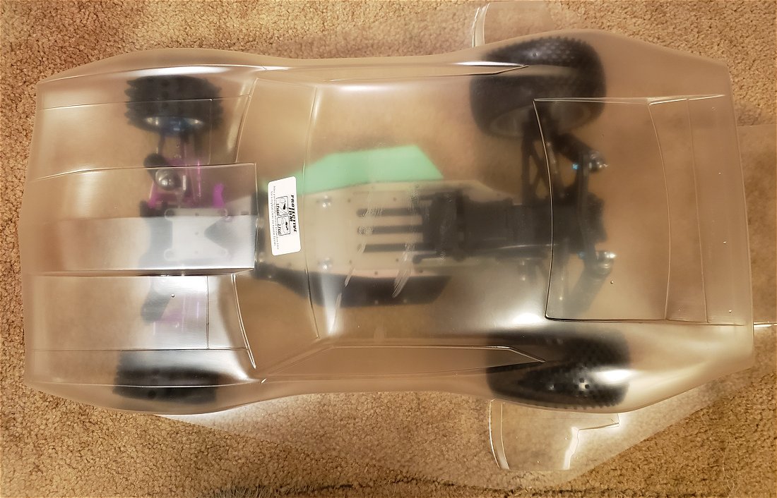

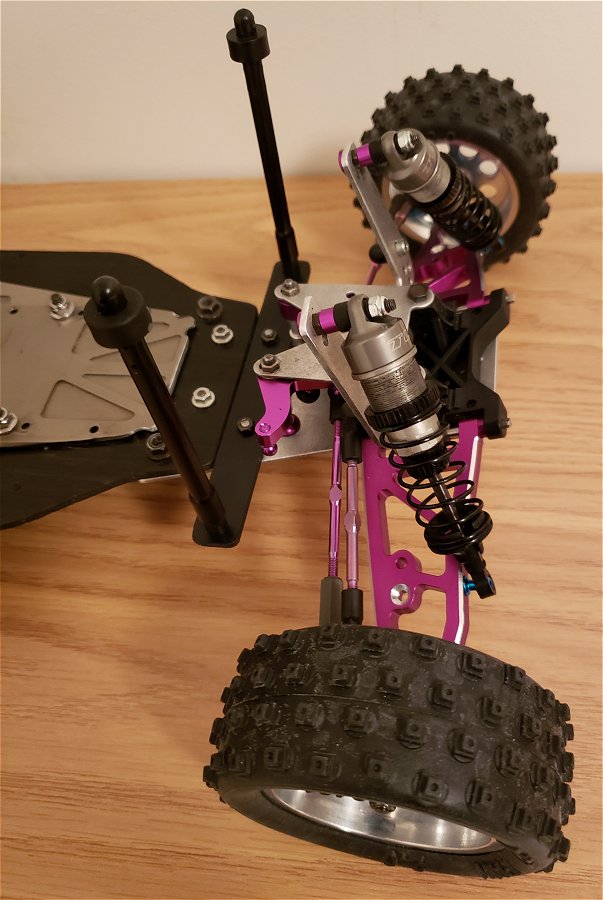

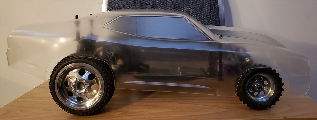

Staying home most of the time due to this virus situation at least means I'm making a lot of progress with my RC projects. For this one, I got the body mounts fabricated.
And a few pics with the body mounted. I probably won't be mounting the wing, because the Octane body is more of a drag racing body and I'm going more in an offroad direction, so the drag wing won't make sense. I also did away with some of the front chin spoiler ground effects, as I want to have a bit more clearance there, again for offroad purposes. I chose this body because it somewhat resembles Mad Max's Falcon XB GT Interceptor, the body is almost ideal for an offroad basher, rather than its intended purpose of making short course trucks look like on-road cars.
The setup needs some tweaking. At the rear, things are near-perfect; with full shock compression, the wheels raise freely inside the wheelwells, with no rubbing. I'm still working on the front, though...I get a little bit of rubbing when the fronts are steered fully left or right with full shock compression. Since the front end has a ton of steering, I'm hoping that reducing the steering servo throw by adjusting the endpoints will take care of it, but the car needs electronics before I get around to those adjustments.

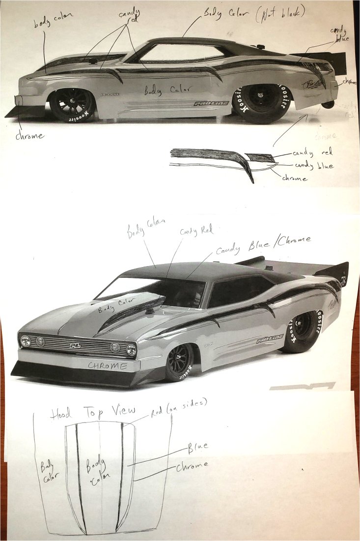

I got some ideas for an eventual paint scheme for this body. As usual, I won't be using most of the stickers and come up with something original instead.
The top stripe will be candy red, broken up with little down-swooping barbs, a bit like barbwire. The bottom stripe will be candy blue edged with chrome, like a knife blade. The stripes might repeat on the sides of the hood scoop to maintain consistency, but I'm not yet decided if I'll paint stripes on the hood. It's a really big scoop and I don't want to overdo the trim colors. The body will be blue pearl backed with black to hopefully give it a midnight metallic blue color.
