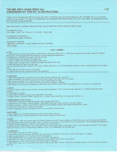

Couldn't find any SP-2 instructions in the scans section so thought I would put some up, additionally I will do the SP-45 belt drive upgrade instruction in a 2nd post.

In case you might have trouble viewing these pages in Photobucket here they are in attachment form:
