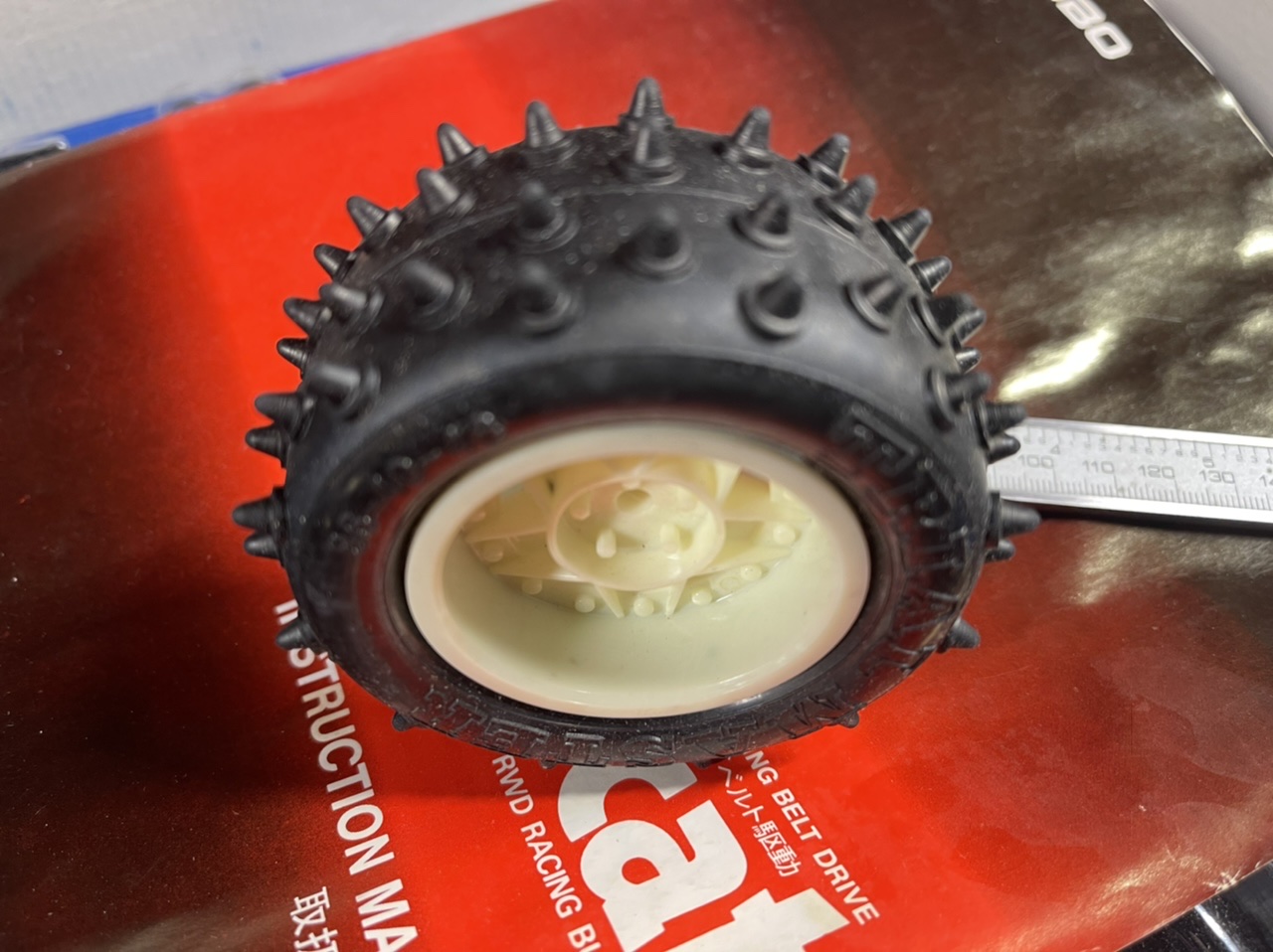

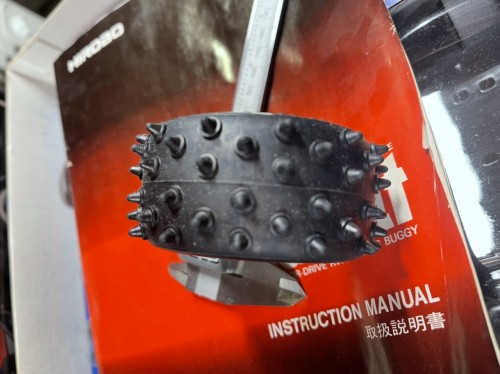

@GoMachV, if your Tomcat tires are not under blister, it would be great if you can take some measurements and pictures of the spikes : The wheels I have are quite depleted by usage, and I have no clue about the tires profile (rear). The Front one seems good, but on the other hand, I can't confirm they are original tires (it's likely, but the only way to confirm is to get pictures of new ones).

Front Trail Masters are easy to measure, and I did them easily. For rear, i measured what was possible to measure on my set of tires, and derived from there and the pictures I found on Internet...

Posts: 12247
Has thanked: 1103 times
Been thanked: 3791 times
Re: Hirobo Bearcat SS - Let's start something else...
Sorry I forgot to look!
Base of the cylinder 6mm diameter approx 1mm tall
Base of cone 4.5mm diameter approx 4mm tall

Thanks, I'm not that far of that. I'll review the cone. It seems the pictures I found were used tires rather than new. I'll replaced them by new ones :-)

I first changed the tires with virtual wear by brand new ones :) (Thanks @GoMachV :) ), and I brought in the shocks.
