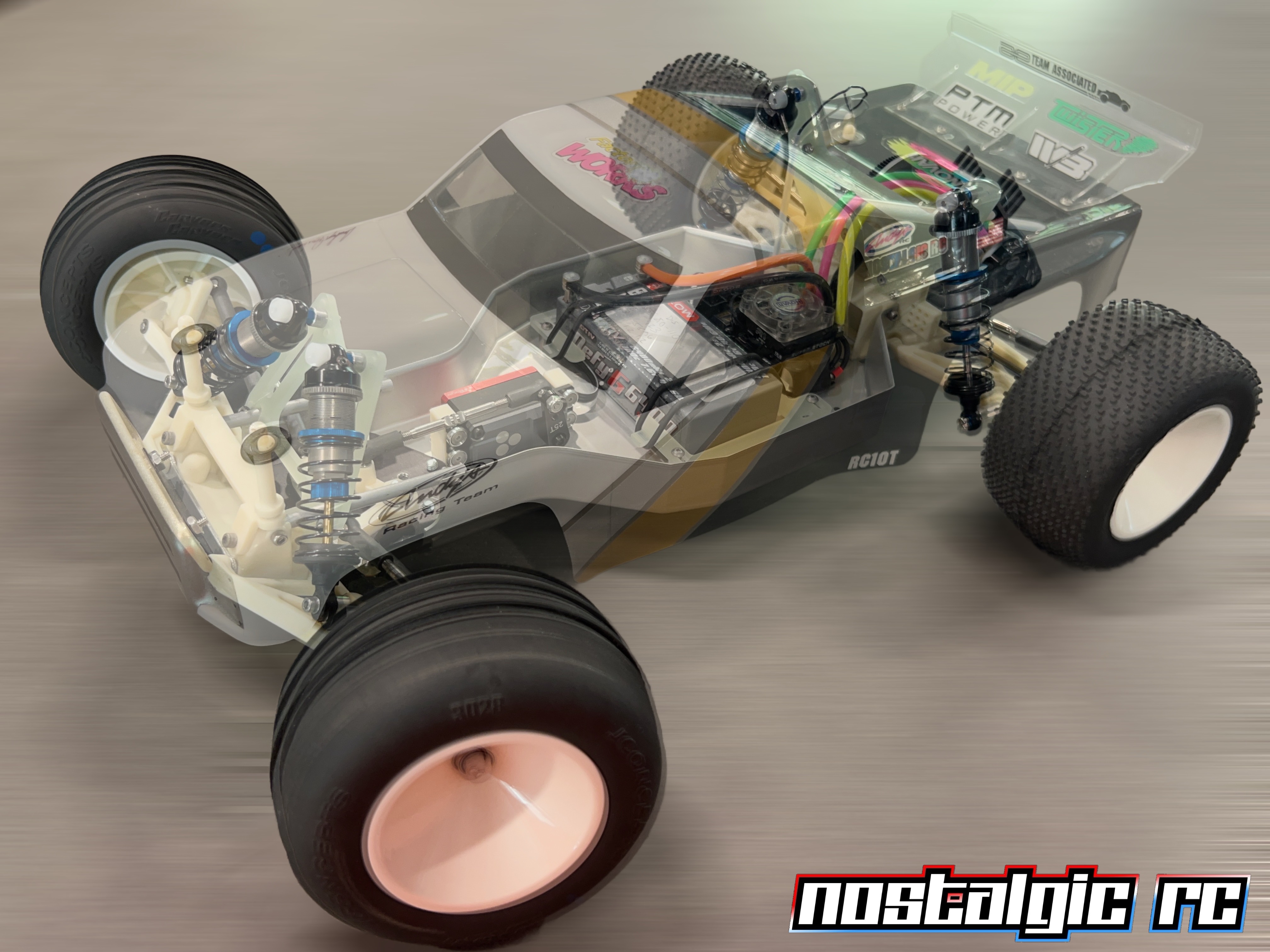

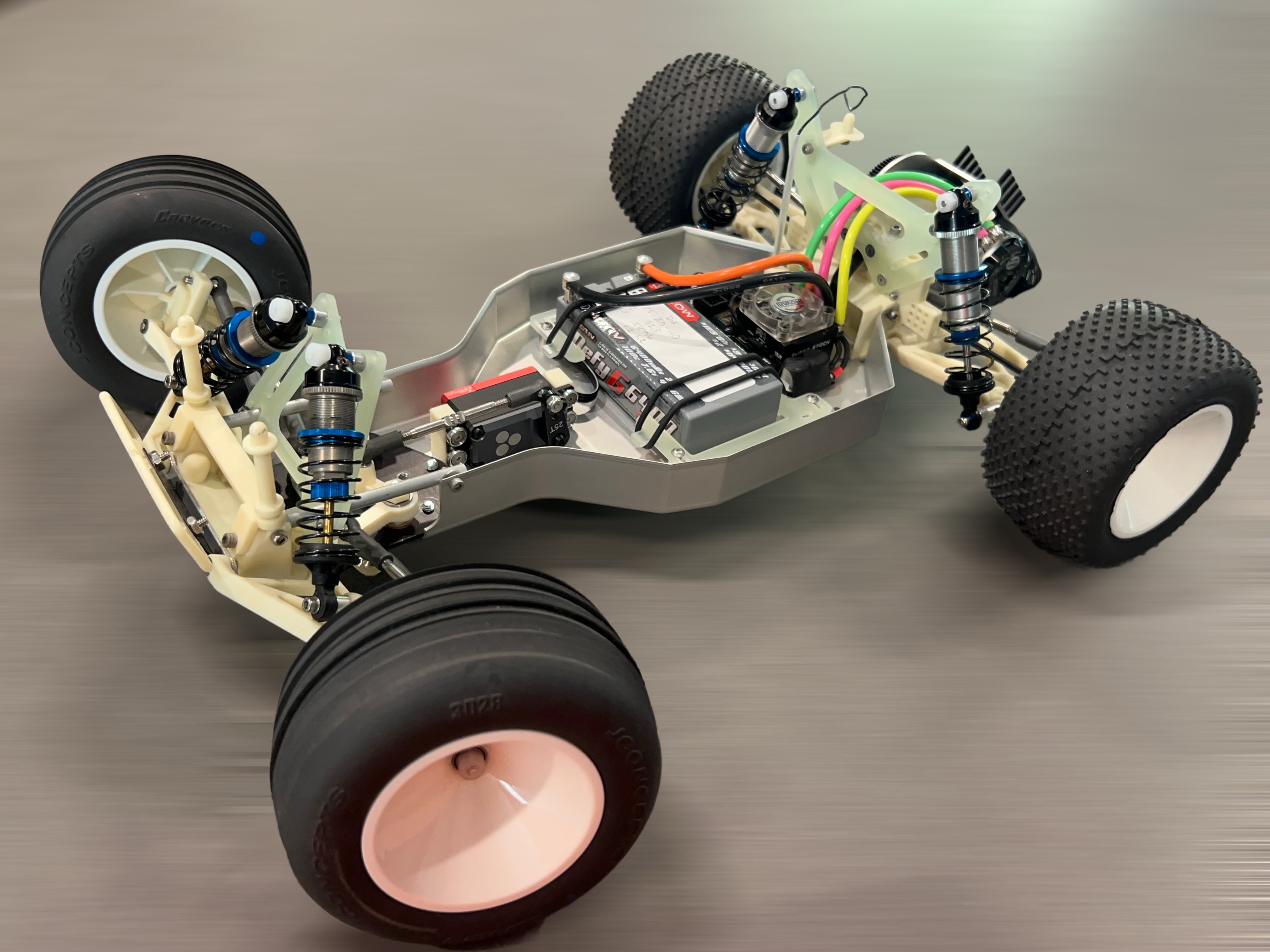

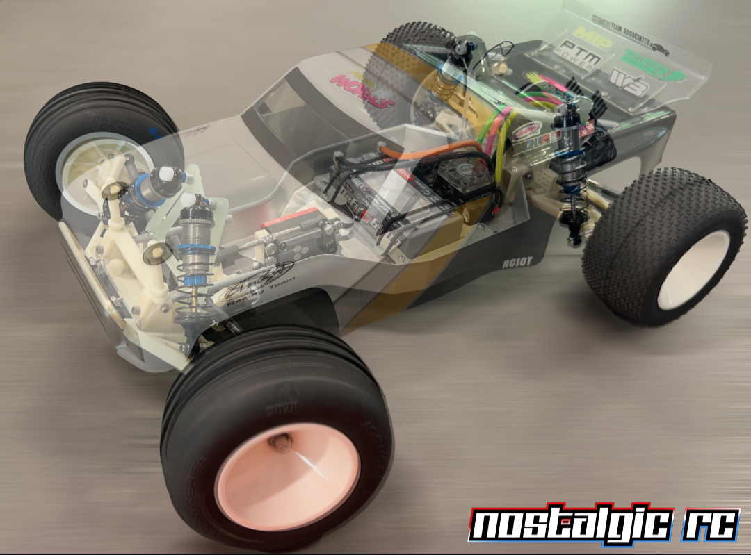

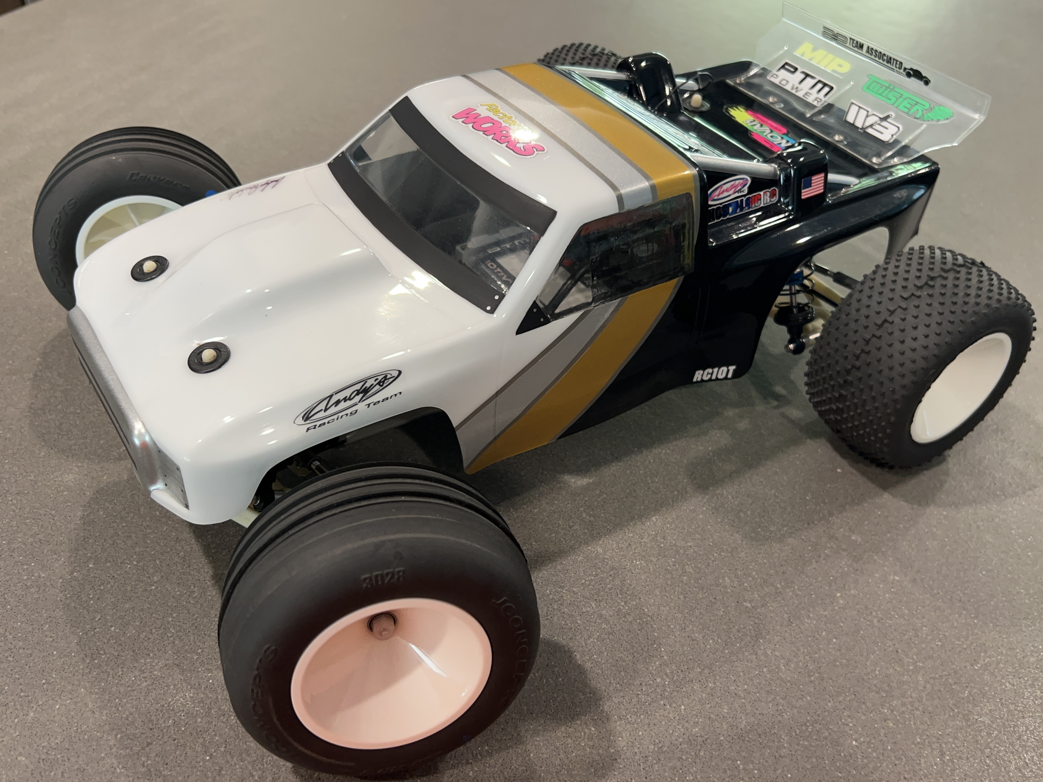

Team Associated RC10T ready for some future Vintage Racing 🤙🏻
Specs:
RC10CC chassis and motor plate
Factory Works shock towers
Andy Jacobson #3033 Truck body
PRO TUNE MOTOR MOTIV RC 13.5/17.5
R1 Wurks Blinky Super Stock ESC
MOTIV RC 6400 battery
Team Tekin Racing T-180 servo
Factory Works A&L steering rack
RC Speed Secrets Ti turnbuckles with B6 hardware
AE T6 shocks internally limited
JConcepts Inc wheels and tires
Wallie Builds custom wiring
Avid Racing Concepts LLC bearings

Holy Invisi-paint! :lol:
Nicely built truck!

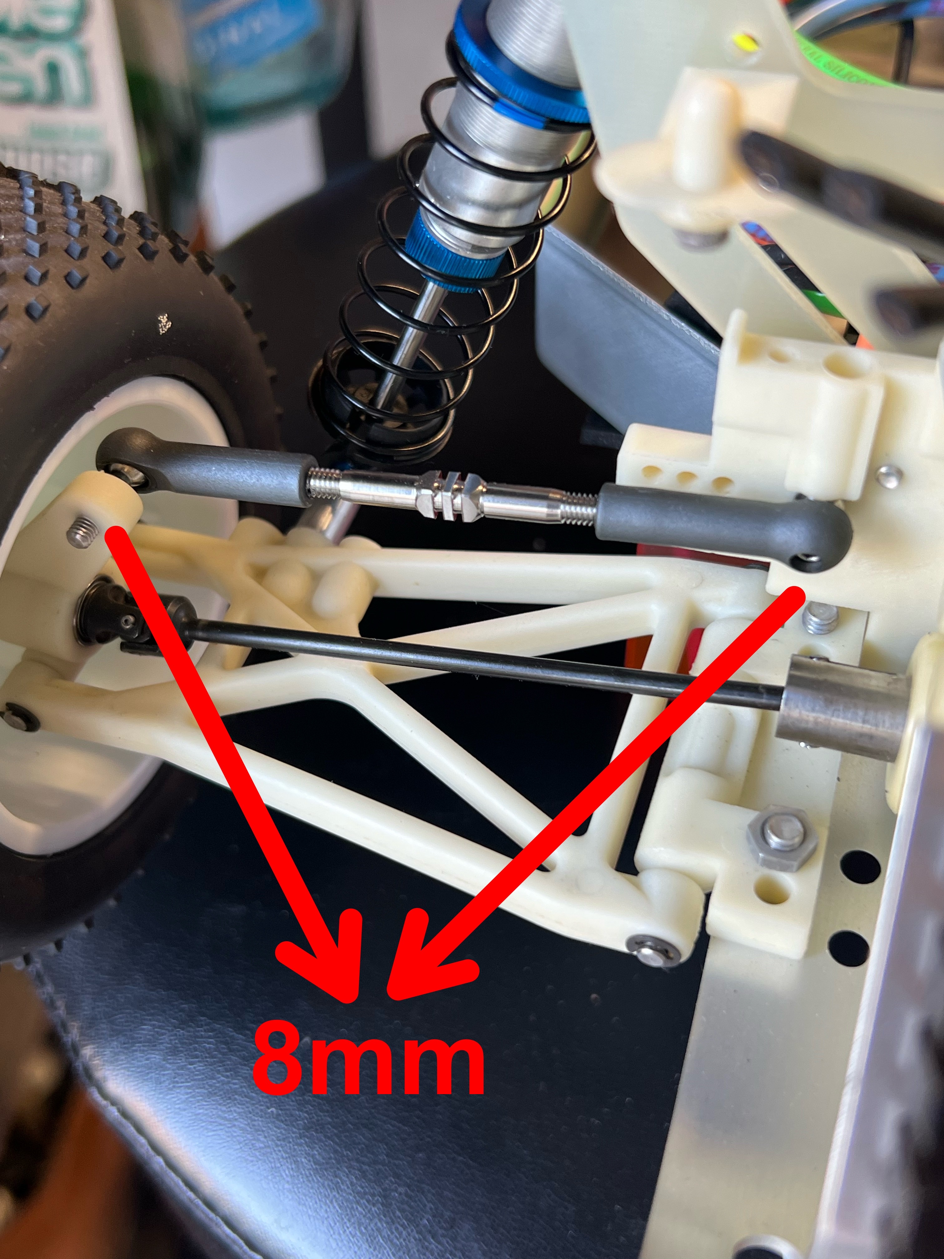

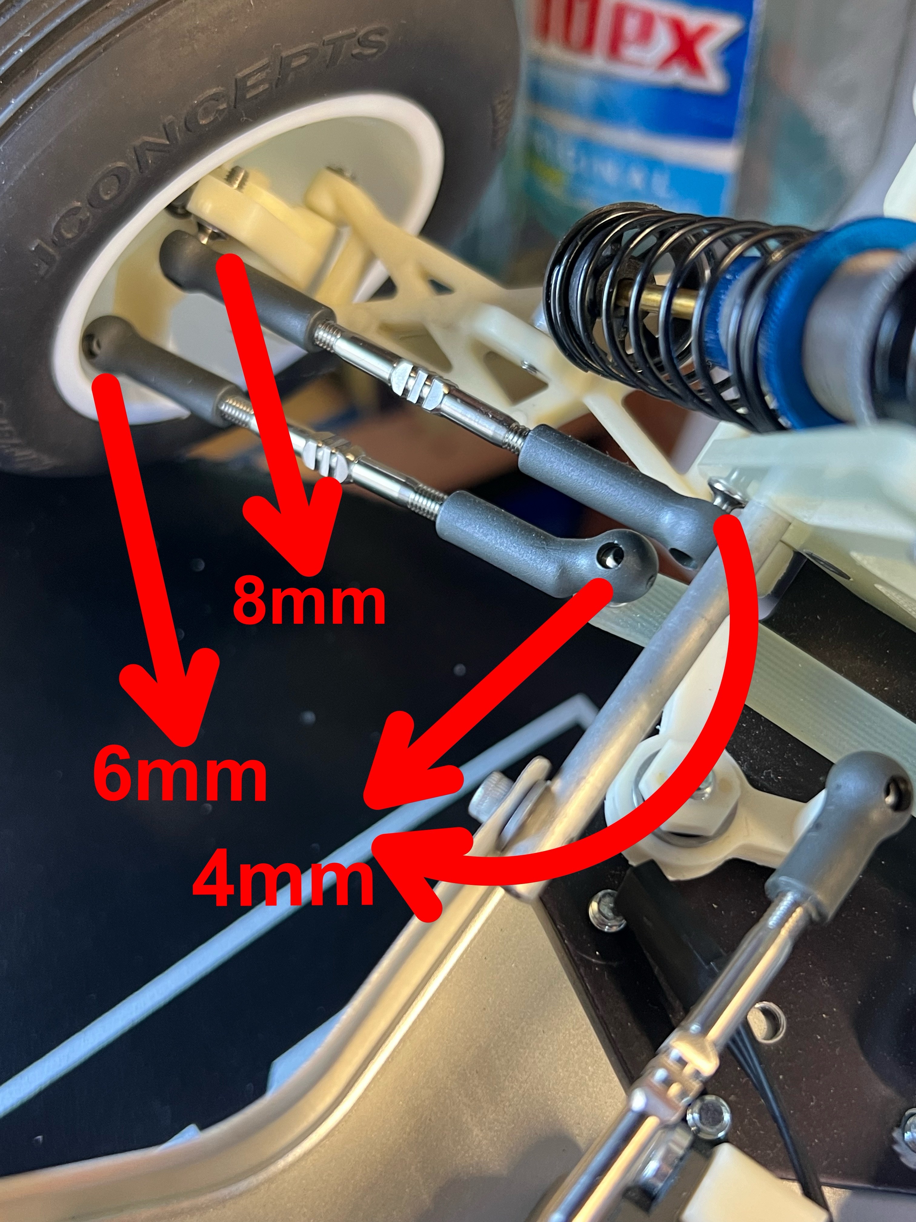

Using the standard B6 (non 3.5mm hd) turnbuckles and cups? All clearance good on them, was wondering about the steering and inner front camber links

Charlie don't surf wrote: Thu Oct 17, 2024 4:05 pm Using the standard B6 (non 3.5mm hd) turnbuckles and cups? All clearance good on them, was wondering about the steering and inner front camber links
3.5mm 48mm turnbuckles
HD ballstud lengths needed in photos
91722 ballcups
91477 M3 plain nuts
Clearance perfect 🤙🏻

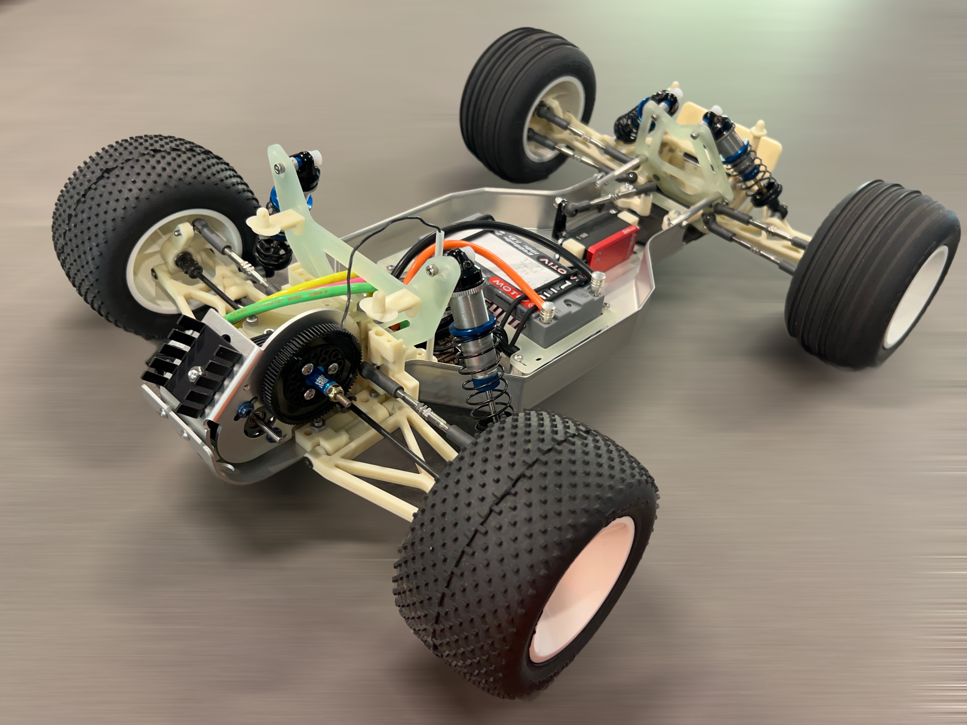

I always wondered what those white late arms looked like on a truck, thanks

RC10th wrote: Thu Oct 17, 2024 5:21 pm I always wondered what those white late arms looked like on a truck, thanks
Oh yeah... didn't even notice the Fan parts lol. Anyone race these yet? Flexibility vs stock etc?

Nice build and great idea using the offset ball cup to keep the steering and camber links away from each other during suspension travel.
I will let you know soon bud, they do feel good though.
