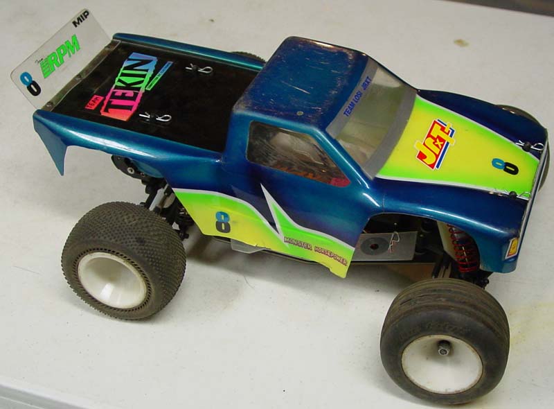

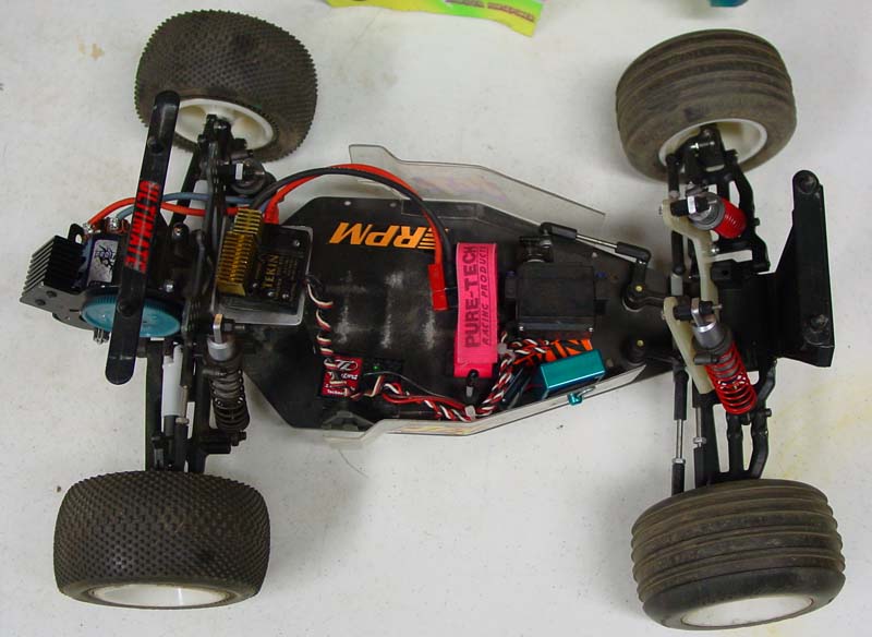

Re: V-Nats Tech Thread....... show your stuff, rc10 or not
CAR: JRX-T
RADIO: Futaba 3pj-super with spektrum module
RECEIVER: Losi DSM with spektrum voltage protector(capacitor)
SERVO: hitec hs625mg
ESC: Tekin ESC 610
MOTOR: Trinity Cobalt 27T
BATTERIES: Energ 4600's:Promatch & team scream 3300's
TRANS: Losi LRM, Stock
GEARS: profiled blue 92t spur 14T pinion
SHOCKS: losi bodies, mip gold shafts, mip blue aluminum cartriges 30 weight oil, RPM 2-stage pistons(blue I think)
SPRINGS:Red front, progressive black rear
TIRES:Proline edge front, jconcepts double-dees rear
WHEELS: AE rc10GT stock front dish wheels, Vintage proline JRX-t rear dish wheels.
BODY: Stock JRX-T

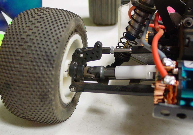

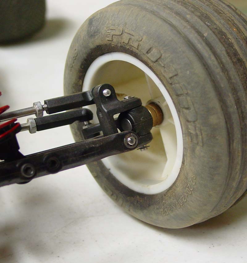

MODS: transponder mounted to dirt shield. Extra-long Proline front axles(meant for their monster truck conversion rims) to allow modern offset wheels to fit with inboard spacers.
UPGRADES: All rpm parts except for rear hub carriers(stock losi parts used to allow for wider selection of wheels), litespeed motor plate, rcps turnbuckles, aluminum esc plate, and Pure-tech battery strap. Many, many crashes/flips and I didn't break a single one of the thin shock clamps.
