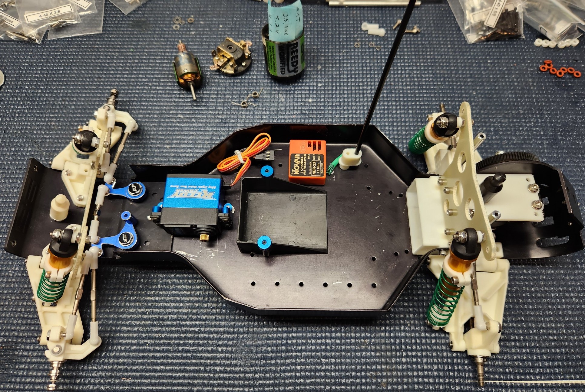

by R6cowboy
Getting a lil' done on the team car here and there. Still have parts trickling in as I get around to them. Currently waiting on a couple Factory Works bits, some ball studs and a servo horn.
Motor in the pic is a Reedy modified Gold Star 14x2, but the armature that came out of it has 22 written on it and the wire is obviously far too thin for a 14 turn motor. I stuck a 14x2 armature out of a brand new Speed Gems Onyx in this motor and it sailed to 35k+ rpm at 7.2V. I have another 14x2 arm that's in a Speed Gems 2 Onyx but it's in rough shape and the comm needs turned bad. I cleaned that one up, put it in and it was weak as hell only turning 22k rpm.
The gold shocks with green springs makes me cringe and can't stand them. Will definitely be switching those out with hard anodized.
