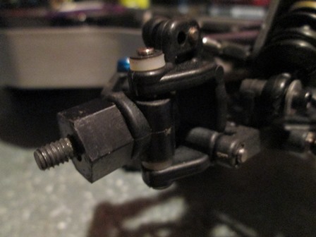

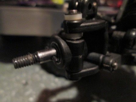

Thanks Lobo. I just rotated the tires around with different adapters. The modified hex adapters are wider than the HPI adapters and did help with clearance. I currently have 20 deg B4 caster blocks with either JC, SC10 or ??? carriers, not sure. The carriers required shims currently placed under the carrier. I am going to move the shims to the top of the carrier and see if I get a little more wiggle room.
knucklebuster
Posts: 822
Joined: Mon Aug 07, 2006 11:05 pm
Location: Florida
Re: DS
Post by knucklebuster »
I moved the shims and effectively eliminated rub on the hinge pin. Moving the axle down brought the hinge pin closer to the diameter of the rim :D
