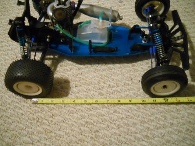

Re: my blue chassis rc10gt
Posted: Thu Jul 02, 2015 11:20 pm
by hugger19
got around to post some pics. sending the body off to andys for a vintage paint job. overall this trucks pretty clean. has rpm rod ends, frt/rear arms and a andys frt bumper.
