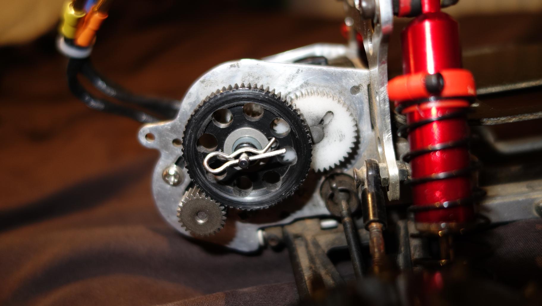

I bought a vintage Optima rolling chassis recently, just really for the fun of fixing up.
Having gone through this thread I'm not entirely sure of its lineage and whether it is actually a Turbo....
It came with no body, a set of new re-re wheels and tyres and fitted with a set of vintage gold, bottom-loaded RC10 shocks. It also has a belt drive, but I have yet to strip it down to inspect.
I have since fitted the re-re shocks and run it down the street with the brushless set-up temporally lashed-on that is showing in a couple of the photos. It went very well.
From this thread I can see that it has the taller shock mounts, the ribbed suspension arms, the alloy under-tray and appears to be ball-raced throughout as per the Turbo. However the steering servo has the upwards arm and straight rod and the drive gears appear to be like nothing described in this thread or the manuals I can find (my motor pinion BTW).
Can anybody shed some light?

Aftermarket or homemade delrin countergear.
That's pretty much required with a brushless, the original gears would self-destruct with hot modifieds back in the day...

Martco78 wrote:From this thread I can see that it has the taller shock mounts, the ribbed suspension arms, the alloy under-tray and appears to be ball-raced throughout as per the Turbo. However the steering servo has the upwards arm and straight rod and the drive gears appear to be like nothing described in this thread or the manuals I can find (my motor pinion BTW).
A lot of people with original Optimas upgraded parts on their cars with Turbo Optima parts, like the shock towers, stronger webbed control arms, stabilizers, Gold shocks and wheels & tires. But what makes me think your car might've originally been a Turbo Optima was the aluminum belly skid-plate...it's pretty uncommon to see upgraded Optimas with that skid-plate added. I've seen lots and lots of Optimas that looked almost like Turbo Optimas but had no skid-plate. So, my guess is that your car was originally a Turbo. Another way to tell is to see if your original counter gear has a spring or multiple spring-washer assembly held down with a brass nut; this special "limiter gear" only came on the Turbo Optima & Salute; the regular Optima/Javelin had a solid counter gear. As Evo-Revo said, the one on your car is aftermarket.

Yes, the Z-rod was not a good at all except it allowed to have faster steering = longer servo arm. But since one of the problems in (Turbo) Optima's steering was that You had use only servo/doubleside tape to install servo to somehow grease plastic "(90) Servo mount", servo was moving while steer. Because of this people tried to use 2 zip ties to secure servo mounting. In Turbo Optima the Z-rods ball ends were in different levels in 3D space and this caused even more all kind of twists and forces to steering components. Going back to Optima up-rod did make the steering a bit more effective etc. .
I believe that Your Optima was originally Optima that was upgraded almost to Turbo Optima. Lower arms did break quite easily on Optima and the original owner just bought Turbo Optima arms to his car. Optima's lower chain guide did break easily and to avoid this to happen again, he also bought "(143) Chassis Guard" to avoid breaking lower chain guide again. Are there any scratches between the chassis guard and the lower chain guide? The Chassis Guard was really light and was acting as a "chassis long" skid plate. Gears seems to be just hot ups, similar can be seen e.g. here: http://www.rc10talk.com/viewtopic.php?f=79&t=22021 , see Blandin's "Ultima" ;). RC10 shocks to Optima and to other cars were quite common mod BITD if You had RC10 too.
