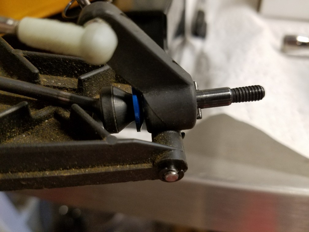

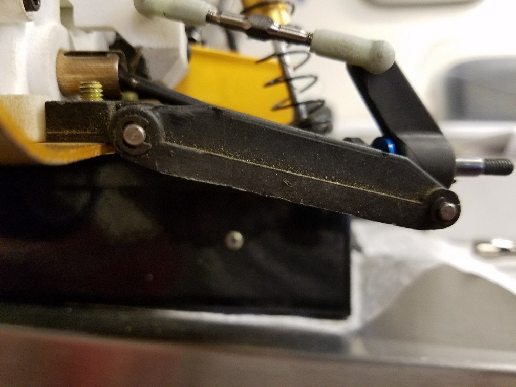

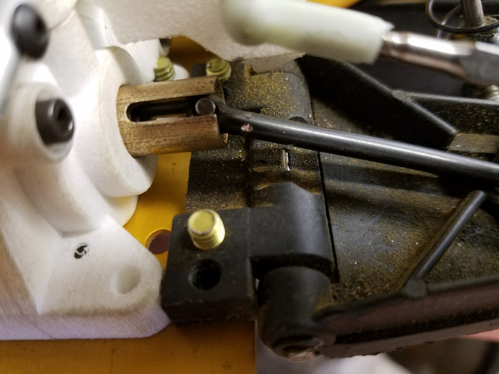

Here's my 10M, with the Worlds CVA kit, like I said, blue thing inside, and one or two of the 3 washers
The drive pin in the slot at full droop and proper camber, albeit barley
And a reasonable amount of droop

the b44 rear center bones that are in the link jwscap posted are the easy fix for the problem.
