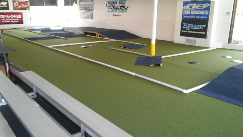

Car did very well today, no failures, the RC10 rere wheels are a win. The track configuration has a very tricky triple section that was beating the car up and it hung in just fine. I couldn't successfully take it as a single double combo so it was three separate jumps. It was actually more stable than my rere world's car which I have worked with a few times now.

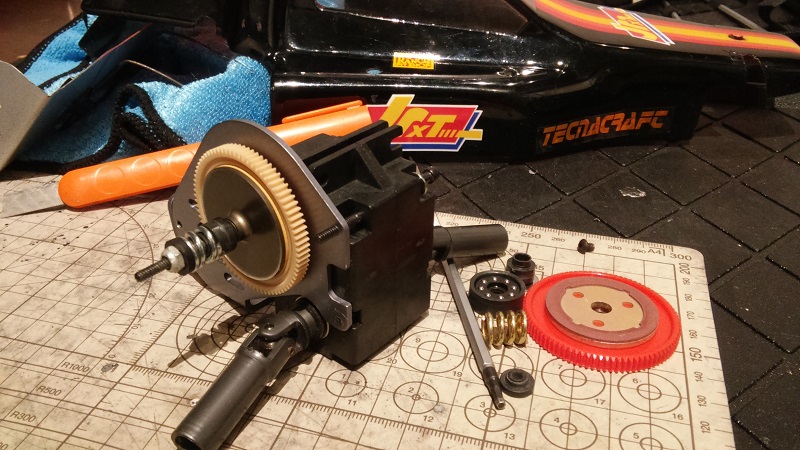

Sometimes things get lost in the past here. Here is a XXX slipper style spur with 78T put on a LRM tranny. It slips right on if you have the slipper shaft used on JRXpro SE. You can see old single slipper disc laying in pile next to it. This makes modern spurs and and slipper pads easy to come by. Again not sure I even need the slipper. I guess car does have a lot of bite and will pull wheelies if I am crazy on throttle so it might help a bit coming out of turns as I could use more front traction always on the turf.
Far as I know you can even run newer 22 spur gear and slipper pad style on this.

It's a smaller track which suits me better. Also removes all out speed as the deciding factor though I need to find a bit more speed when comparing buddies B6M also running a 17.5T. Going to play with gearing a bit more and setting on ESC.

Went back today, I ended up with a 30T pinion and the 78T spur. It was just about perfect, car was performing well. I had track to myself and was able to turn lap times consistently that would be bottom B main material. I am actually shocked how well the 5 link is doing on the turf. Way better than my World's Rc10 has done so far at least.
