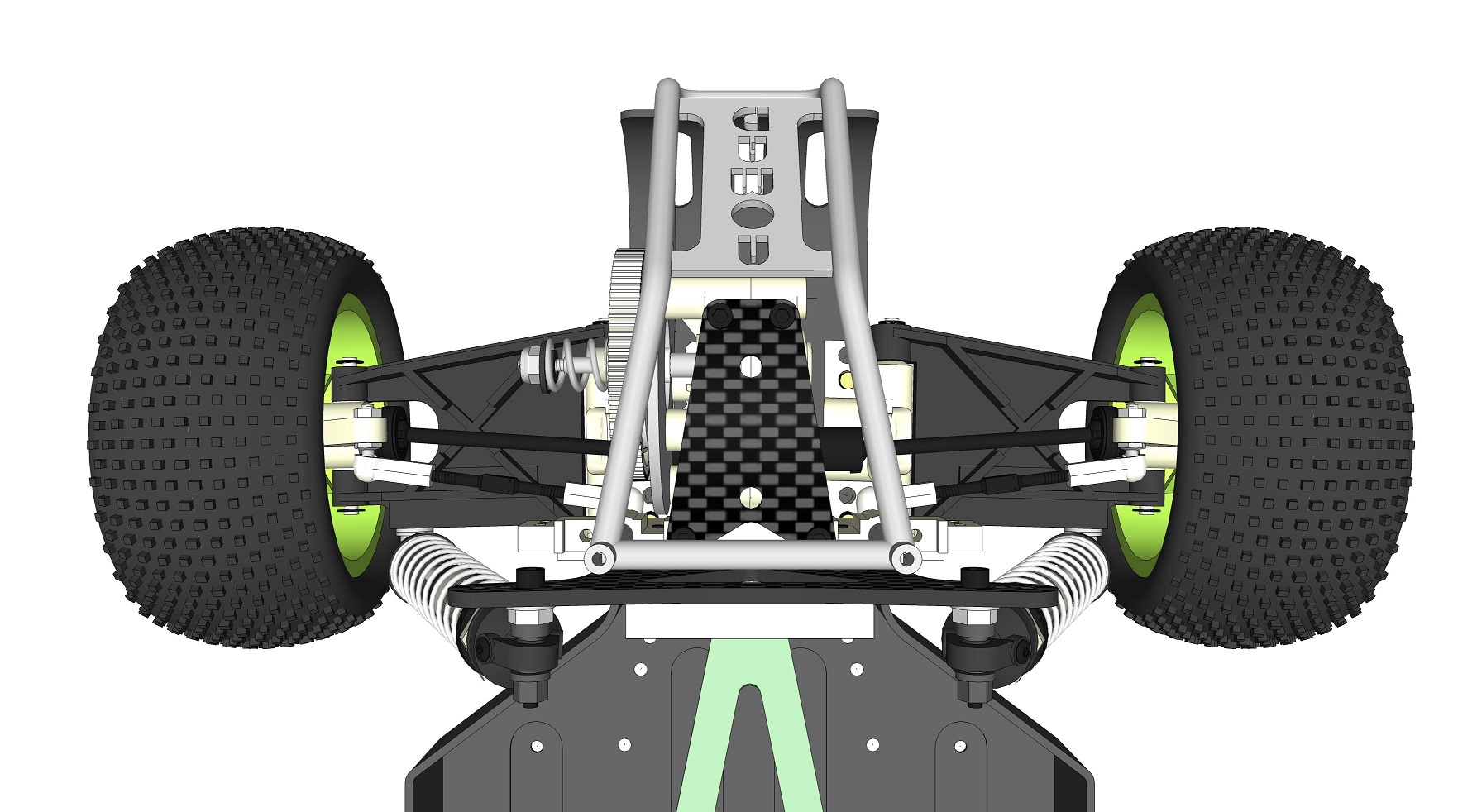

NomadRacer wrote: Tue Aug 14, 2018 10:10 am Bending my life away :mrgreen:
I've come up with an idea for the rear, transmission guard tubes but not sure if it's going to stay, may re-do it, if so, need more tubing. :?
Hey Nomad.... Been giving this some thought. How about something like this?
Attached with button head screws from the inside
Those close bends at the back might be a real challenge.
Anyway, it's just a thought. :D

That's a good idea. I'll see if I can make those bends. It would look a lot better than what I have done!

by XLR8
I have them spaced 1" apart but they could go wider if necessary.
I'm a bit uncertain on those two short cross-members. By chance, do you have some smaller tubing - maybe 1/8" perhaps? They seemed to be a little too thick - or maybe they should be moved or just eliminated completely. I dunno. Anyway, whatever you do, it will look awesome.

Here's what they would look like at 1/8"
Re: RC10 Factory Works C2 "Tuber" Build
Posted: Fri Aug 17, 2018 8:46 pm
by NomadRacer
I do have 1/8". It seems to me, kinda strange looking with smaller cross members. Maybe it's me though, being on the mobile, away from home for the weekend.
I think 1" is close to the measurement between the two tubes, maybe plus 1/4" or so.

I think you're right, 1/8" is too small.

Bend up both sides individually tig them together. If you want more strength, then sleeve the inside of the joint.

jeepnut24 wrote: Fri Aug 17, 2018 11:44 pm Bend up both sides individually tig them together. If you want more strength, then sleeve the inside of the joint.
Excellent idea! Of course, the trick then would be to remove the weld so it looks like one piece. I'd bet Nomad could handle that with no problem. :D

just for giggles....

That's how they sometimes handle it on 1:1 scale. :) Bevel the ends for a stronger joint and deeper weld.
