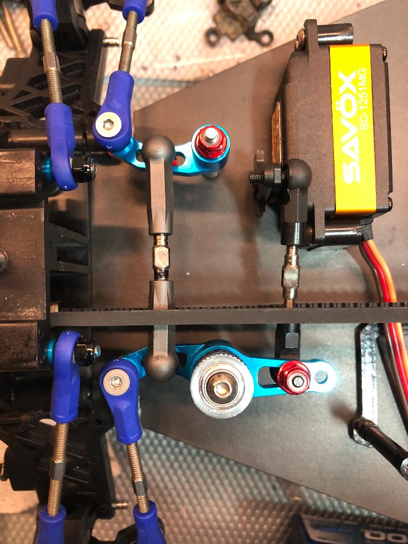

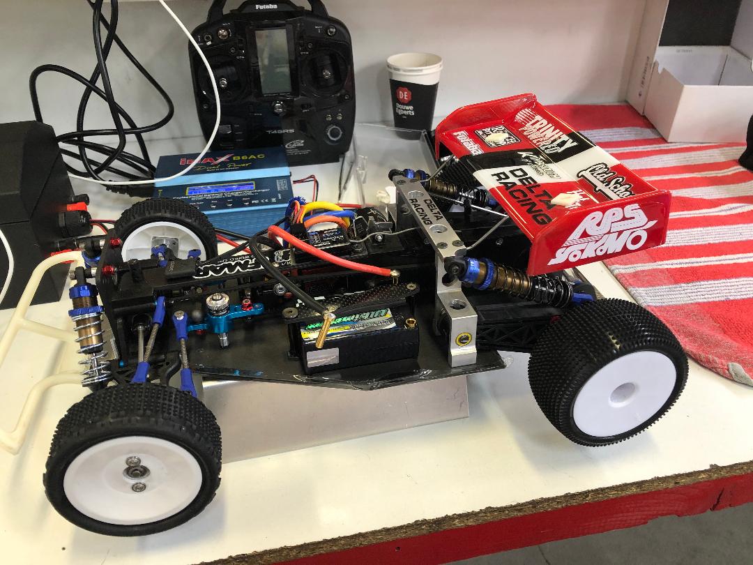

Have made some mockup for the layout of servo, ESC and Li-Po. As you see I have to go with the “super shorty”, I had hoped to go with the shorty. So, if I had gone for the SE chassis style, I probably would have had more space for a short. I might have to make a new chassis for the SE-style after the race.

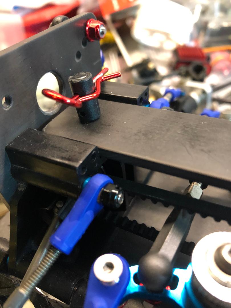

I made my own body post up front. I used a 20mm long M4 set screw and the top of body post.

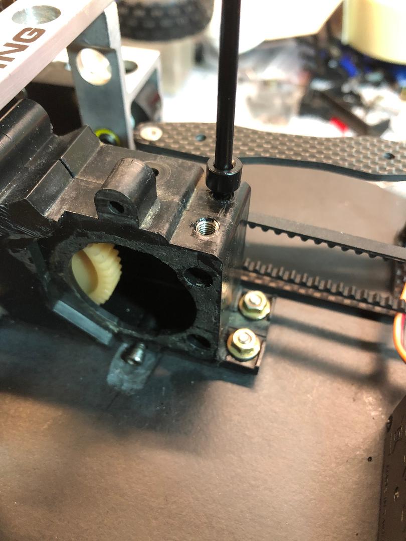

Both threads in the gearbox for the upper deck was ruined, so I needed to fix that. I think tis is the result of mixing M4 and 6-40 screws by the previous owners. I got a Helicoil repair kit for M4 at hardware store. I never used Helicoil on plastic, and I don’t know if it will work in the long run, time will tell.

The low profile Savöx servo is in place.

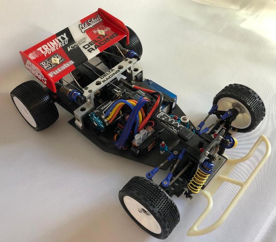

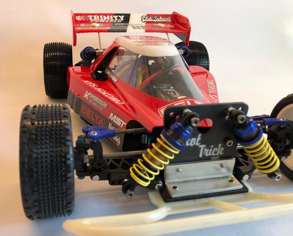

The old Pro-Line bumper is mounted together with a reinforcement for the front shock tower that my brother folded for me. I also did some threading, M3 for the shock tower and M4 for the bumper. I think this will improve the sturdiness of the bulkhead in case of a crash.
I also mounted a belt tensioner.

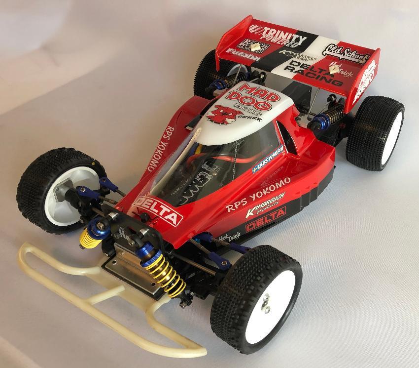

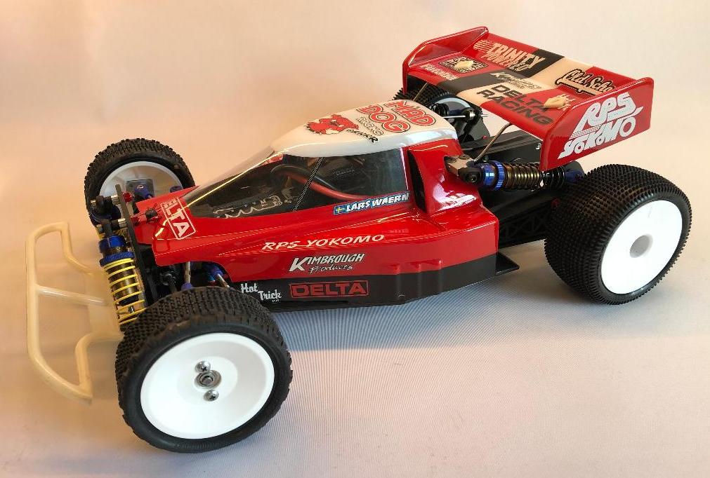

I had time to rattle paint the body and wing, and after a few sticker it’s look fairly good for racing. And now you can see why I call this project “Mad Dog”. The body is cut down about 10mm, and that was a bit too much, so I had to cut a small hole for the motor.

The weakness in the front bulkhead is shearing off the lower suspension mount points , that's what I've seen on a genuine and 3d printed examples , I've been planning on a modern style brace for the bottom arm pivot pins on my cars , you have to replace the stock pins with something a little longer but I'm thinking its probably worth it , might be worth a stab on this one , those bulkheads are getting harder to find .

I was planing to do just that, but my brother misunderstood me (or I wasn't clear enough :roll: ) regarding the length of angle he folded. Hopefully the bumper will protect the bulkhead until I hav time to fix it. I will make a few updates after the race, I want to replace the Kyosho stuff with original Yokomo parts even if most are period correct. :wink:

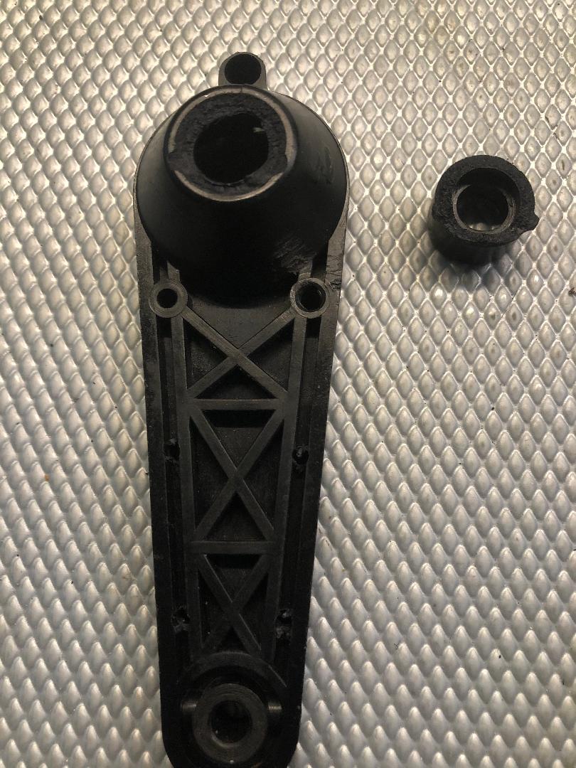

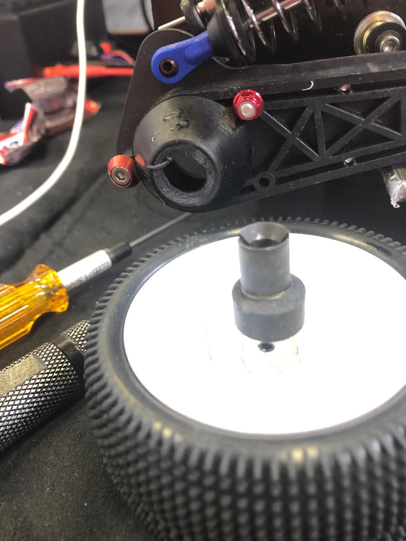

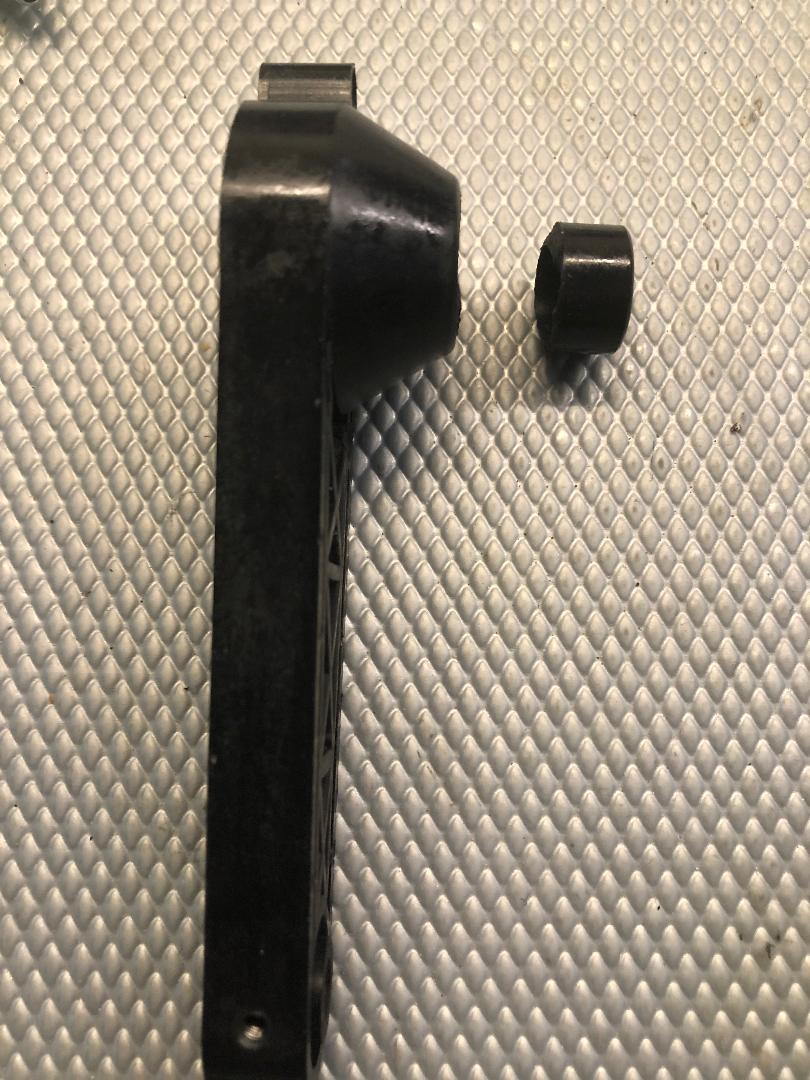

The race debut is done, and it lasted less then a lap on the open practice on Friday… The right rear arm snapped after a dodgy landing after a low speed jump.
I had a spare one, so replaced it. In the mean time I was practicing with my vintage Optima/Scorpion based 2WD. When I was ready replacing the arm, I decided not to run my 4WD “Mad Dog”. But when Sunday 4WD day come, the urge to run it got the best of me… So, I decided to race and only to wheel it over all the jumps. It felt the right ting to do sins I had traveled 750 miles (1200km) to the race. Actually, I didn’t qualify last, I had one guy behind me.

RE the broken rear arm , the plastic they are made of responds really well to CA , I broke a front knuckle and temporarily glued it and I swear it feels as strong as before ! I do have a design for reinforced rear arms as I had exactly that same brake , they look different in the conical section ,PM me if you want to try them .
Mine all nose dive on jumps and they tend to dig the nose into the track on landing , I've found that I'm cleaner if I keep the power on and nose up when jumping , doesn't look good but it works for me .

CA might work fine as the last way out. Yes, it’s nose heavy, so you have to give gas just before the front wheels leaving the jump as you say. Sins I have mixed 32p and 0.8 module gears in the gearbox it’s rely loud. And I lost the retainer for the Delta slipper, some one found it… But I was never able to find out who that was. I have another Delta slipper, so my friend will reproduce a new retainer. Other than that it was a good experience to drive. 8)
