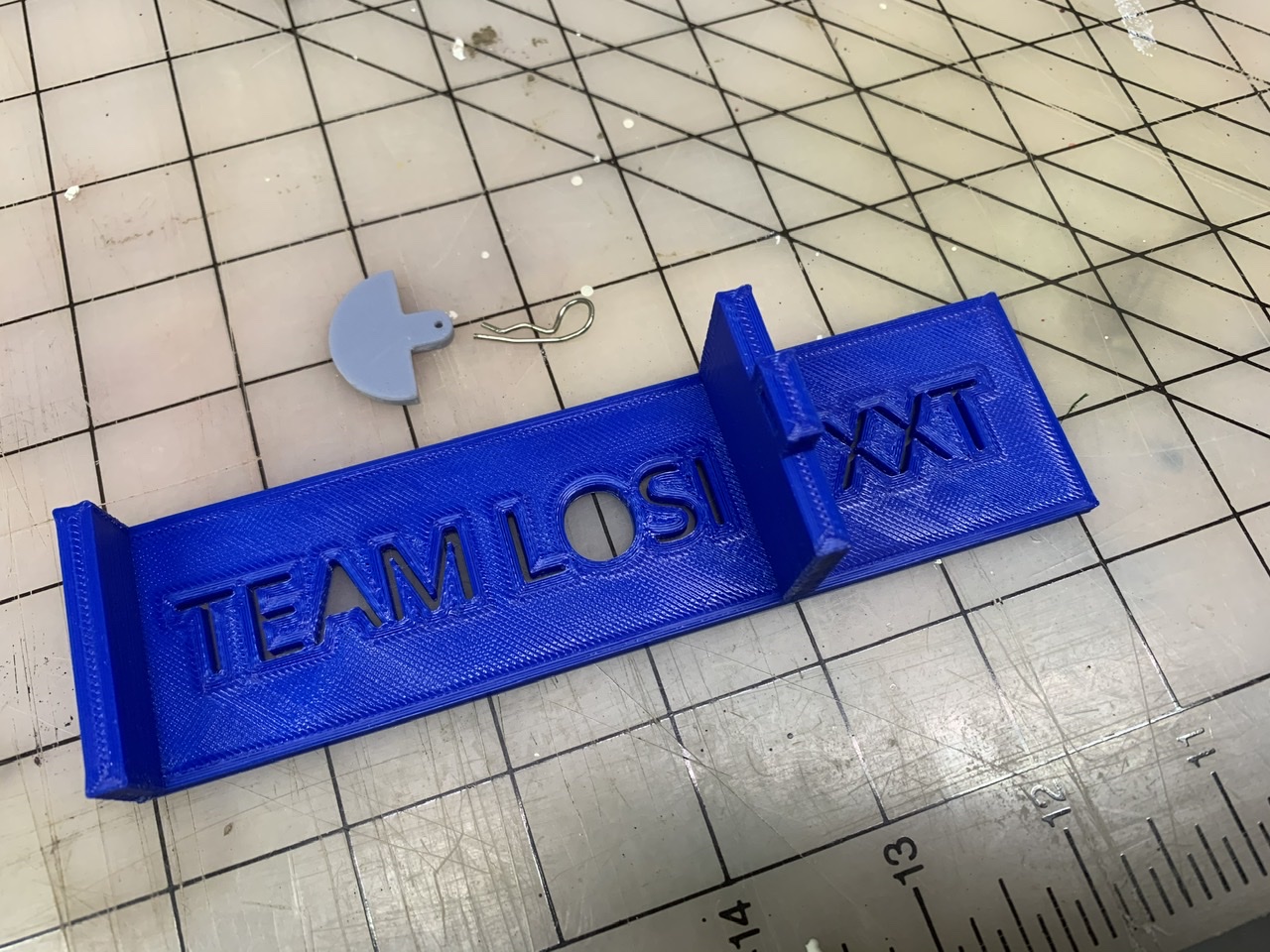

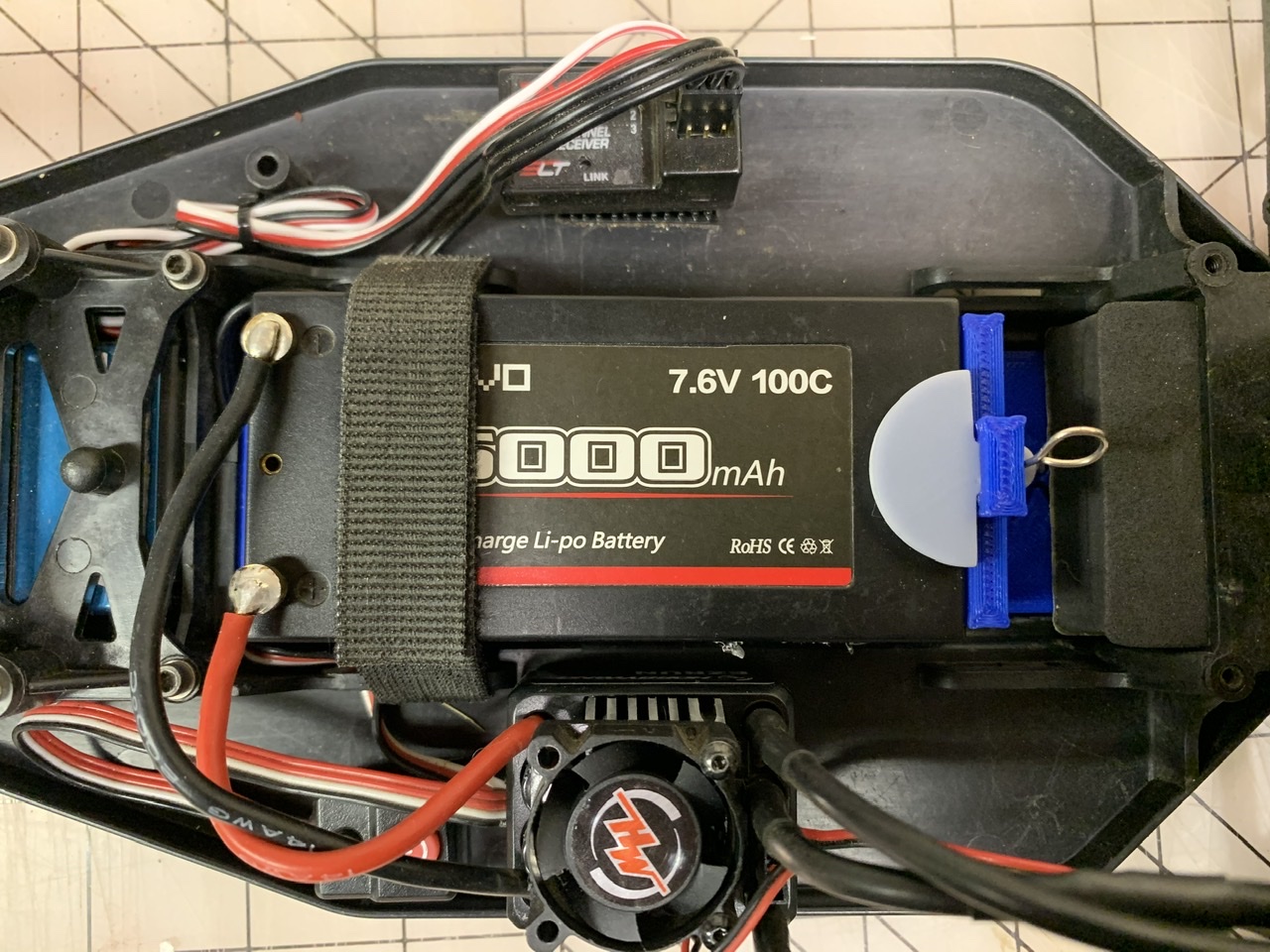

Designed and printed a battery holder for my shorty LiPo.
