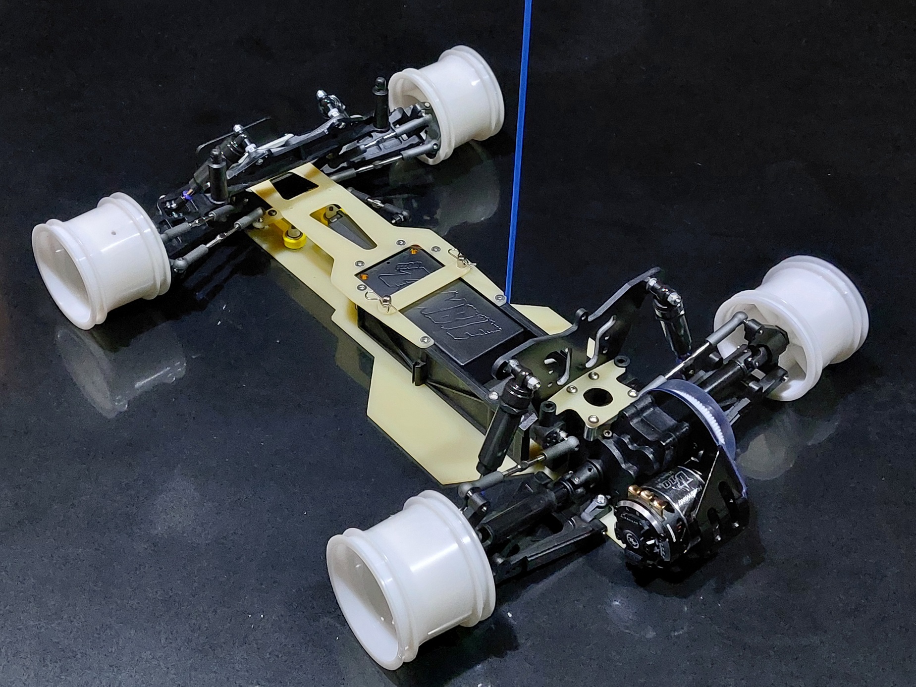

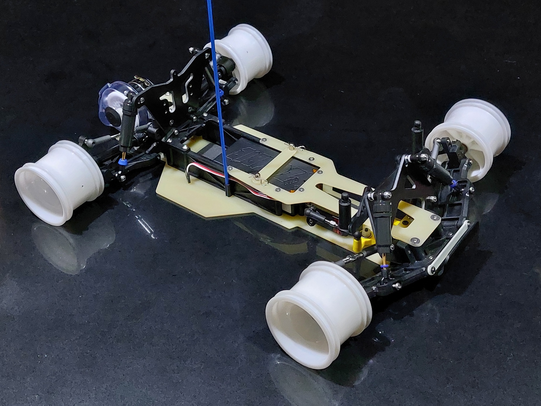

Many many thanks to Chris (1300GT) for machining up a set of aluminum axles for me. They fit much better than the crappy steel ones and shave off 7 grams.
Some pretty high end electronics going into it..... XR10 Pro 17.5 combo with Zombie 6000 Shorty 140c/280c and extra large capacitor. I'm also happy to see "Wet Noodle" is still a thing and Deans is still going, too bad they don't make their solder any more as it was hands down the best
After an epic long delay in shipping I finally have the remaining parts to finish it. It's starting to look pretty good for a Traxxas.

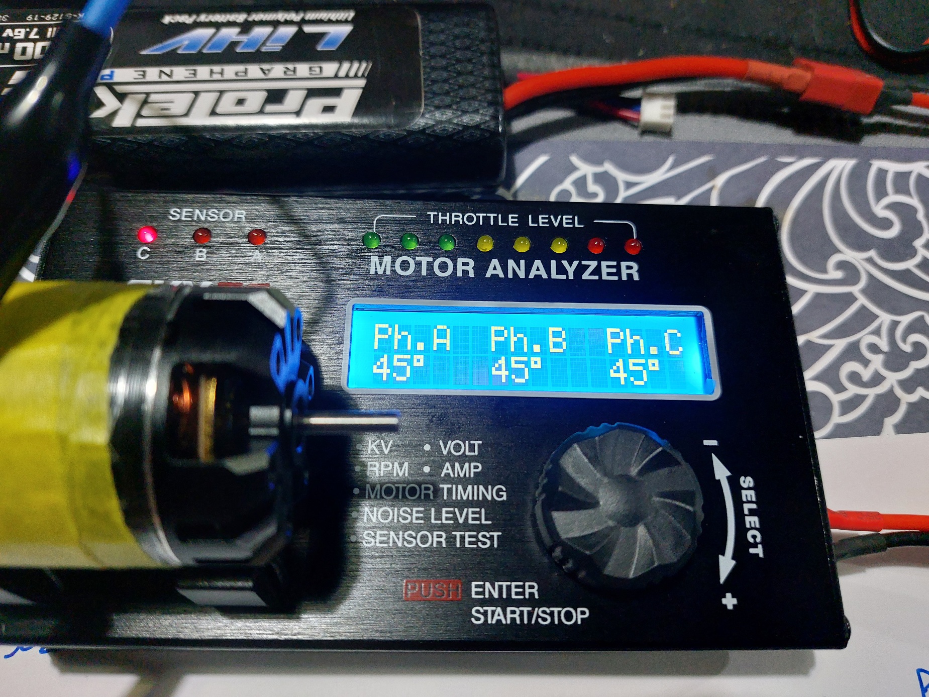

Phase timing on this motor is excellent!!

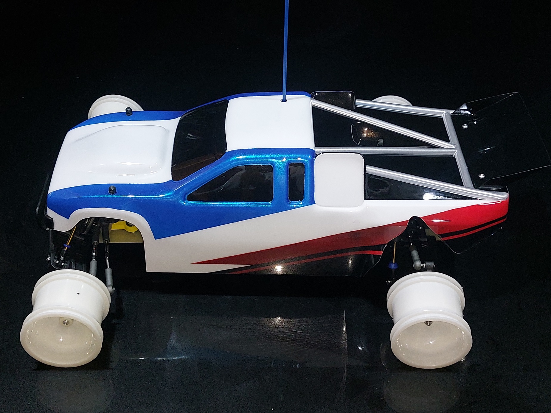

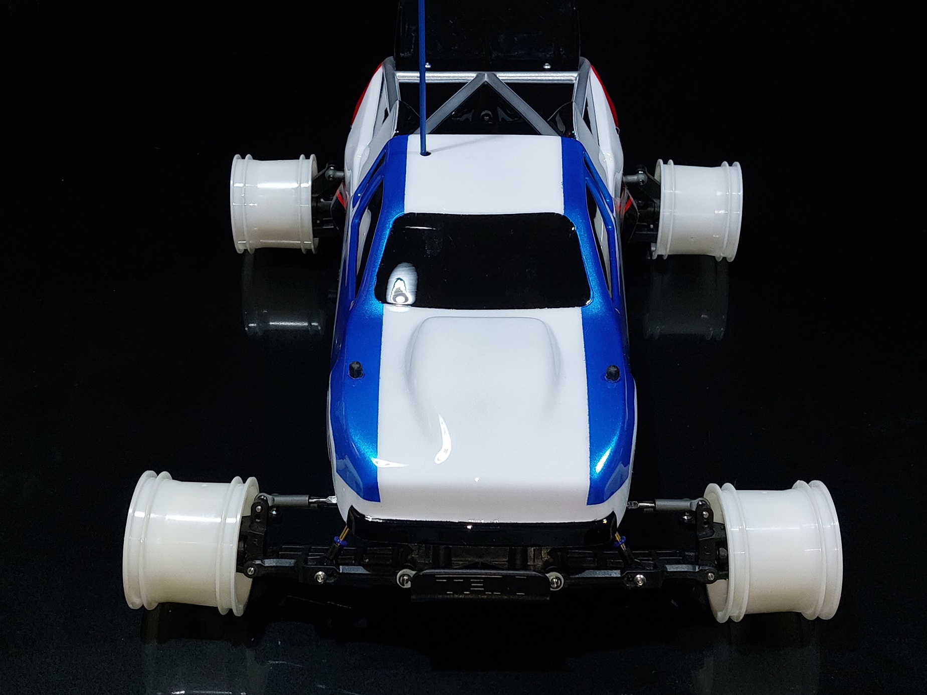

I hate painting bodies as I suck at painting, it's good from far but far from good. I don't know if my Tamiya tape was old or what but I suffered a lot from edge bleed, the tape felt a little different then I remembered it. Maybe it's time to try a different tape. I should learn to use liquid mask but I don't have a steady enough hand.
At least it's presentable and will look great going around the track. I hate the reproduction MCI grill decal but it is what it is, better than nothing.
I still can't believe I'm racing a Traxxas

It looks pretty good from the other side of the world. I'm sure a few well placed stickers will take care of any unsatisfactory spots.
Re: Trying to make a Tra**as SRT fast !
Posted: Sun Oct 29, 2023 9:35 am
by TRX-1-3
Dude, that body is just fine. Won't notice it a bit from the driver's stand and Tra**as pooped the bed AFTER the SRT. So you're good there as well.
