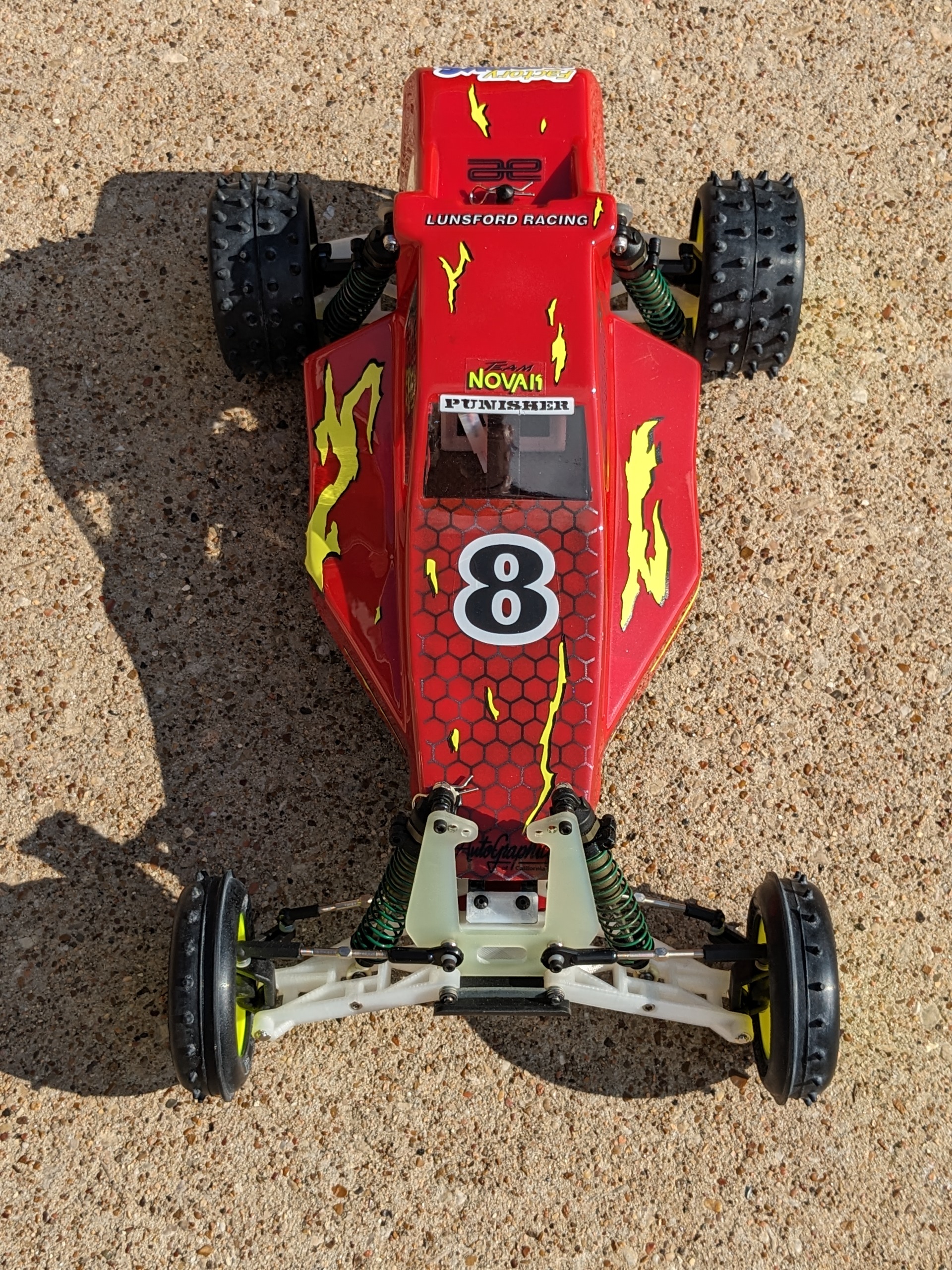

Frankentruck wrote: ↑Sat Sep 30, 2023 10:01 pm Now I just need to work out the paint scheme.
Wow, that happened quick!
Dig the hex down the center... and the little Autographics signature on the nose... classy touch.

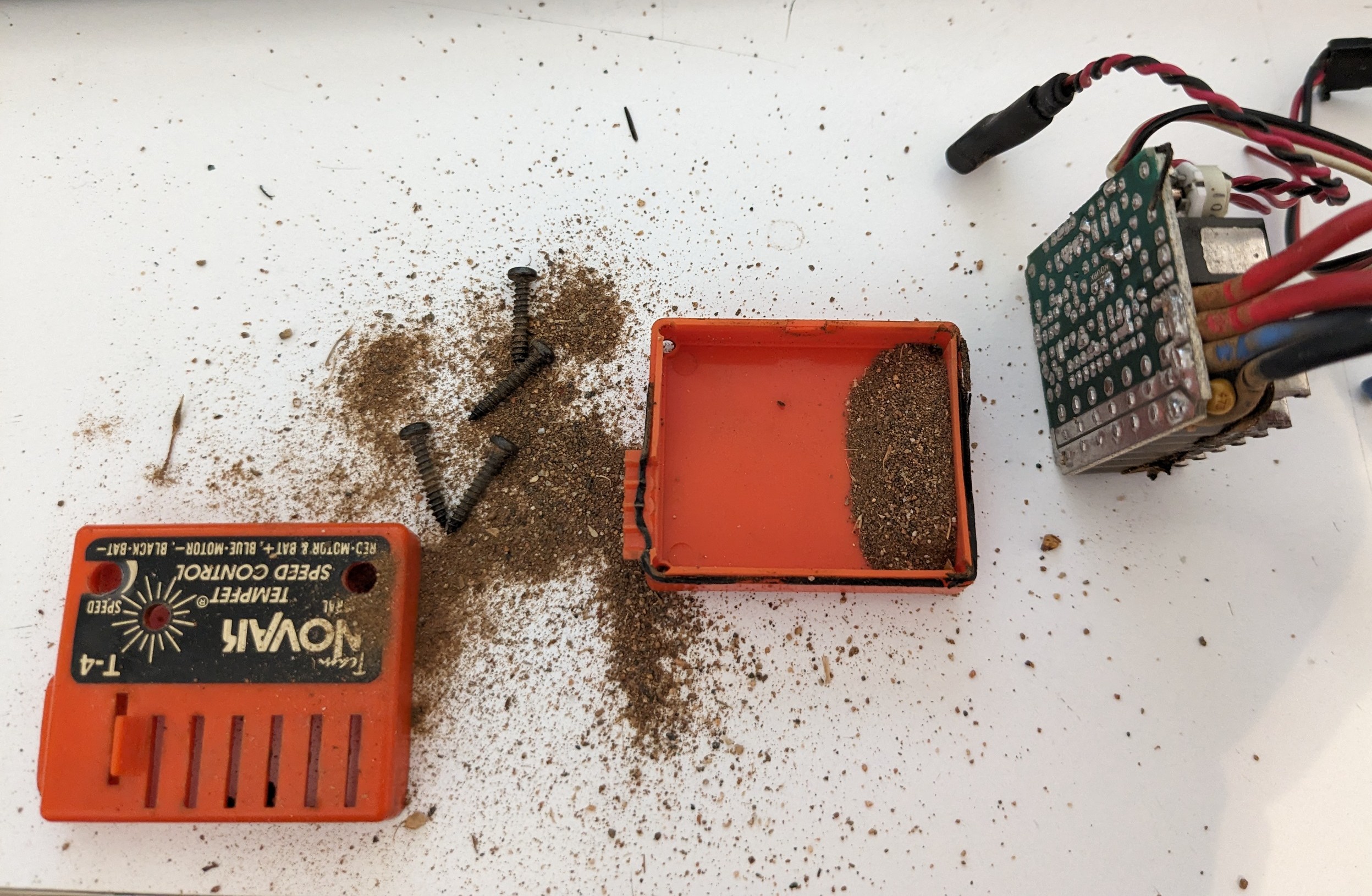

I popped open a T-4 for this buggy. There was enough soil in that thing to start a garden! πŸŒ½πŸŒΎπŸ…πŸŒ»πŸ₯”

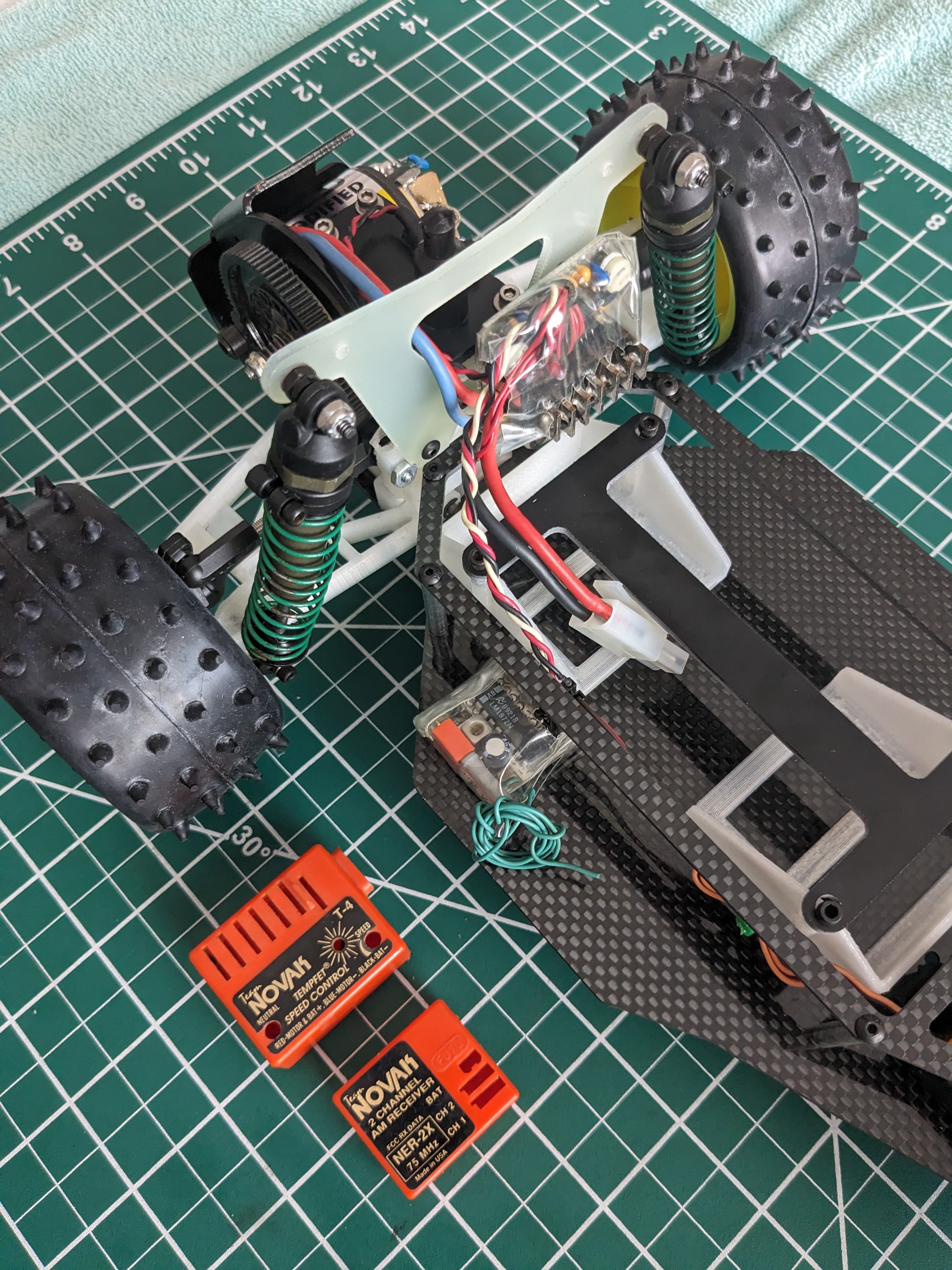

Typically, if it had a gasket I try to reuse it. Otherwise no gasket gets used. For Novak electronics that use black tape for seams, I typically use 1/4" pinstripe tape. This particular ESC is getting the shrink wrap 'weight savings' setup instead of the orange case.
Re: Frankenbuggy '91 B1.75 Detroit-ish Worlds Buggy
Posted: Mon Oct 02, 2023 1:29 pm
by Frankentruck
ESC and receiver installed. Cases replaced with battery pack clear shrink wrap.
Edit: decided to change to black dyed Novak cases.

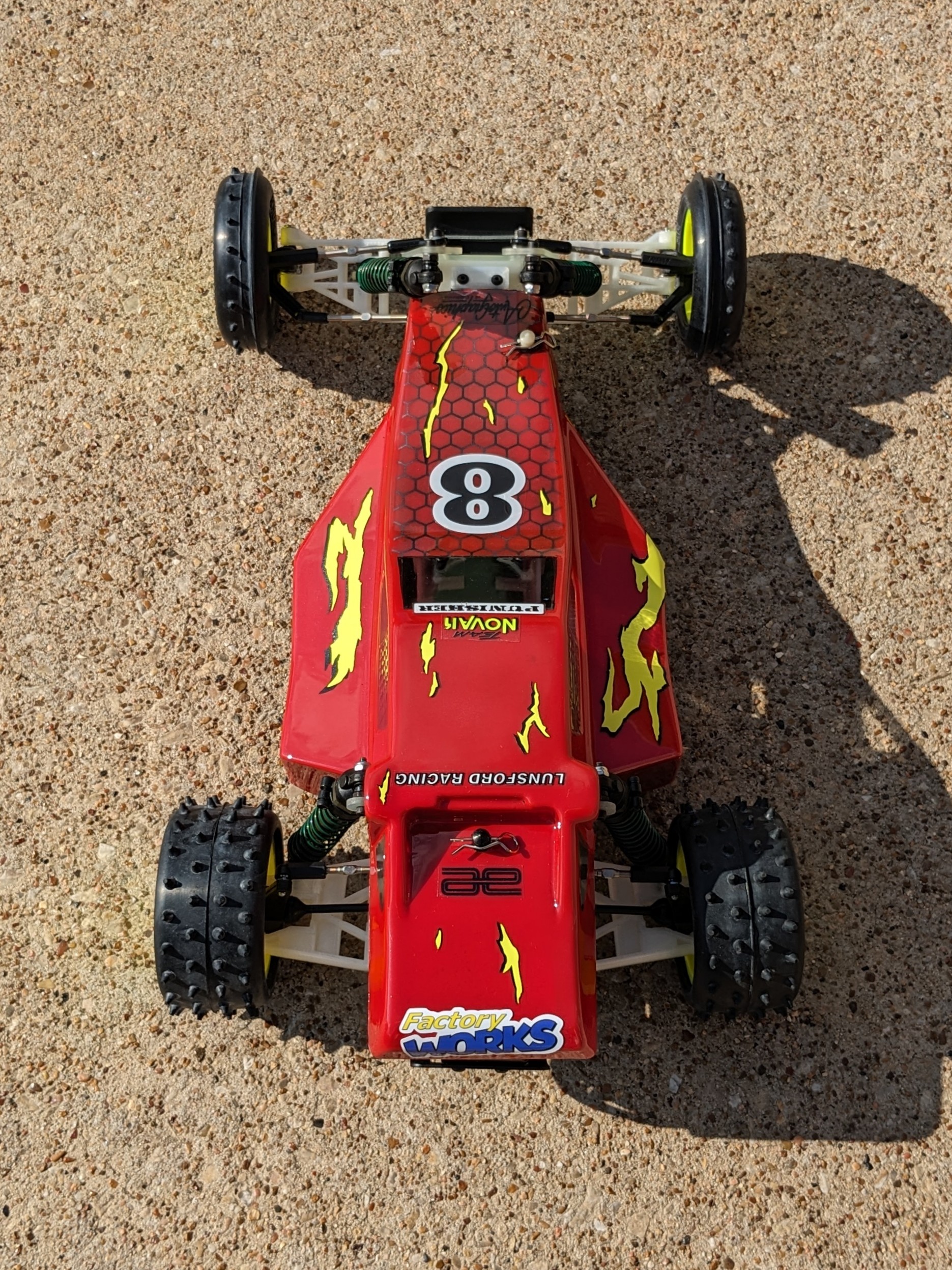

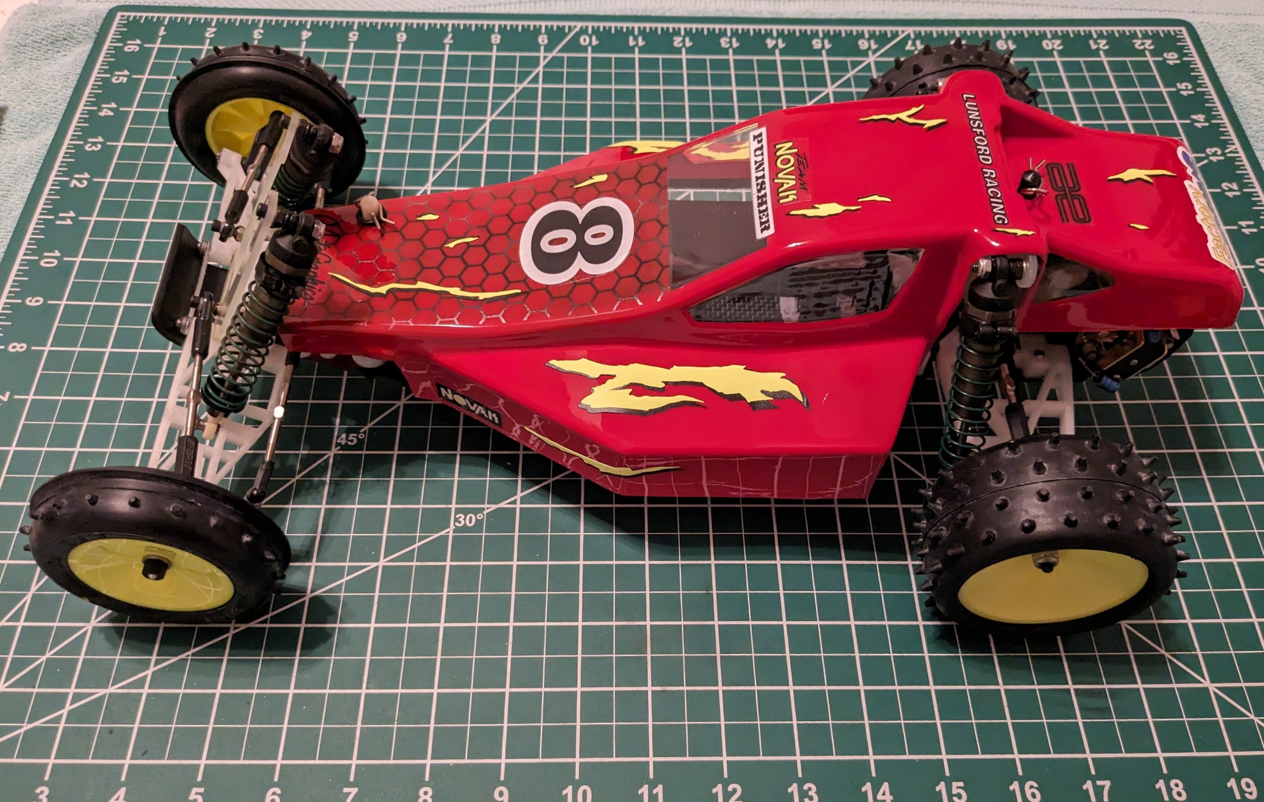

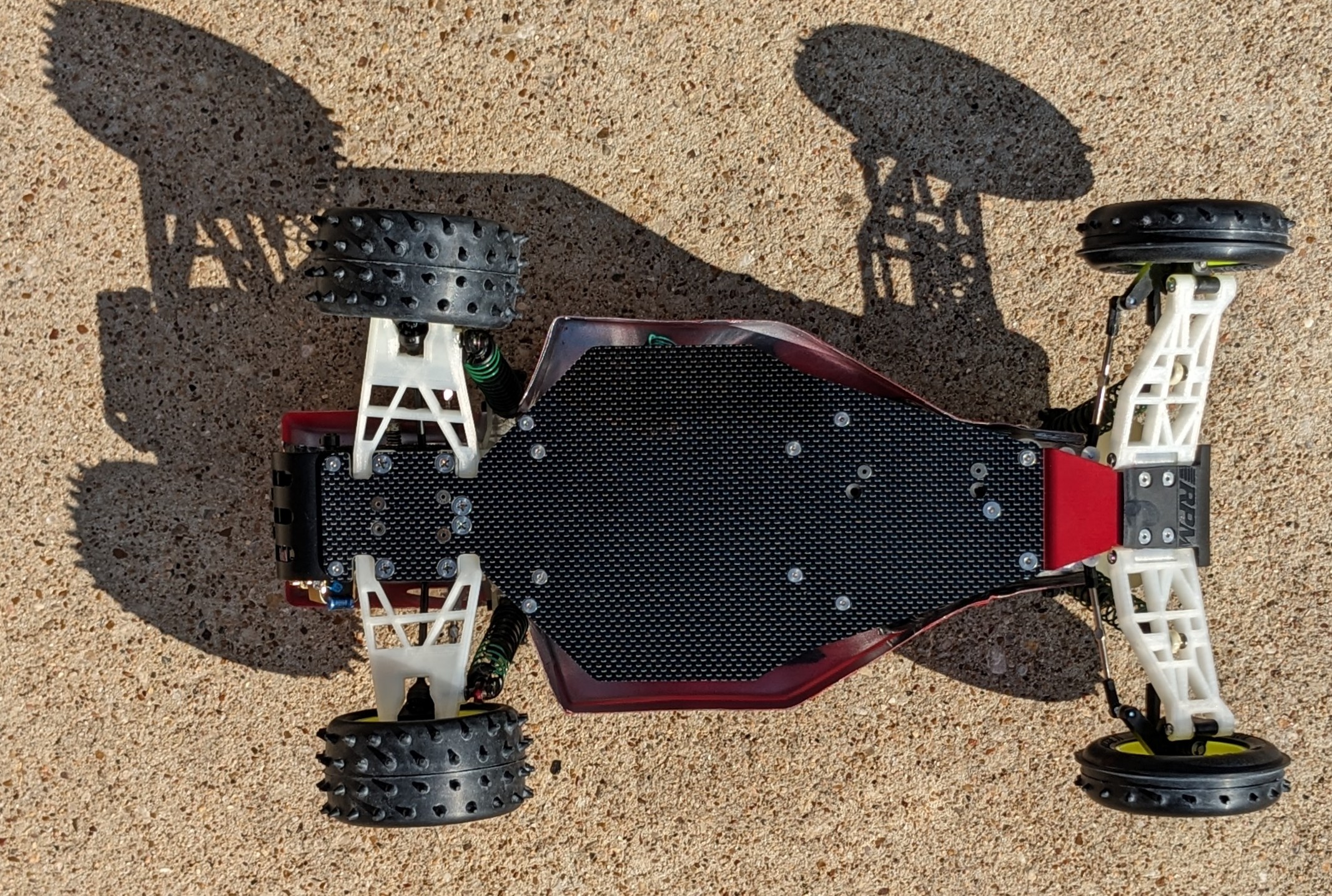

Posted: Sat Nov 04, 2023 12:55 pm
by Frankentruck

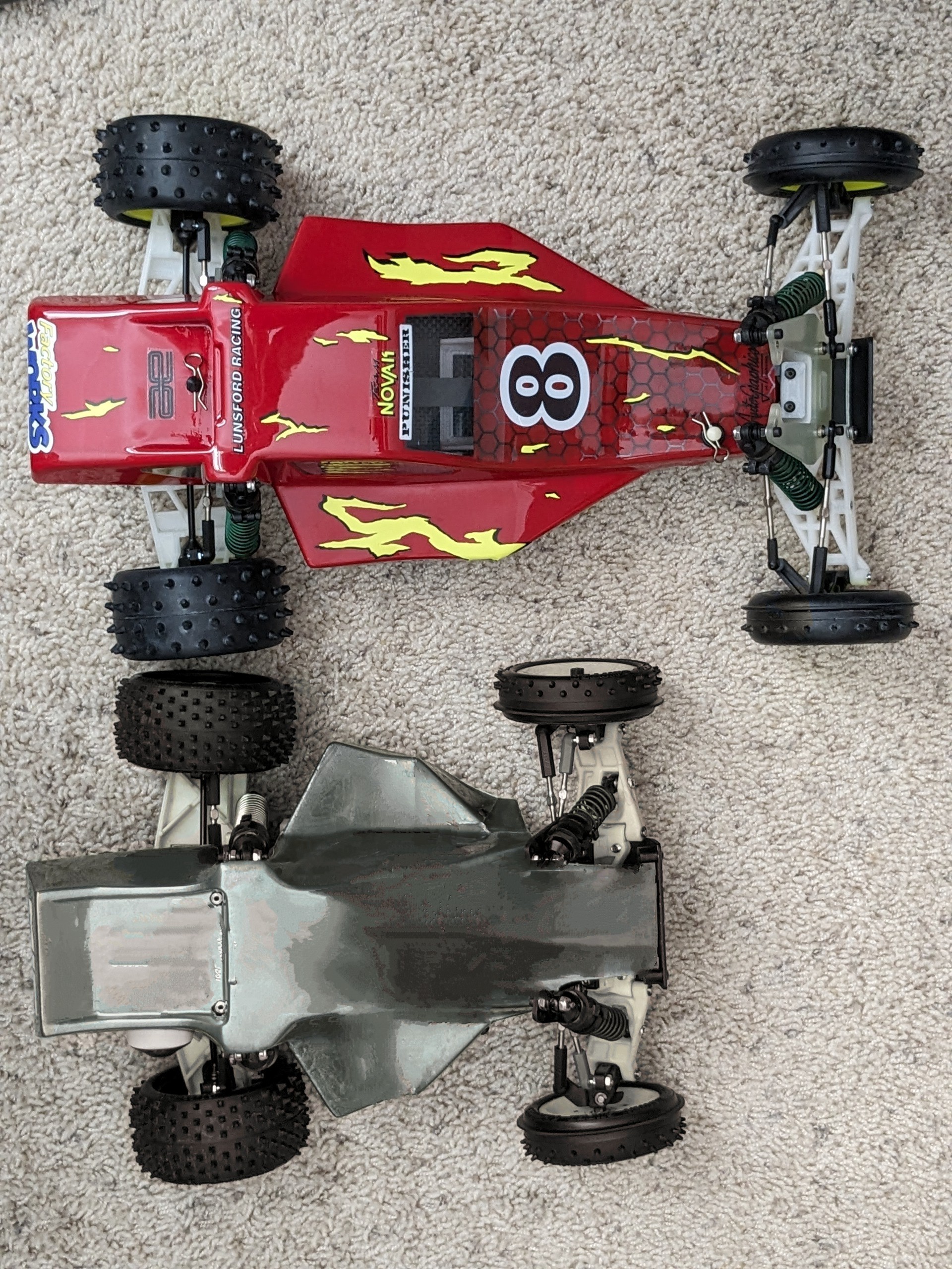

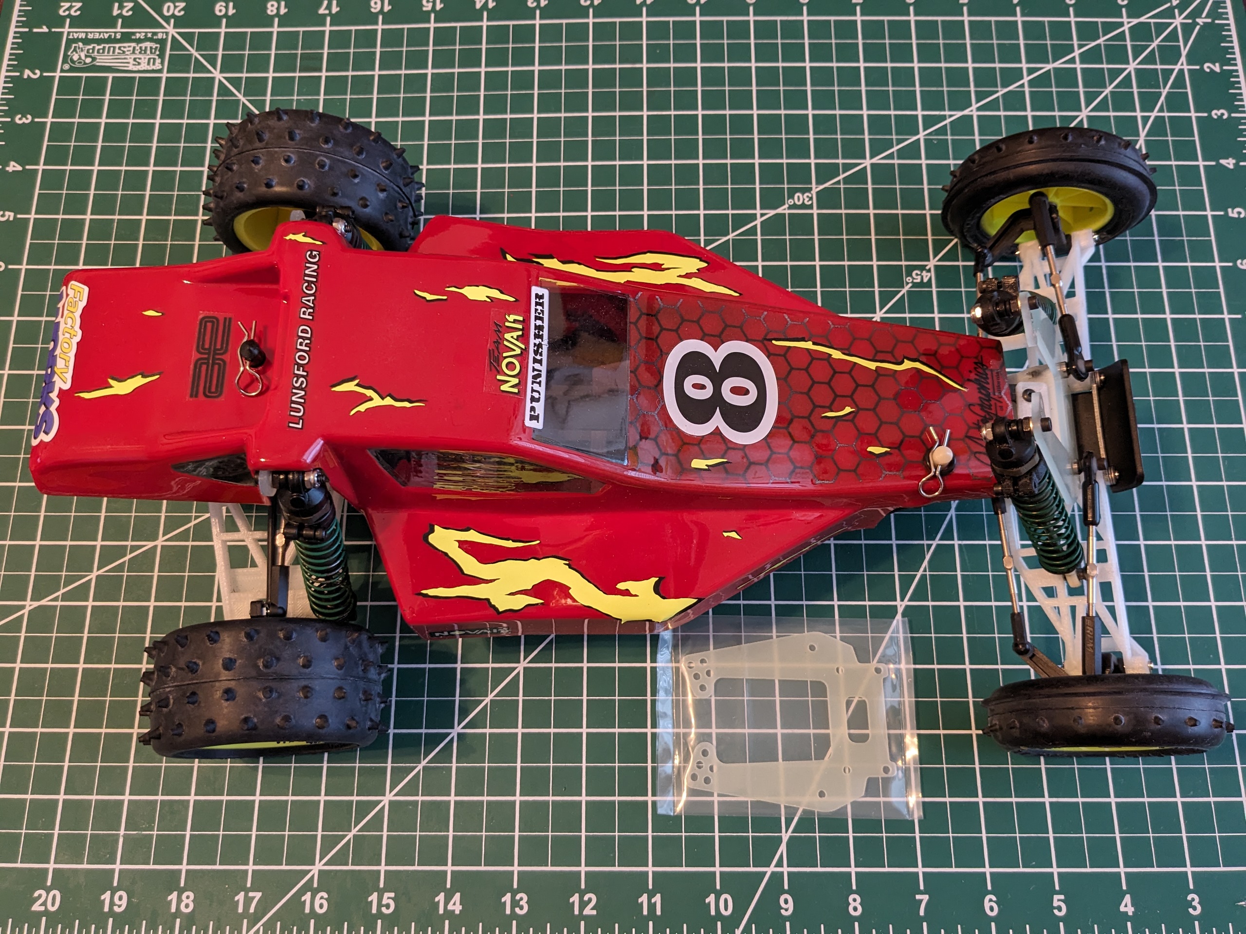

Took some sunny day β˜€οΈ pics... before the clouds rolled in.
One comparison to the shortie.
Posted: Sun Nov 05, 2023 10:48 am
by XLR8
The car looks great. Well done sir!!
It's interesting that AE's purpose built race buggies have a much longer wheelbase than their production buggies.

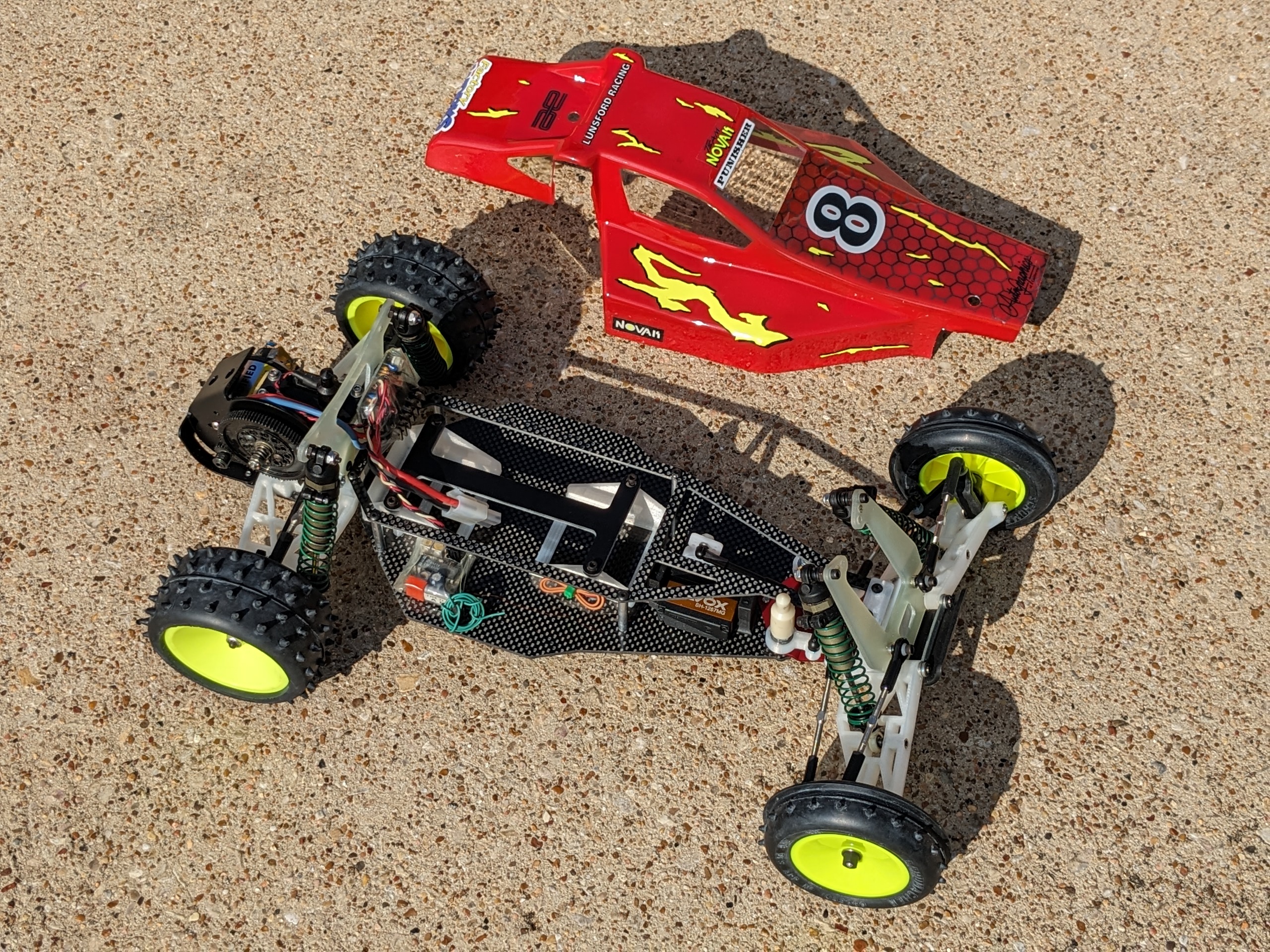

by Frankentruck
In my quest to adapt existing B2/B3 parts, I made a bit of a design goof. A recent shipment of Factory Works goodness included what I think I need to fix it up.
Posted: Fri Feb 16, 2024 9:31 pm
by Frankentruck
It's nice when things go according to plan. Upper links are now an appropriate length and geometry. Bump steer has been eliminated.

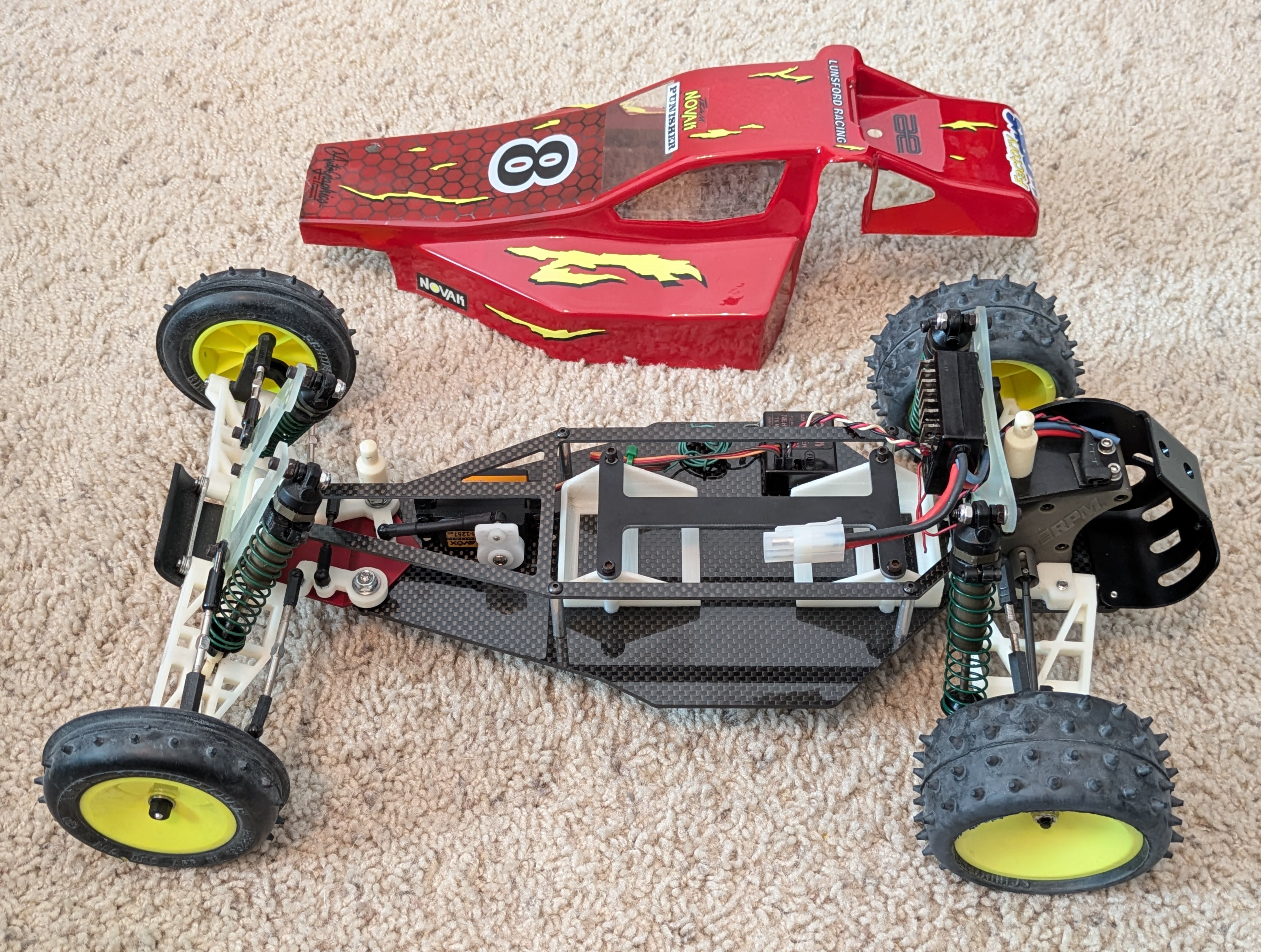

Posted: Mon Mar 04, 2024 7:36 pm
by Frankentruck

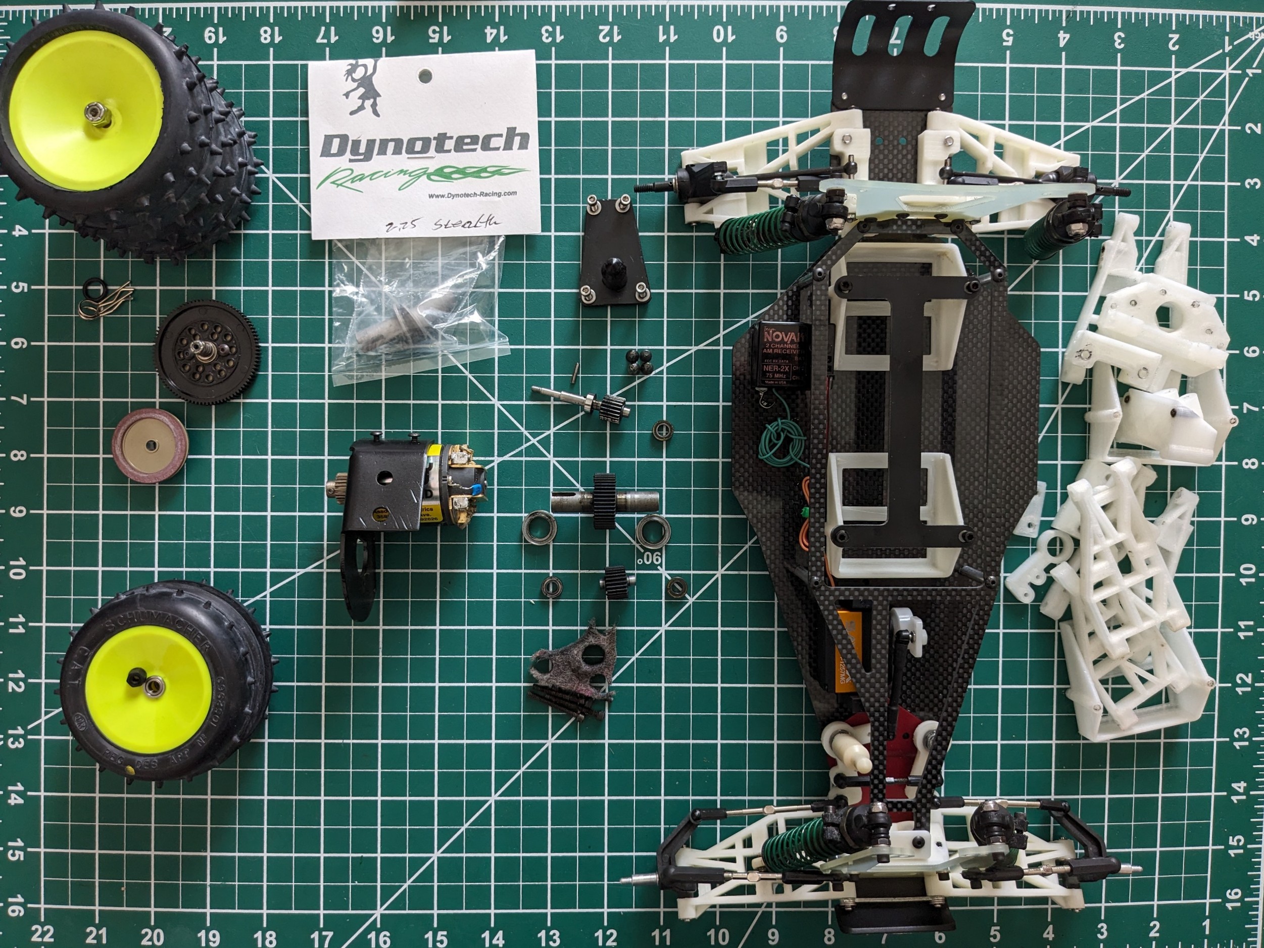

I reprinted the custom parts in a material that has a natural nylon color instead of starting as a transparent nylon. This material also seems to have similar properties to the nylon that was used for RC10 parts.
Rebuilding is mostly done. Just need to swap new outdrives into the diff assembly and whiten the gearbox case.

New Dynotech outdrives installed and gearbox whitened.
Nice to have this one done again.

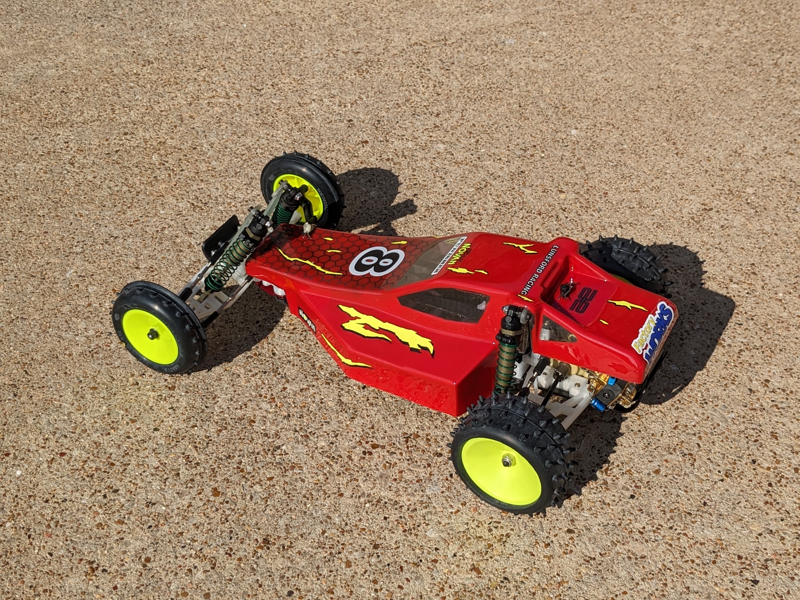

I found a home for my new to me 1.96:1 RPM gearbox.

That looks awesome!
