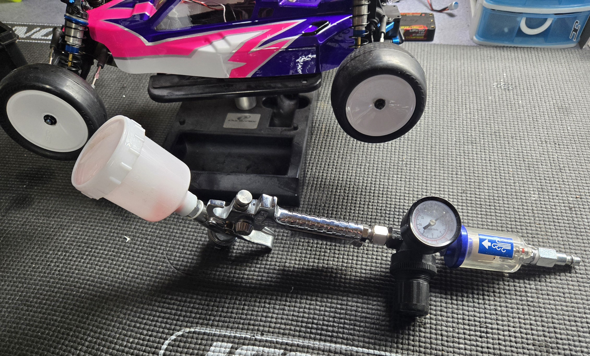

Liquid mask won't spray well through an airbrush. You are better off brushing it or spraying with mini hvlp. I bought my mini hvlp at harbor freight for 40.00 I believe. The one they have that is around 15.00 is junk.
