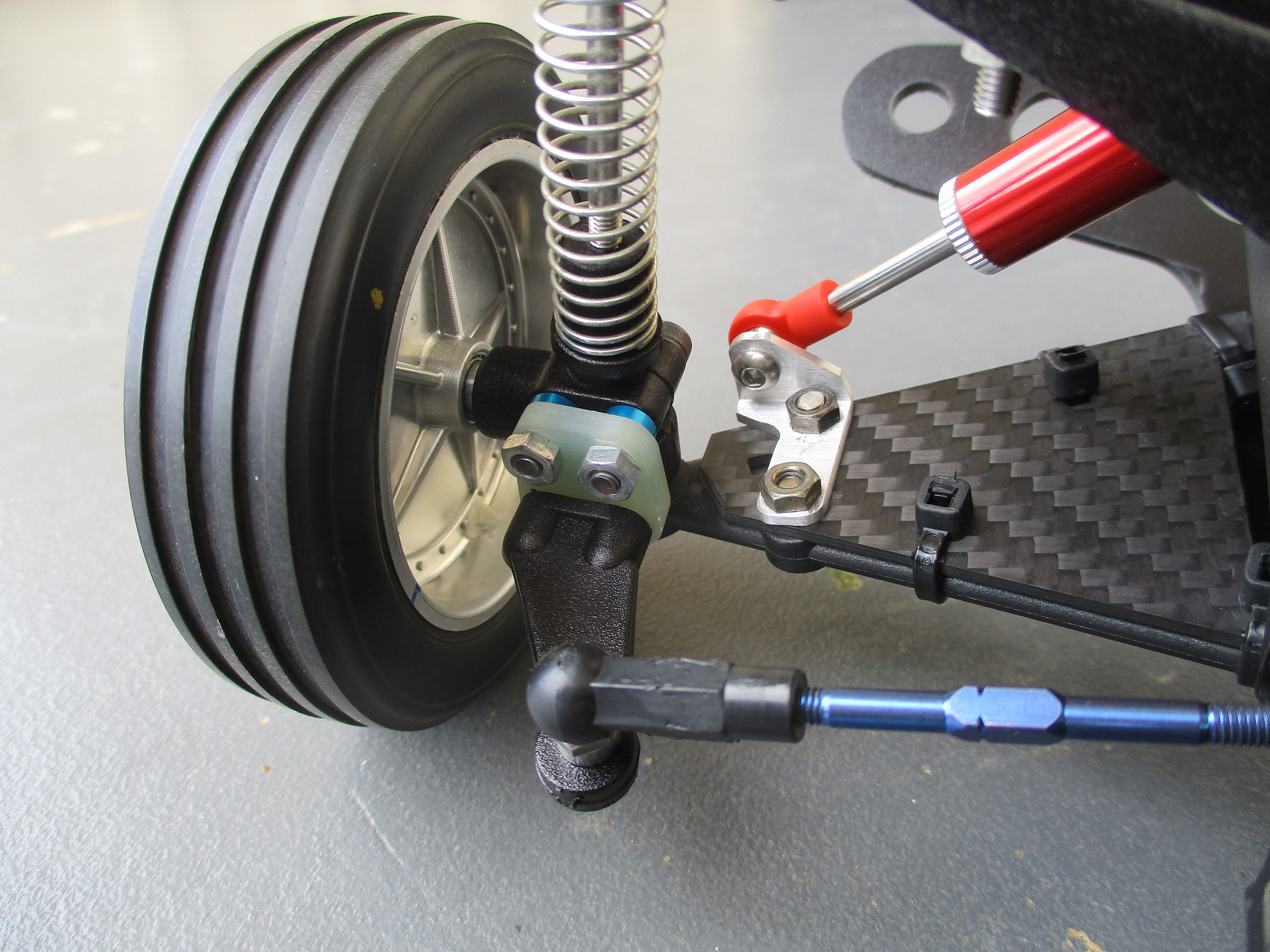

Epoxied carbon fibre strips to the top of each side of the chassis for added strength.
Kyosho Tomahawk front shocks have also been installed. Note the carbon reinforcing plates behind the tops of the shocks. I think without them the shocks would eventually tear out.
These G10 plates were also added to drop the ballend down and completely remove the bumpsteer that was present at the last third of suspension travel.
