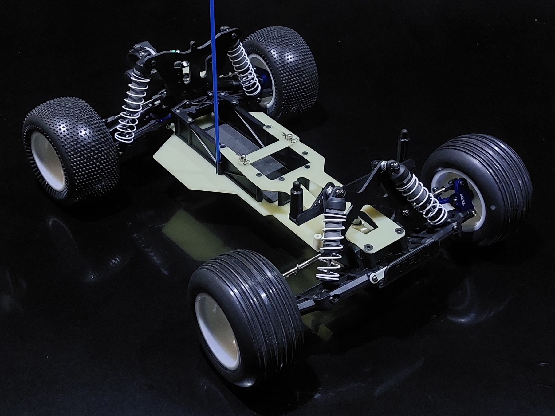

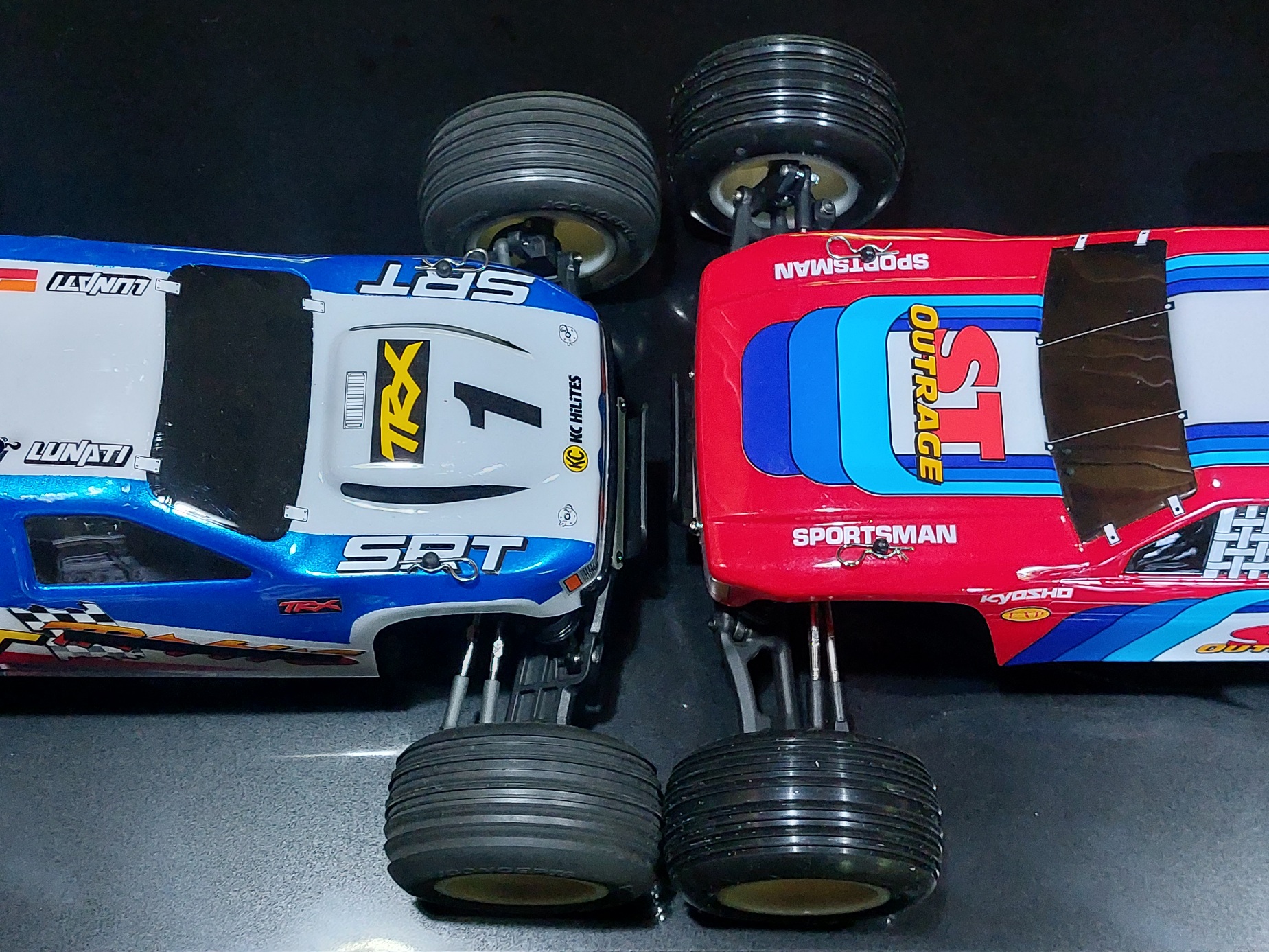

Aren’t the wide front RPMs the same width as the Rustler rears?
Re: Here we go again.....
Posted: Thu Dec 12, 2024 1:59 pm
by juicedcoupe
Chewbacca wrote: Thu Dec 12, 2024 1:51 pm Aren’t the wide front RPMs the same width as the Rustler rears?
To my knowledge, they are 10mm longer than factory fronts. This would allow you to use the same offset wheels all around.
The front and rear wheels on electric trucks have 10mm difference in offset.
The front caster block, carrier, and wider hex account for the remaining difference.

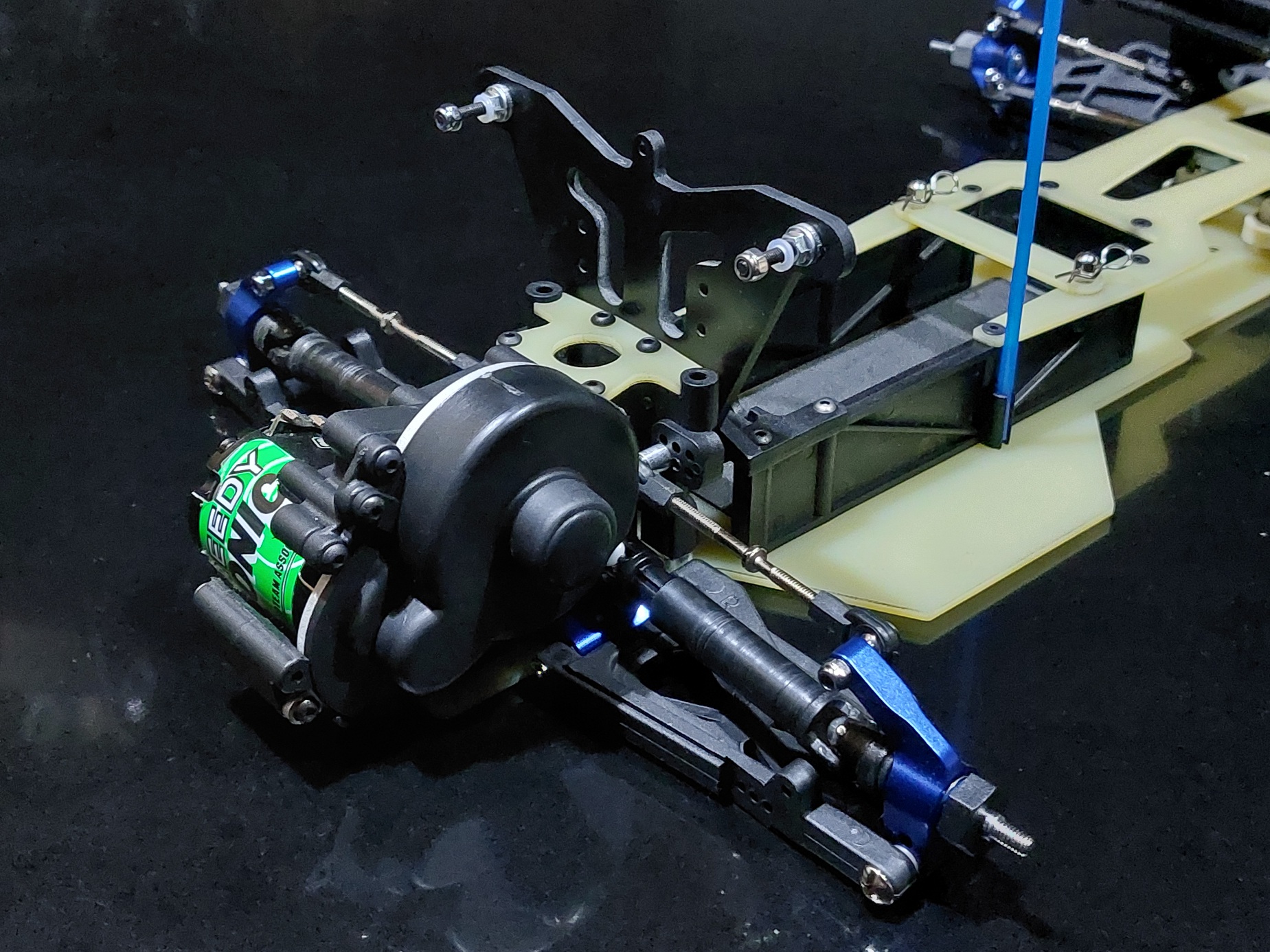

Something else to keep in mind is that the Nitro Rustler rear carriers position the rear axles out a couple mm, compared to the electric ones.
Something to keep in mind if using CVD's.

juicedcoupe wrote: Thu Dec 12, 2024 2:53 pm Something else to keep in mind is that the Nitro Rustler rear carriers position the rear axles out a couple mm, compared to the electric ones.
While the rear nitro (also hawk and that era) arm mounts pull the pivots closer together, compared with the current gear box mounted arm attachments.

Chewbacca wrote: Thu Dec 12, 2024 11:59 am First of all, why’d you cut off the ears on the tranny case? I am sure you are aware yourself, those use a longer screw from the arm mounts to stecht to. It should work with either the RPM mount or the Traxxas Nitro rustler mounts. Perhaps some shaving or shimming required.
The RPM wide arms make the truck quite wide. The Slash arms narrow the rear to use the same deep dish wheels. I think the part number on the slash rear arms is the same as the SRT. I know the RPM case uses the molded arm mounts but you'd have to modify the nitro arm mounts to get them to work with the RPM case.

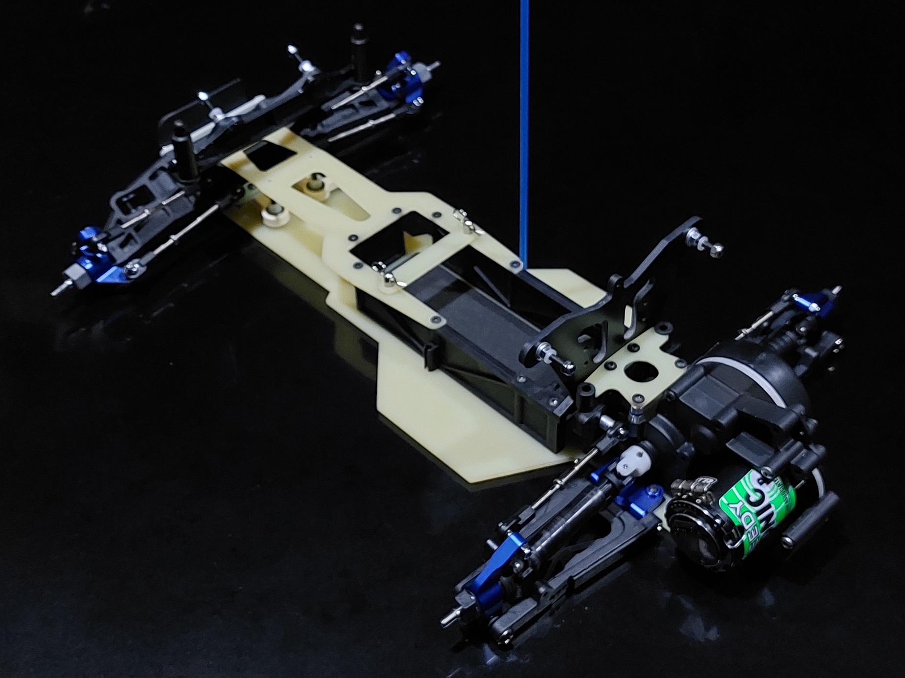

Here is the gearbox installed in the truck. It would look so much better with the excess fat trimmed off but for now it will do. I may buy another case down the track and experiment with it. Maybe even cut out a new motor plate that has a gear cover mounting tab would be ideal.
