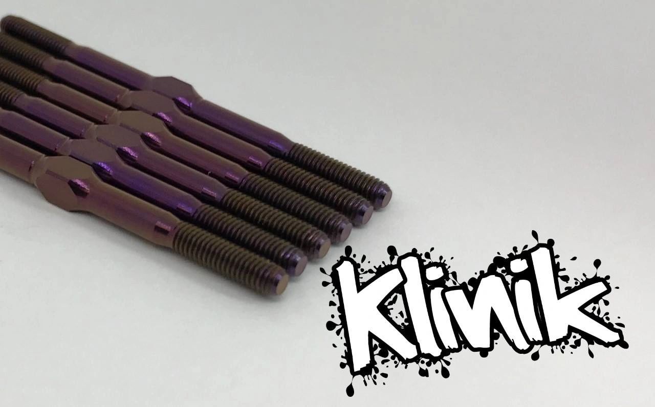

Orange shocks look a bit goofy on a green car, going to have to figure something out.
Found an extra black 48dp 81T spur gear that seemingly had been waiting for this project.
Debating putting together those stock turnbuckles, or finding something more fitting and upgraded. Will have a look at what's available, and decide tomorrow.

GoMachV wrote: Mon Jan 06, 2025 1:15 am:mrgreen:
Nice! When they say World's, are those longer than the classics, due to the arms?
Re: RC10 Green Edition - Build
Posted: Mon Jan 06, 2025 2:38 am
by GoMachV
Yes, but they sell the classic length also. When you are on the webpage you can select colors and length
https://klinikrc.com/shop-1/ols/products/klinik-rc-rc10-worlds-titanium-turnbuckle-set-7pcs-3mm/v/KRC-WORLDSTB-GRN-RGN-SHR

There are some nice choices available, thanks for that!
