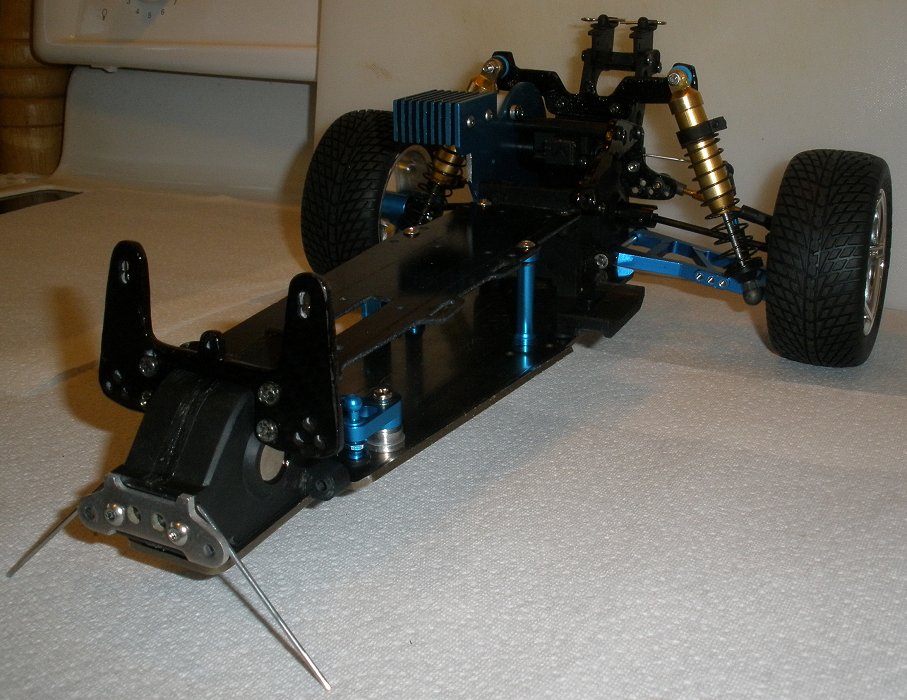

I had a free day this Saturday so here are more progress pics. Sealed the rear gearbox and installed the wing mount. I then fabricated a carbon fiber front shock tower and installed the empty front gearbox and stabilizer wire. Now I just need to wait for some front arms to arrive from a fellow forum member before I can do anything more. 8)

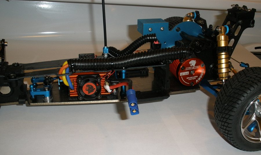

I have something really cool planned for the electrics installation...wasn't quite finished the planning last night, but got some soldering done and the servo & saver mounted and a turnbuckle ready to connect to the bellcrank...this is gonna be smooooth. 8) And wait until you see how I'm planning to mount the ESC! I had originally wanted to mount the battery longitudinally to move some weight forward and lower the center of gravity, but had to scrap that idea as there just wasn't enough room...pics at 11:00. :wink:

I installed a nice blue aluminum servo horn with a Tamiya high-torque servo saver, as the bellcrank doesn't have one. The stock Optima/Mid steering linkage is functional but there are numerous metal-on-metal friction points and rather weak ball joints. This aftermarket bellcrank with bearings looks to be solid as a rock and smooth as silk, with no slop whatsoever. I can't wait to try it out once I've installed a receiver. 8) I used some random Associated titanium turnbuckle and 4.8mm balls/cups to connect the servo with the crank.
I chose the Leopard 12T 3300kv motor/ESC/program card combo for OptiMutt...yeah, a big reason was because it was orange, which is as close to gold as I could get. :oops:
As I mentioned the post before, I originally wanted to mount a battery longitudinally but no matter how much I stared at it, I just couldn't find a way to make it fit without completely cutting up the chassis and adding on a chassis extension piece, or buying an expensive carbon fiber or graphite chassis plate.
I was thinking about the best way to install the ESC when it suddenly occurred to me--the ESC was almost as wide as the space between the upper/lower deck! I did a few test fits and found there was JUST enough room to sandwich the ESC sideways between the decks, with the fan outward so as to receive some airflow, and enough room not to obstruct the steering servo. With the ESC mounted there, it's super neat & slick, lowers the center of gravity considerably, and also allowed me to move the balance point more forward.
I used a Dremel to open up a sort of keyhole shape in the top deck that I could route the ESC motor wires through. Here's a preliminary fit. I've attached the ESC to the underside of the top deck with double-sided tape and will clean up the wiring with zip-ties once all the electrics have been tested. I'll use Velcro instead of double-sided tape on the bottom of the ESC where it mates with the bottom deck, so I can easily remove the top deck when necessary.
Have you ever seen an Optima or Mid that looked anything like this? :twisted:

Had some spare time last night and since I'm getting bored sitting on my hands waiting for some parts to arrive, figured I had to do something constructive. I had some leftover carbon fiber lying around so I made some carbon fiber suspension pin plates. I'm getting tired of looking at this thing without a front end. :?

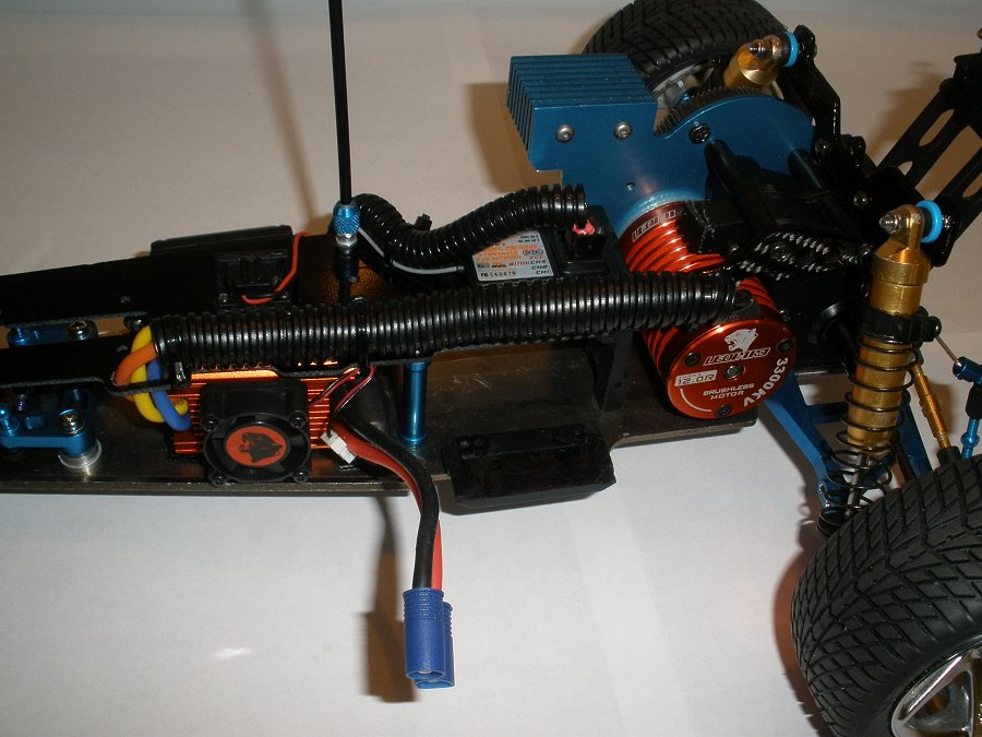

Posted: Wed Apr 03, 2013 1:46 pm
by Coelacanth
LOL Guess what, I tried that first! I had a bunch of black braided sheathing, I've used it in the past with modded computers...but it looked like ass when I was done and doesn't protect from stray water droplets either. The problems with braided sheathing is you have to cut the ends and they ALWAYS fray, even if you pre-heat the ends with a flame. It can also be a pain to install over larger areas like where the 3 motor plugs connect to the ESC; this resulted in me having to use a braid larger than I wanted, and it just got too bulky-looking. Lastly, with braided sheathing, you can't easily slip your wires out at any time to check or change connectors, for example...which is not a good thing if you're still in the planning stage of a build.
Needless to say, I ripped out the braided sheathing and went with plastic split-loom. It's so much easier to work with, protects better, and looks good.
Based on my experiences with it, I don't recommend braided sheathing--at least for RC cars. Works great for modded computers, though. :lol:
