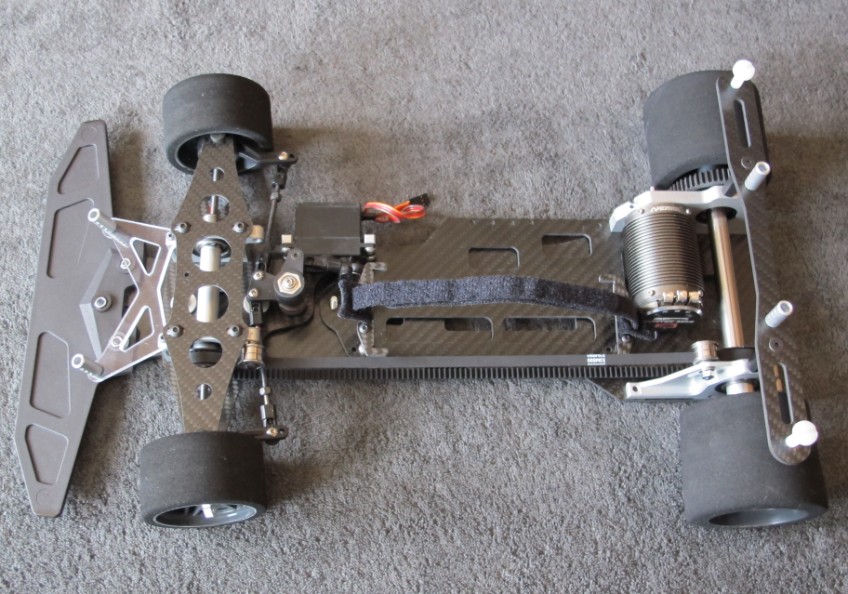

Front end mounted to chassis. Top aluminium washer with o-ring not shown at this picture.
It´s important to tighten the locknuts to the chassis screws, no adjustment here. The rocker plate will move just a little, provided by the o-rings. Loosening the locknuts will affects bad swinging of the rocker plate and bad handling of the car. I tried mounting the rocker plate without the aluminium washers and o-rings what effects more moving range of the rocker plate but I have been told this doesn´t work really good at the track. Best option seems assembling as per instructions.
Additional washers below the lower washers/o-ring assembly could be used for adjusting front ride height, when using large front tires. As the steering servo is mounted to the rocker plate also, there is no need for adjusting track rods or ballstud washers when changing ride height.
Front belt tensioner is using fixed position. Belt tension will be adjusted through the inserts at the front axle aluminium plates and at the rear belt tensioner.

Adjustable belt tensioner for the rear axle, currently at lowest pressure setting. Maybe more pressure will be needed later.

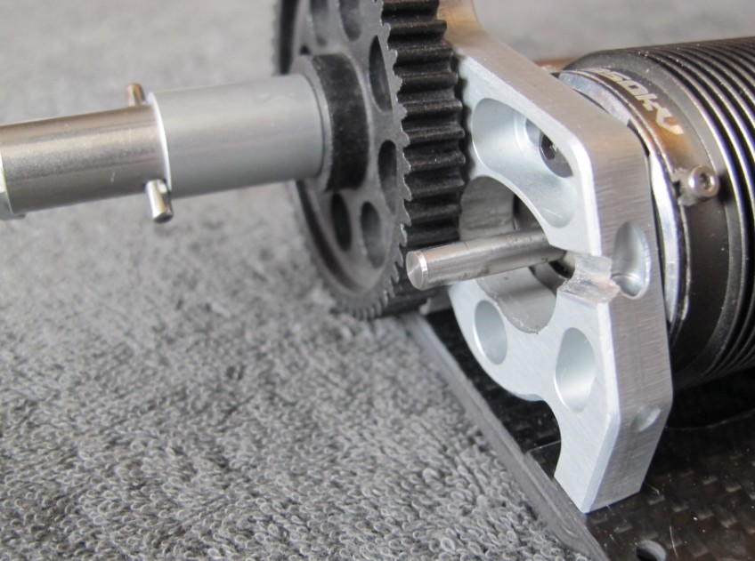

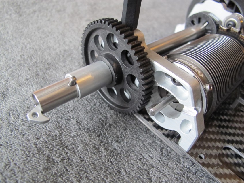

High power brushless motors were used for the prototype cars. These were using 11 or 12 tooth pinions which could be mounted to the motor and positioned through the hole at the motor mount.
When using low reving motors like me, you have to use much larger pinions. I found they are a little more difficult to mount using a very short angled allen key for the pinion screw. I preferred to modify the motor mount slightly as shown at the picture. Using a file or Dremel you can easily do that modification and the pinion screw could be tightened much more easy this way.
Pictures also showing the quick release system for the wheels at the rear axle. Changing wheels could be done in seconds without any tools needed. I like it
but just wonder why this wasn´t used for other cars than 1/8 scale before.
