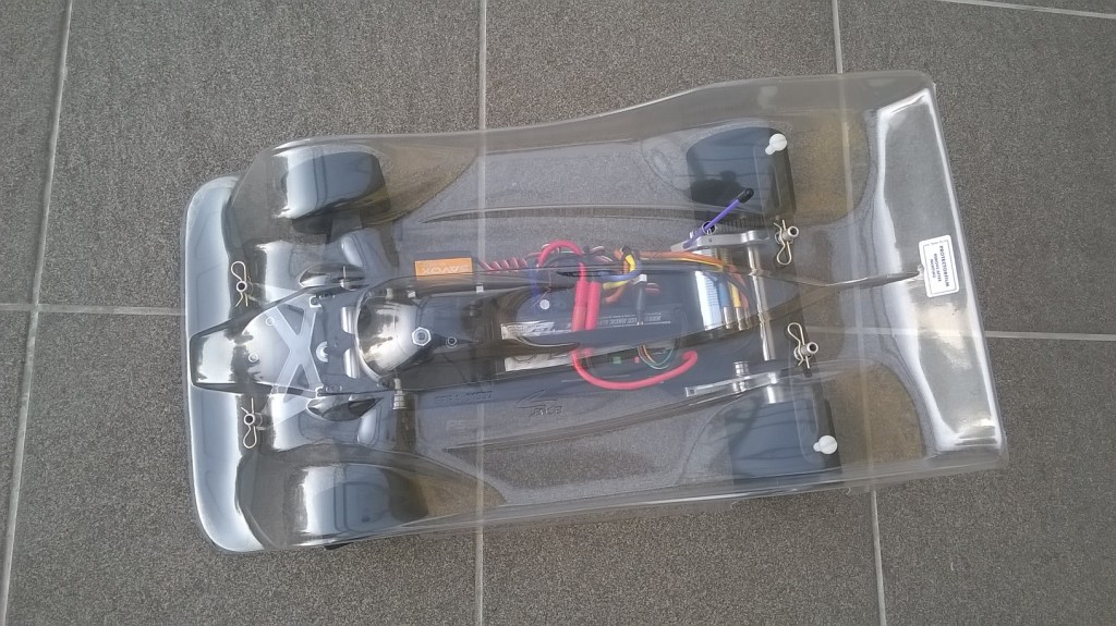

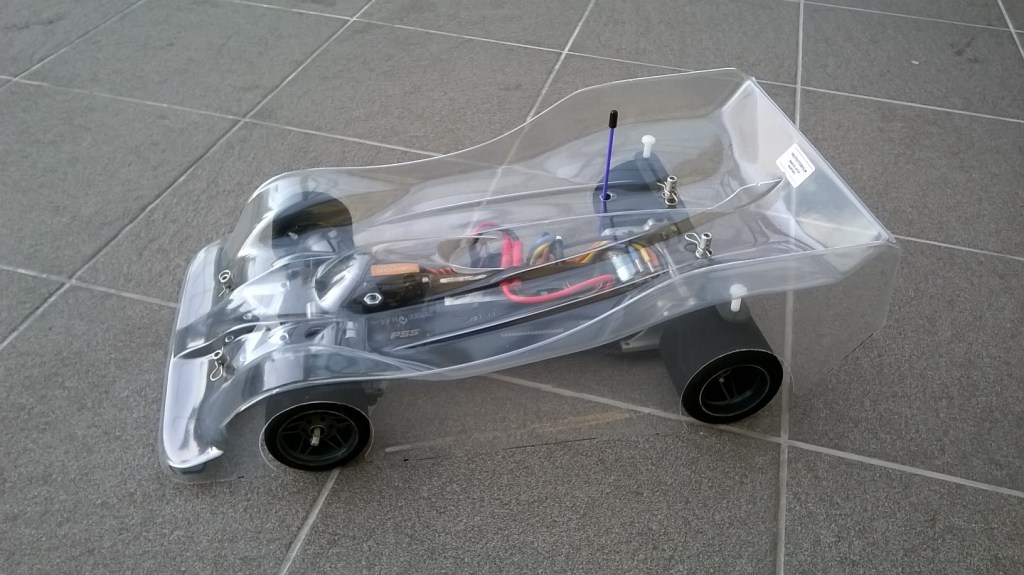

Car is finished now, just needs ESC and receiver added. The bad thing is temperature and track conditions are quite bad now and it´s not sure if the maiden run could be done in the next weeks or needs delaying for next spring.

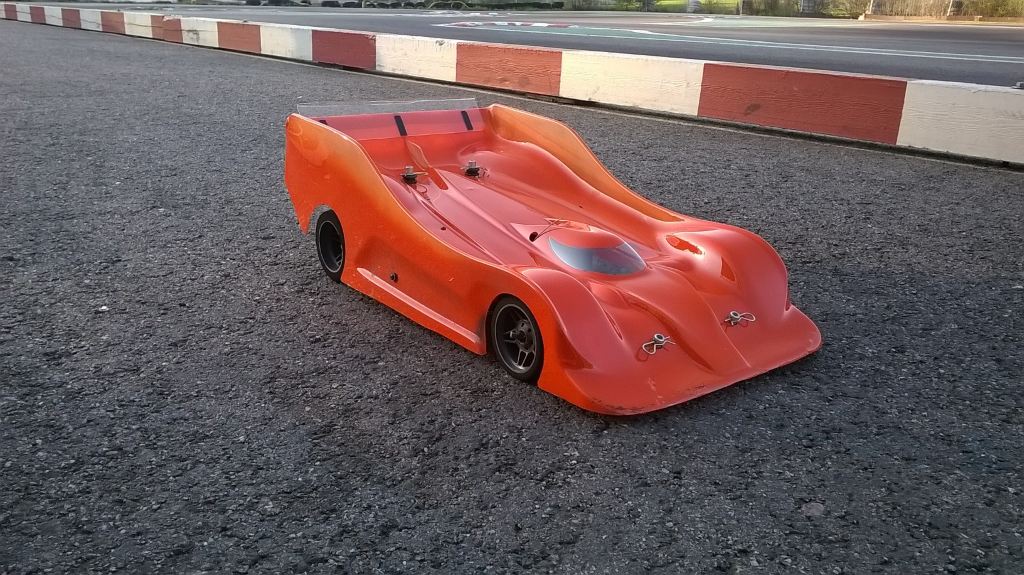

Finally had a chance to drive it. It's pure fun for sure.
How about you V12 ?
Too bad I forgot all my pinions home. I would have liked more speed on main straight. Next time then...

Body is an old Protoform R18 which works really good but it´s a good idea moving the body a bit to the rear as the rear end could be a little loose on corner exit, as there is no camber or toe-in as found with suspension cars. A P909 body might be too much and the Sheperd body used by Niki should be quite smooth to drive from what I heard.
