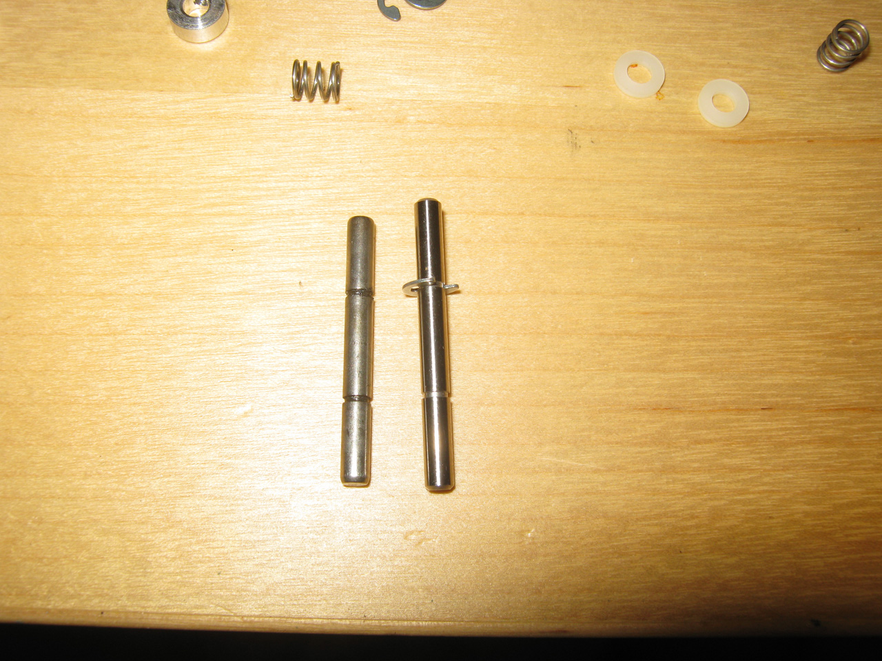

First, I decided to reinstall the front uprights. So I got the ones that were on the car out of the bag of parts:
These are quite dirty and one of the steering links is bent. I will replace that link with one from another parts car later on, when I have a suitable servo. The kingpins used are those from the optional kingpin set.
However, I will be using this Cross set instead:
These include slightly longer kingpins and shorter springs:
All so they add an adjustment option to the car:
...adjustable ride height, either through the spacers shown here, or by limiting the suspension travel through a collar that is attached to the bottom of each kingpin. However, the latter choice uses very small set screws in an aluminium collar, and I'm afraid of losing them while running. So I chose the spacers.

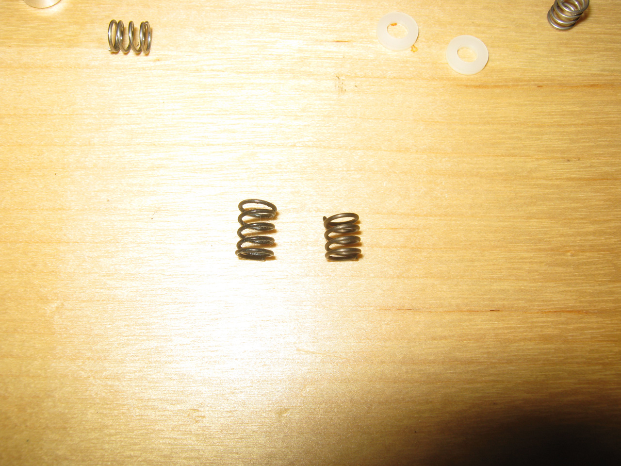

The Cross set comes with three spring rates, soft, medium, and hard, with the medium set being as hard as the hard set from Kyosho. After taking the front arms apart and then bolting the front end back together, I went to have a look at the friction damper. Sorry, I forgot to take a picture of the assembled front end... :oops:

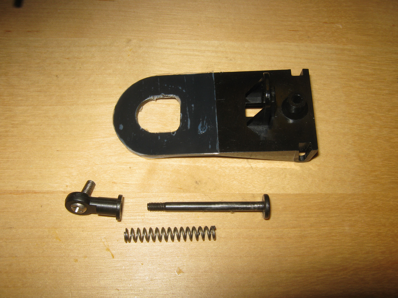

First, a look at the top plate and the original 'damper', which is no more than a spring on a screw:
As I will be using an oil shock, I need to remove the spring damper's mounting point from the top plate:
This required quite a bit of force to snip off.

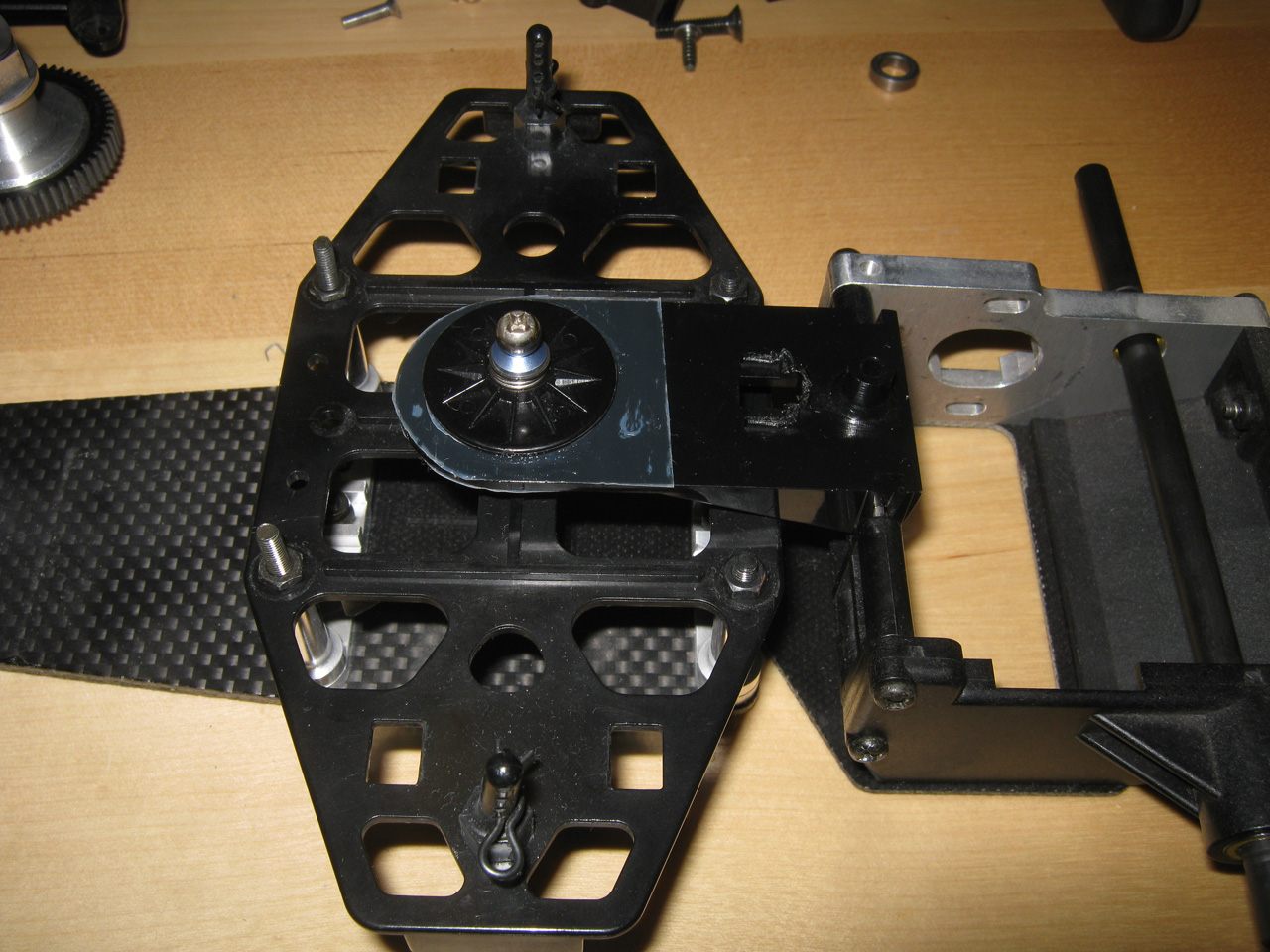

The parts required for assembly:
Putting the central plate in place was a pain in the behind because the axle that goes through the front of the pod was hard to correctly insert into the holes, and then it was also hard to fully slide it through the pod. If there had been a motor installed I wouldn't have succeeded...

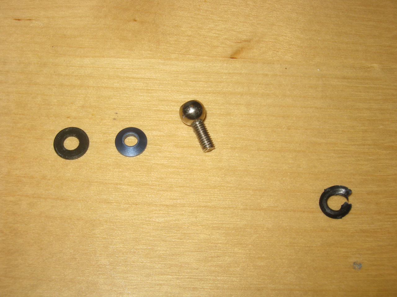

Mounting the top plate failed initially because the plastic collar onto which the ball for the shock mounts broke when I tried to tighten down the ball. So I swapped it with a TF-2 alloy collar:
After assembly:
I used some medium Tamiya friction damper grease on all of the plates. The friction damper is non-adjustable.

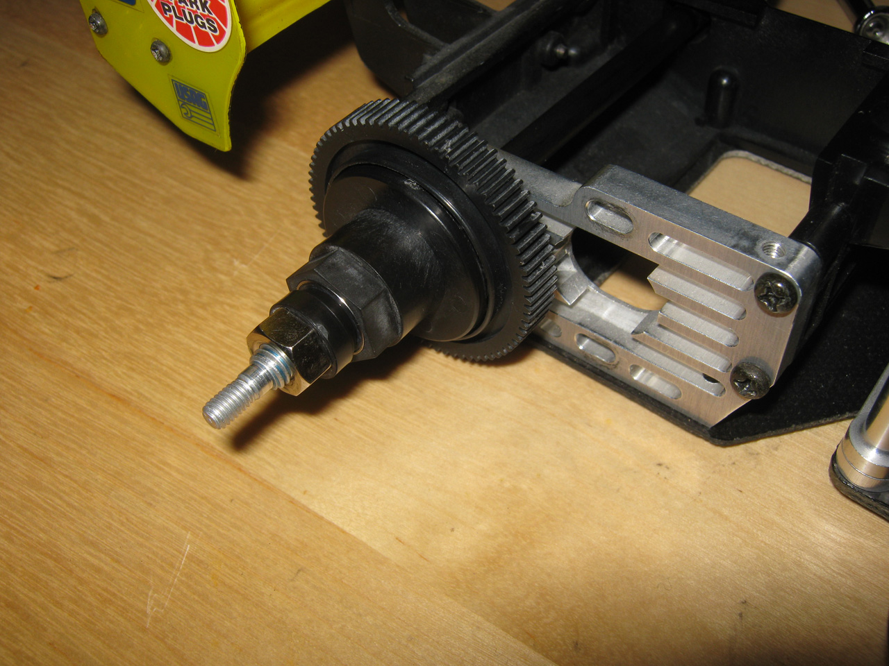

I've also discovered the optional ball diff has a design issue: it can't be properly tightened because the nut bottoms out too early :roll: I figured there was some kind of issue when I saw the instructions helpfully suggested shimming the diff on the axle side if it couldn't be properly tightened... Of course, only a single shim is provided. I was already planning on getting ceramic diff balls for it, so I will add the correct size of shim to the order.
Another issue I need to solve is that the carbon axle I want to use is a bit worn and tightening down the set screw in the diff hub won't lock the diff hub to the axle...

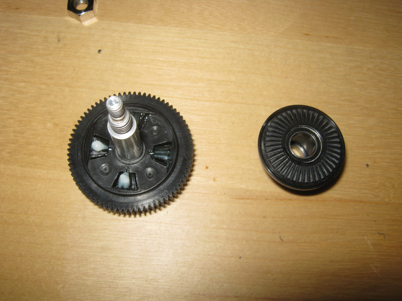

I then turned my attention to the gear diff that was installed on one of the parts cars. It was really dirty and had been filled with way too much grease. After a lot of cleaning I ended up with this:
Note how the small gears are rather chewed up. Probably the excess grease and dirt is partially to blame, but the parts car was only run with a 540-class motor :shock: ...so the small gears can't handle even the weakest motors :| . I still decided to rebuild the diff.
First, a modification:
I drilled a hole in one of the diff hubs so I could properly tighten the diff shaft to the rear shaft without having to take the whole diff apart.
I then installed ball bearings in the other diff hub, and put the worn gears in the spur, only lightly greasing them this time:

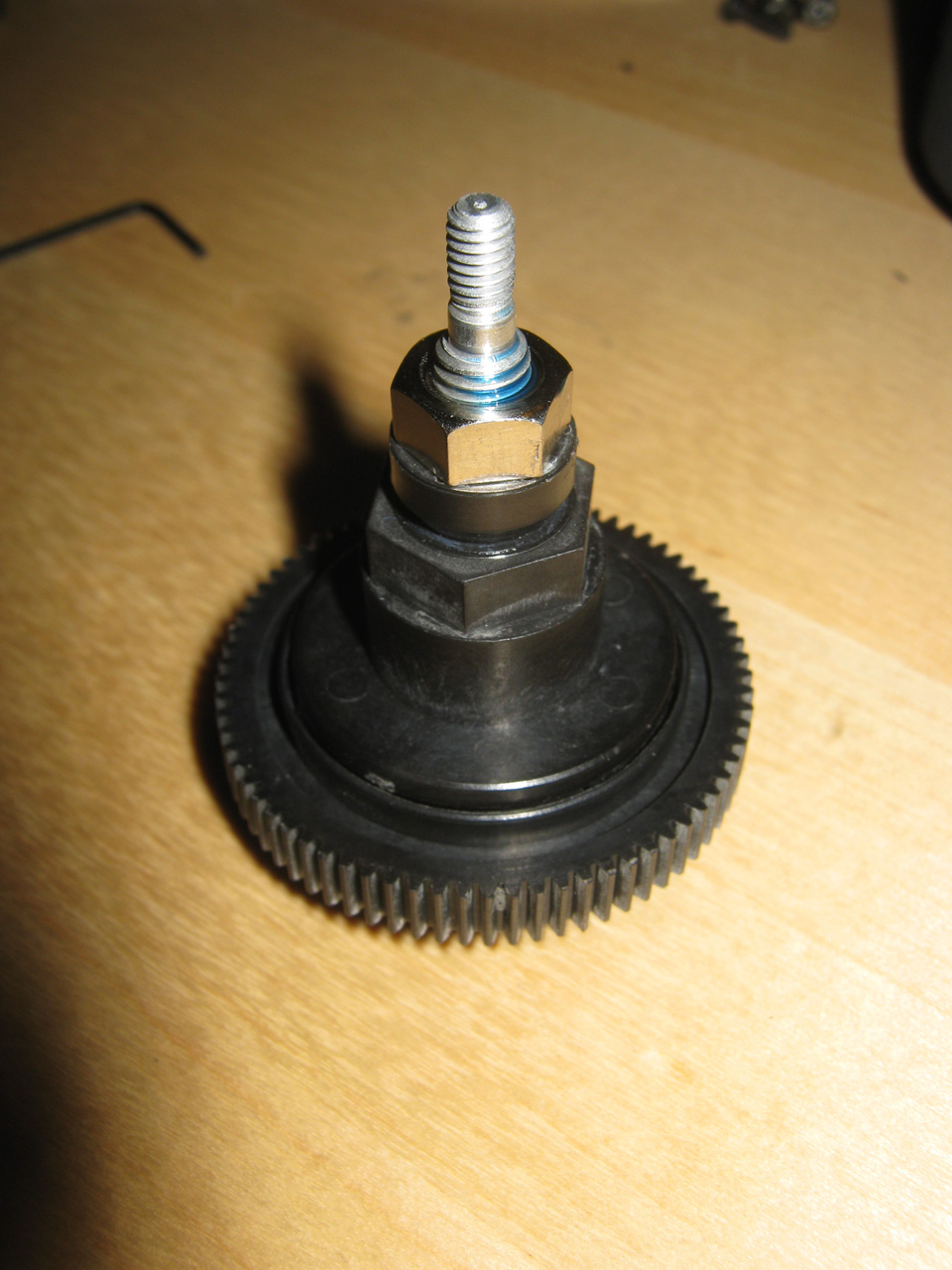

I then assembled the whole diff and applied a little bit of blue loctite to the nut keeping everything together so the diff can't loosen while running:
Surprisingly, it is quite smooth despite the damage to the gears.
Then it was installed on the car:

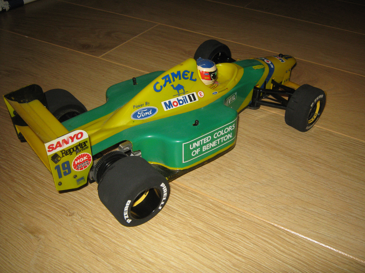

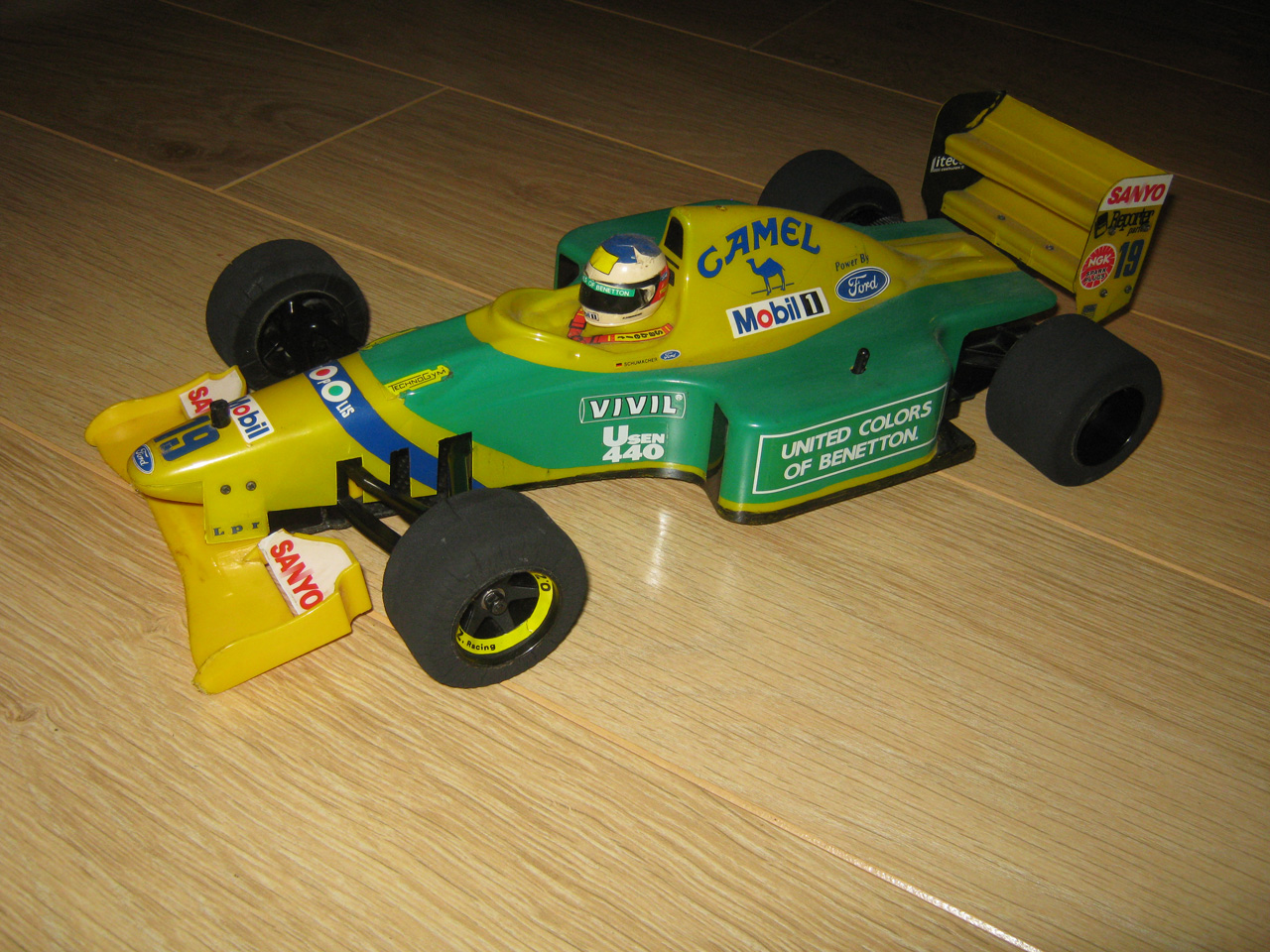

I then put on the wheels and took some picture without and with the body:
The body will need some improvements, but that's for later. I also will have to source electronics for it, but that can wait a bit since it's winter here now and very wet, and F1s can't run in the wet. :wink:
