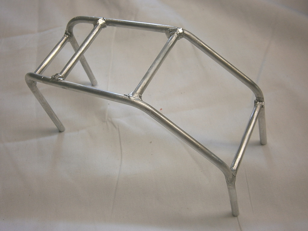

A little out of practice but it turned out straight and not to awful bad. Lots of file work but I'll get it looking good.
Re: RC10 Factory Works C2 "Tuber" Build
Posted: Sat Aug 25, 2018 1:16 pm
by XLR8
Looks good.
Did you TIG weld it?
Posted: Sat Aug 25, 2018 5:09 pm
by NomadRacer
XLR8 wrote: ↑Sat Aug 25, 2018 1:16 pm
Looks good.
Yes, looks kinda messy but it's cleaning up nicely. I had worked a little bit with a Dremel before the pic. Back at it a couple more hours so far...

Another benefit of working with aluminum (besides the obvious fact that it's light) is that it's soft and easy to sculpt.
In fact, it's soft enough that I can even cut it with my carbide tipped woodworking tools.
Aluminum, Kydex, Styrene, G10; with these materials you could build a car from scratch.
... and I'll add one other material. I needed to build a centrally mounted transfer case for an SCX10/Jeep that I finished last year (the motor and primary drive were relocated to the front), so I used blocks of cast PVC to make the case halves. This is the same material as architectural trim. It worked great. Cast PVC has similar properties to sintered nylon (although not as strong) and it cuts like butter. I've also used it to make a pair of cylinder heads for a scale 350 Chevy, the texture is like cast iron.

Yes, it does work very easy. I'm having no problems getting the joints smoothed out to my liking. Getting close on the front two cross members. I''ll hold off on the back two, going to add some more tubes there and want to have the added security of more "meat".
