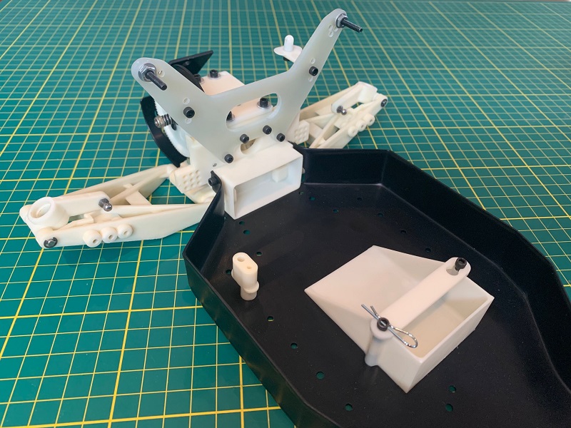

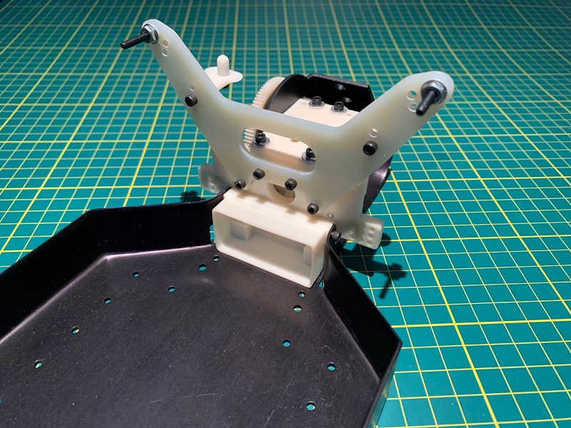

Today we got the front end all finished up:
And started on the rear arms:

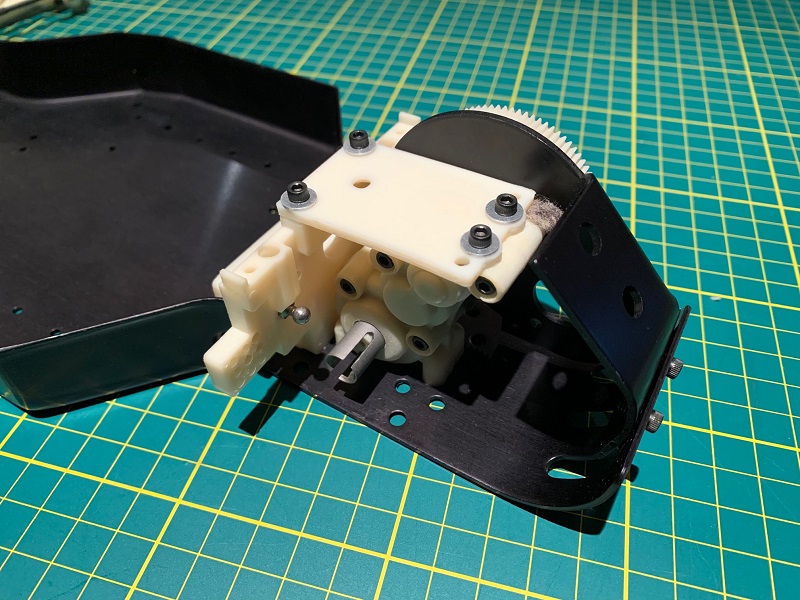

We made some progress on the back of the truck yesterday:

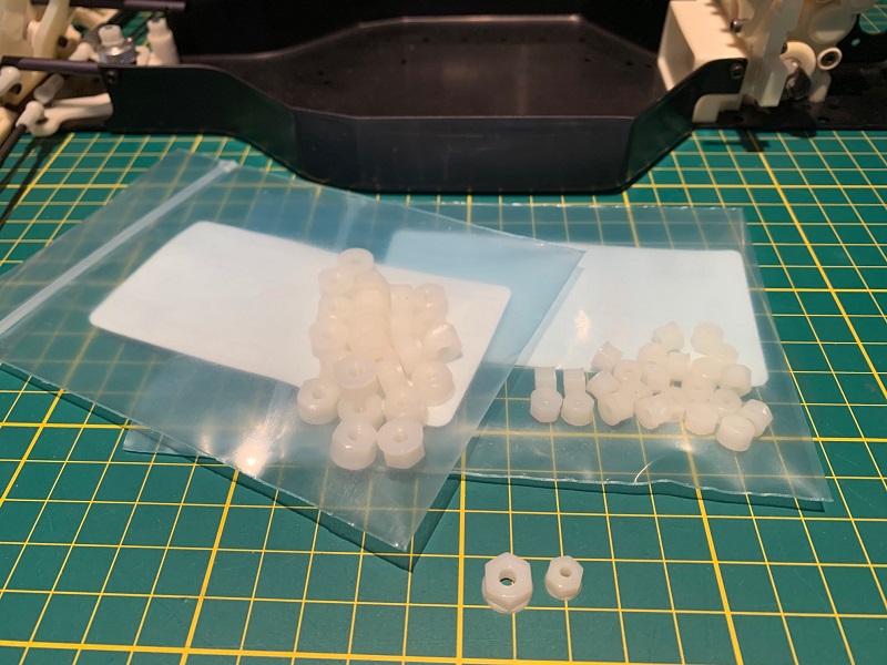

I noted earlier in this thread that I couldn't find any decent white nylon 4-40 flanged nuts in my parts bin, and it seems they are no longer available from AE. However, I was able to source similar nuts online. I ordered 25 in 4-40 as well as 25 in 8-32, which arrived yesterday. The may not be exactly the same as the AE ones, but close enough for me:
Re: RC10T Team build from parts bin
Posted: Sat Apr 25, 2020 1:47 am
by DaveM
Hi, do you have a link for the nuts?
Posted: Sat Apr 25, 2020 9:25 pm
by AustinZ
Seconded on the nuts, I need a stockpile of those! Wonder if they have other colors too
Posted: Sat Apr 25, 2020 11:20 pm
by RC10th
Thirded on the nuts
Posted: Sun Apr 26, 2020 4:20 pm
by cobalta70
The nylon nuts are from Essentra Components. The 8-32 ones are part number 0700832LN or 0700832SLN. The 4-40 ones are part number 0700440SLN or 0700440LN. I believe the difference between the two sets of part numbers is that the 's' variant is self-threaded. They are also listed as white instead of natural. Although I ordered both the white ones and natural and they look the same to me.
On thing I did notice is that the flats on the 4-40 nuts are slightly under .25 so they are a bit smaller than the AE ones. I haven't checked the 8-32 ones yet.
I don't think they make them in other colors, but I didn't look too close as I was only looking for the white ones.
I sourced them through Digi-Key as it was easy for me to order from them, but if you search online there are other options such as Grainger, Mouser, etc.
