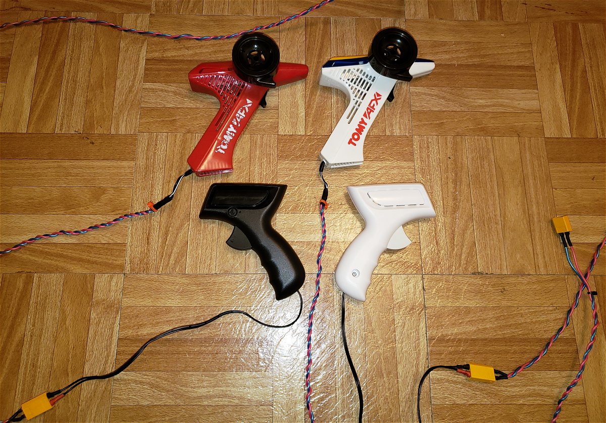

I've been using these AFX Turbo controllers (red and white with wheels, below) since I had my track decades ago. It seems they're pretty rare. The wheel isn't really a steering wheel, just a circular control for throttle instead of a trigger...and they have a fairly useless turbo button below the wheel. The more you turn the wheel clockwise, the faster your car goes, up to full speed. Press the turbo trigger and you instantly get full speed. You have to be careful handing these to the kids because they promptly jam the turbo trigger and the faster cars rocket off into the HO-scale horizon.

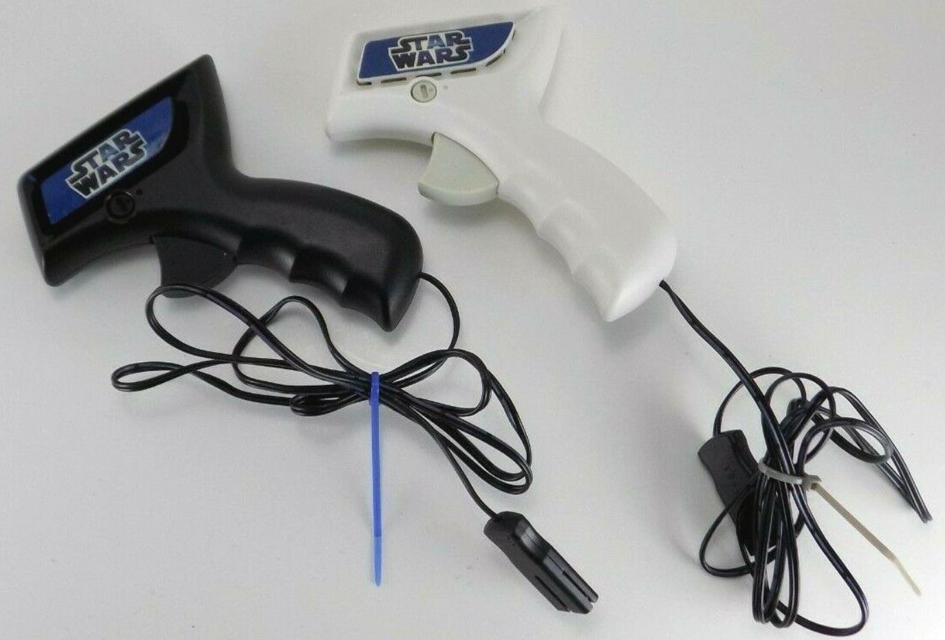

I discovered a type of Micro Scalextric HO-scale controller watching some guy's YouTube video that are 45 ohms and are an easy swap...with the added bonus feature of having a flat-head dial on one side that you can rotate 180 degrees in either direction...in one position, the trigger goes all the way; in the other position, it limits the trigger to halfway. With the AFX Tri-Power pack giving you Beginner, Intermediate and Expert voltage settings in conjunction with these controllers' halfway trigger limitations, you have a fairly good range of adjustments for any kind of car (except the aforementioned Super G+ modern cars, which will only work with 120-ohm controllers) and any skill of racing. I was also happy to see one screw attaches the 2 plastic half-shells together so they can be disassembled and cleaned. The appearance of the components and resistor inside looks significantly better than the vintage AFX ones, and have the wires loop around an internal plastic post on the inside just at the handle to prevent tugs and yanks from ripping out the fragile soldering that I had happen with one of the Turbo wheel controllers. And best yet, you can get these exact controllers all over eBay for $20 or less...a helluva lot cheaper than questionable or not-easily-identifiable vintage controllers and WAY cheaper than the hundreds you'll spend
per controller for the enthusiast-grade brands. Win-win!
The ones I bought were $4.99 on eBay for the pair plus shipping and came from some hinky-dink Star Wars Micro Scalextric slot "car" set, but they're the same controllers. I just removed the stickers with a hair dryer, cleaned them up and soldered on some connectors.
I again went overboard with some modding as I still had plenty of UV-reactive wires. I only had 2 orange AFX controller plugs for the terminal track, so I wired some male XT90 connectors to the leads, and female XT90's to both pairs of controllers so they could be easily swapped in/out. I did some test driving and indeed, these Micro Scalextric controllers give much smoother and precise control of the various cars at 45 ohms.
