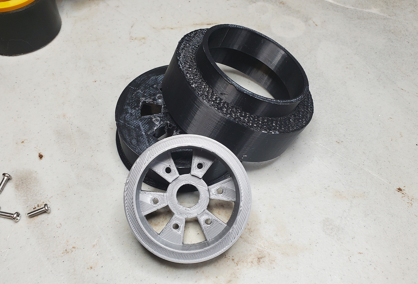

Got into the wheel creation for awhile, and I have to say that I love the design that eventually came from just goofing around, but ultimately, I am having major printing issues. :( The only color filament I have that would work is some "silver" ABS that I have used successfully in the past, but it has been awhile since I have messed with ABS (and ABS settings) and this filament has been sitting for just as long (in a sealed 5 gallon bucket with a passive mini dehumidifier in it). I am close to getting a good initial layer down, but after a few layers, it turns to hot garbage real quick. I have taken some wholesale changes at slicer settings, but nothing is really changing with the prints. I will stick the filament in a real dehydrator overnight and see if it is just a moisture thing. If not, I may need to wait on some new filament.

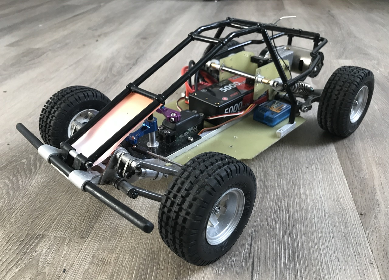

I really should put some time in mine again but as it will spend most of the time on a shelf it keeps falling lower on the priority list. Right at the top now is its kid brother: this 1/10 hybrid I'm preparing for a race at the end of february.

Mr. ED wrote: Sat Jan 01, 2022 5:43 am That's looking good.
That car deserves a thread , Zerda cage , Super Trail suspension and a Scorpion gearbox , love it :D

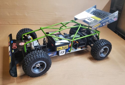

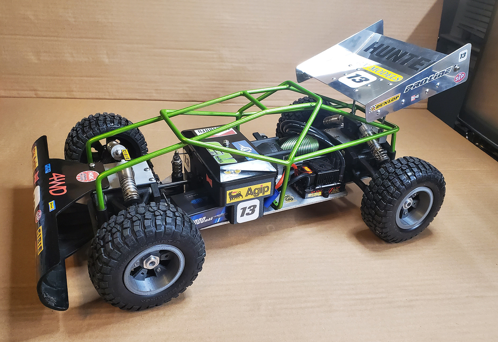

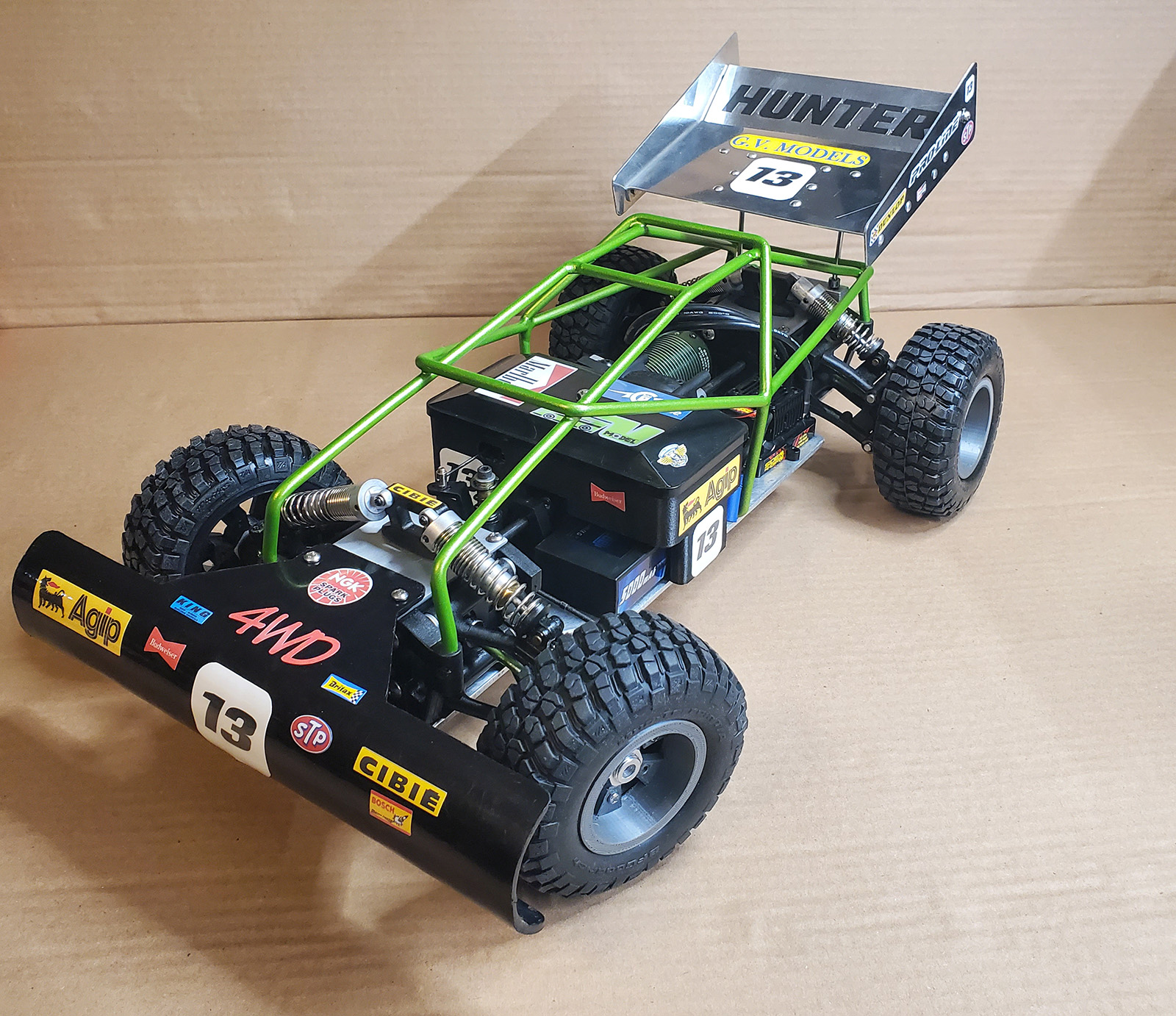

So, am I the type of guy that paints and decals a rig before finalizing essentials such as steering and battery mounts? Yep, I am that guy! :D
Remaining:
Steering: New rx/steering box is in printer now that will hopefully be final for final servo set up. For now, the stock steering set up will remain.
Batt mounting: Half of the remaining will be with rx / steering box. Front mounting TBD
Final motor / gearing / testing
Front lower a-arm needs to be replaced as one brass ball stud thread broke off in the arm. I have a replacement arm, but I think I can swap sides on the current arms and re-use them. This involves complete disassembly of the front end. :(
Shocks: I hate the current / OEM shocks! Finding replacements with similar dimensions is near impossible. I am hoping now I can replace the springs and maybe print new pistons to make them useable.

Maybe try swapping the cage around: I find it looking better that way.
morrisey0
Posts: 1732
Location: Richmond, VA
Has thanked: 77 times
Been thanked: 1762 times
Re: GV (Great Vigor) Hunter 1:8 4WD Nitro Buggy?
Post by morrisey0 »
Mr. ED wrote: Tue Jan 04, 2022 1:42 am Maybe try swapping the cage around: I find it looking better that way.
Swapping the cage around puts the center supports right where the rx box is. I wish it was symmetrical so it was an option.
