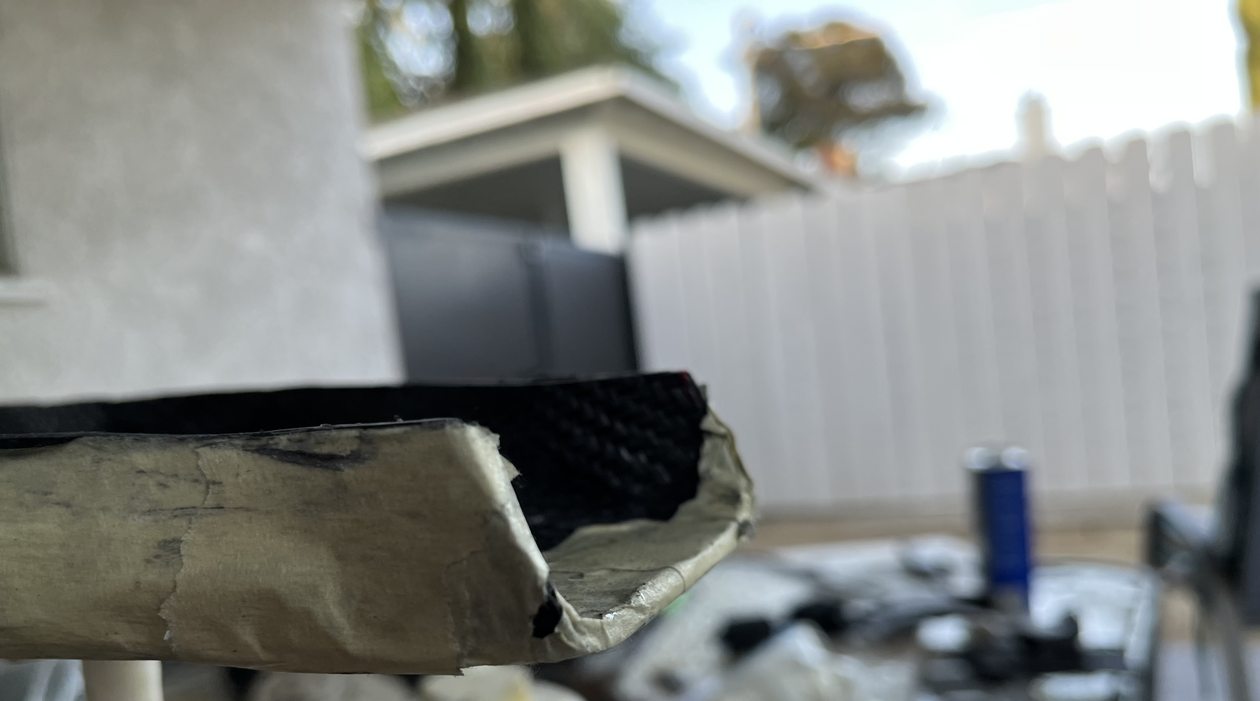

I added the last cosmetic layer and the chassis is now an even 3mm thick. Very much overkill but it’s going to run just fine. I taped up the outside and started trimming. The t2 has a lot of variations on the side wall height.

by JosephS
The sides are trimmed and the tabs are cut into the back. The chassis is about 5 mm longer than stock
