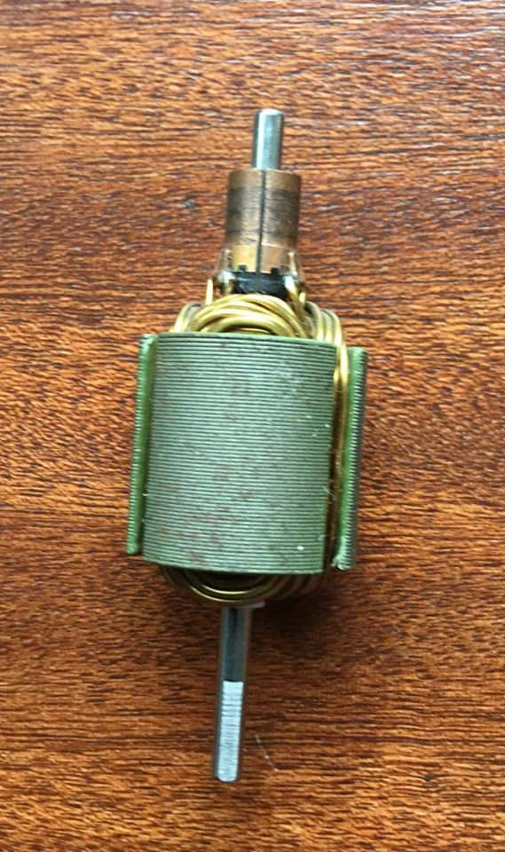

I do have a few other unusual Demon motor bits and bobs... the first being the aforementioned armature with aluminium windings. Jamie Booth lived with Nick for a while and told me it was during this time that Nick was experimenting with these. I received these in a Demon care package from a close friend of Nick's - in fact this guy used to travel to the Sagami factory with Nick fairly often and has sent me several pictures from their visits.
It is a 20 Single, and Glyn Ward has tested it for me following a quick skim and in the same can/timing setting against a copper-wound 20Single to see how they differ.
Both 0.9mm wire.
Copper 21,000rpm at 2.6amps
Alloy 18,500 rpm at 2.6amps
Temp after 5 minutes no load copper was 36.7 C and alloy was 45.4 C
An interesting comparison anyway... guess that is why they stuck with copper!

Regarding the aluminium windings, I wonder why it was tested. To me it makes no sense.
Maybe it´s less weight but a faster spool up time don´t make much sense when traction level is low.
Also aluminium is a quite bad conductor. Also not that easy to wind because it´s more stiff and breaks easily.
