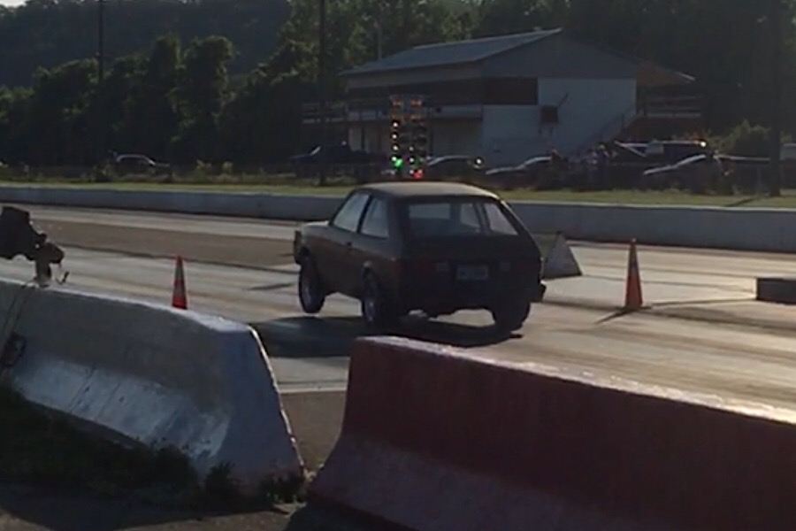

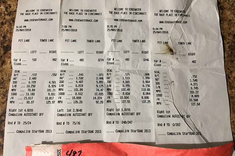

New best of the night was. 10.56 @ 127
Re: Project: LS1 Chevette
Posted: Sat May 26, 2018 1:12 pm
by Diamond Dave
That is damn good. Having a 10 second car, for what you have done... very cool!
