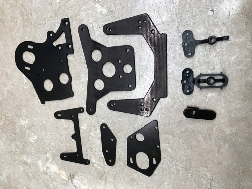

Can't tell from the pic - but stopped by the hobby lobby and they don't stock the plus dye in black. I think it was graphite. Local Michaels doesn't carry the plus... I check online later.GoMachV wrote:I have dyed the A&L pieces before. The problem is that the dye has changed. The current Rit dye that looks from the outside like the dye we always used isn't the same anymore. Look for their "dye more" version. This was found by another person at Walmart. I have yet to try it, but I was less than pleased with my last experience with the regular dye

Just did a batch last night. Graphite is what you want for black. They just needed a fancy name for it lol
Even my towers took, and I've never been able to get my material to take dye

So I see "RC10GT" written on that A&L bell crank package... is it possible to use it on the GT as well as the RC10T (which I assume is what you're using it for)?

GT/T2 stock bellcranks are shorter. A&L only ever sold the shorter GT/T2 style cranks, and they work great you just have to use the forward set of mounting holes in the noseplate.
