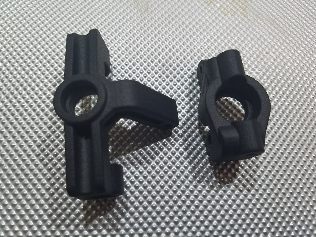

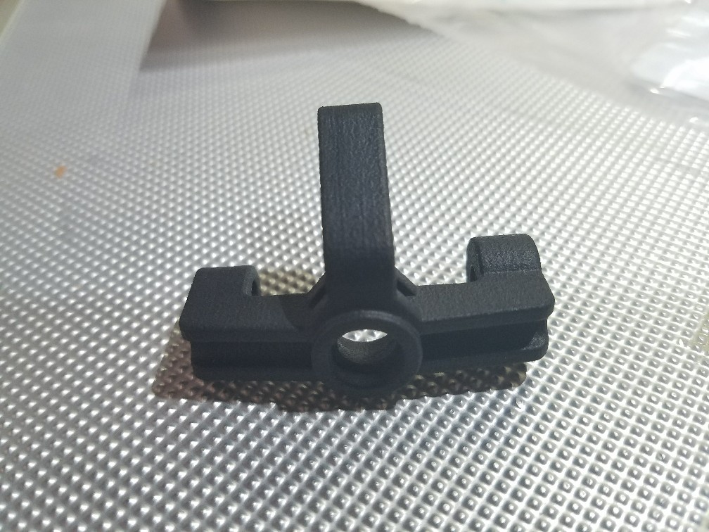

The caster blocks and steering blocks of the Ten4 have always been a bit of a weakness. The SLS nylon printed parts just aren't as strong as molded parts, and on high stress parts like those they don't always hold up well in crashes.
Shapeways is introducing a new printing platform, the HP Fusion printing system. Still nylon, but supposedly with much higher density and equal strength in all directions. SLS parts are weaker in the Z direction than in the XY direction, but supposedly this is not the case with the HP parts.
I ordered a set of caster and steering blocks made with the HP system to try on my Ten4 test car. I plan to run the car first with SLS parts and see if I break them, and if I do I'll replace them with the HP parts and see how they hold up.
Visually the parts look more like molded parts to me. They don't have that rough/gritty surface of the SLS parts, more of an "Orange peel" surface.
The good news is that the price of the HP parts seems to to be about the same as the SLS parts, so if these seem like an improvement they should be the same price for you guys.
I'll keep you posted on how it goes
