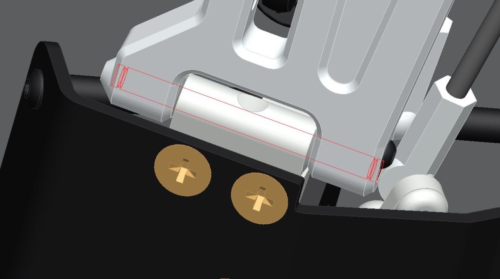

Wide front arm for RC10/NIX10M buggy nose. Leading thought: Racing.
Designed to be used with #6220 wheel axle and B4 front wheel. Uses standard inner hinge pin #6226 but mounted without C-clips. Screw #9645 holds hinge pin in place. One extra shock mounting point.

by harvey
Such a good design for the arms Niki! It seems like the front arms always eject the e-clips once they are worn down a bit; these should solve that dilemma.
You've been working tirelessly to bring the vintage community such awesome option parts. Thanks so much!

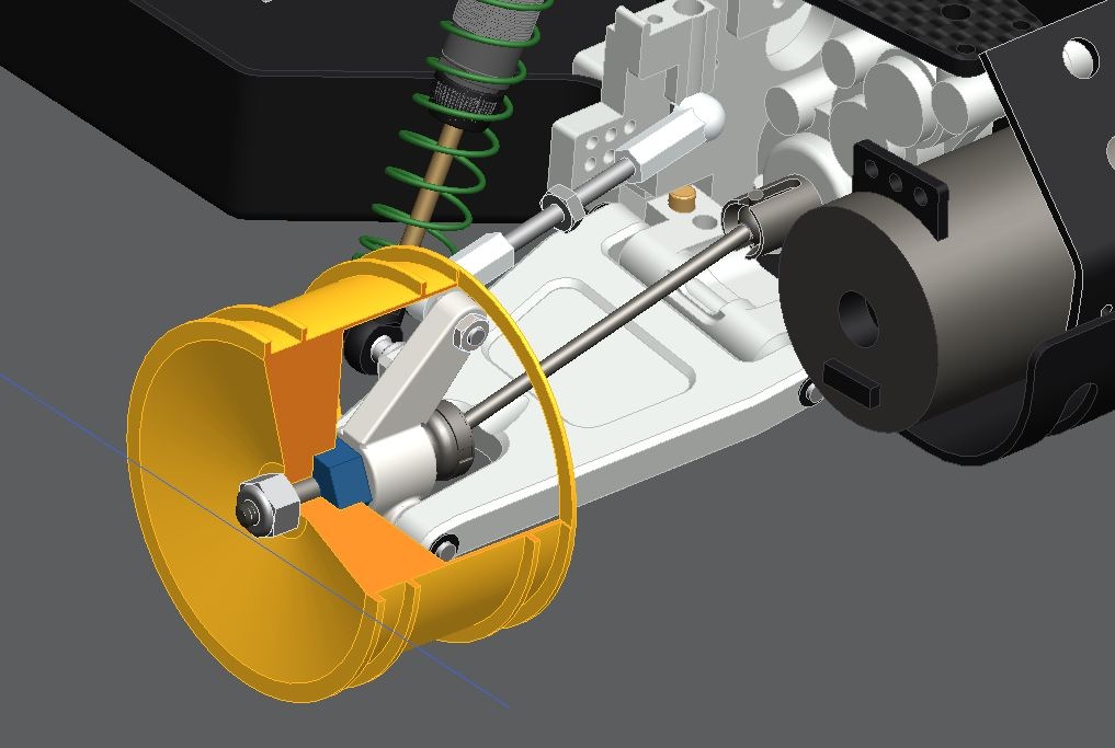

This is new wide rear arm for RC10 and NIX10M.
Designed to be used with B4 CVA bone #9672, B4.2 hex adapter #9890 and B4/B5 hex wheels. Non-hex B4 wheels obviously can be used also with wheel spacer mounted under axle pin. Sample parts feel really strong and solid.
http://shpws.me/Hnfu
