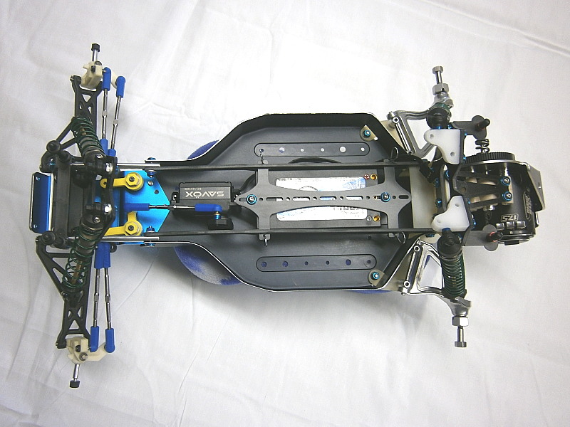

by NomadRacer
Yesterday I received a chassis stiffener/lipo holder kit from Factory Works. Very cool kit, solved my battery holder thoughts on what to do/what holders to use. I'm having a great time building the truck. Next up will be some body mounting action.

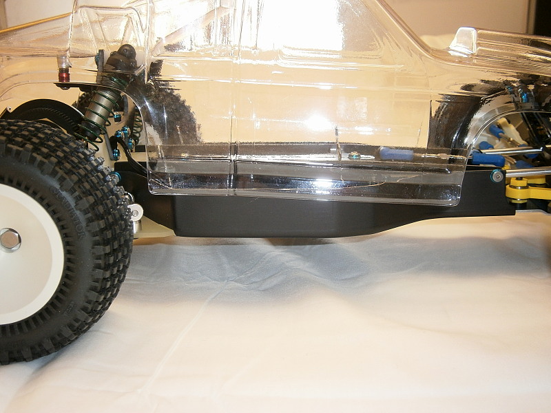

Posted: Thu Feb 08, 2018 10:56 am
by NomadRacer
I'm sort of stuck on the body mounting right now. As you can see in the pictures, there's an extreme rake from front to rear. I've added some spacers under the rear body posts (4.5mm total) to bring them up the the bed, bed is resting on the shock tower now.
So, what do you guys think... Do some precision cutting around the tower and shock mounts points to allow the bed to drop down? I'm not digging the extreme rake look. :?
Re: NomadRacer's RC10 Trailing Arm Truck
Posted: Thu Feb 08, 2018 11:00 am
by GoMachV
Back in the day we would have cut the area out that was interfering. A lexan cover could be precision cut and bent to bridge the area over the tower between the two existing humps. Use a couple small BRP plastic rivets to hold it. Just my .02
