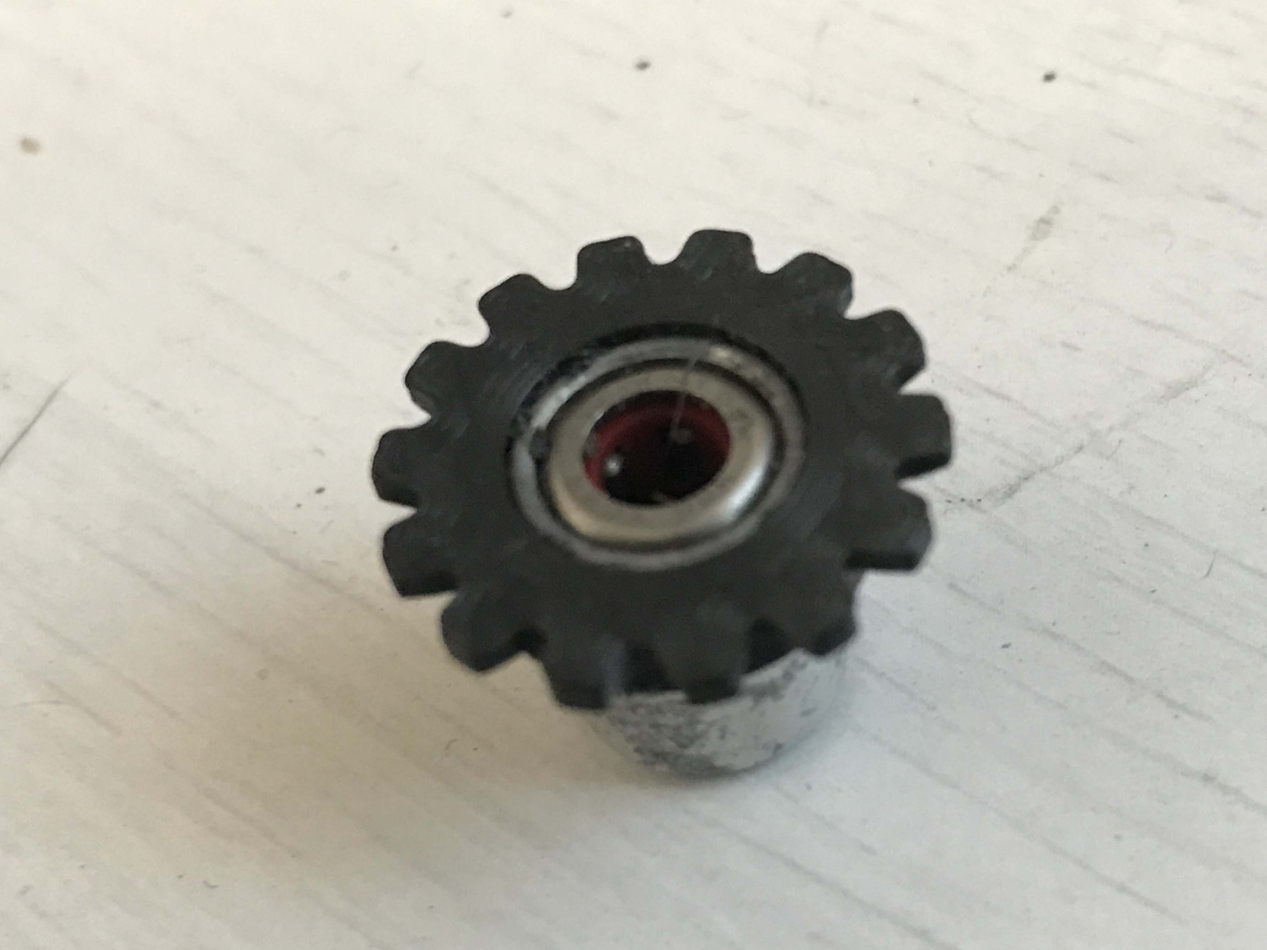

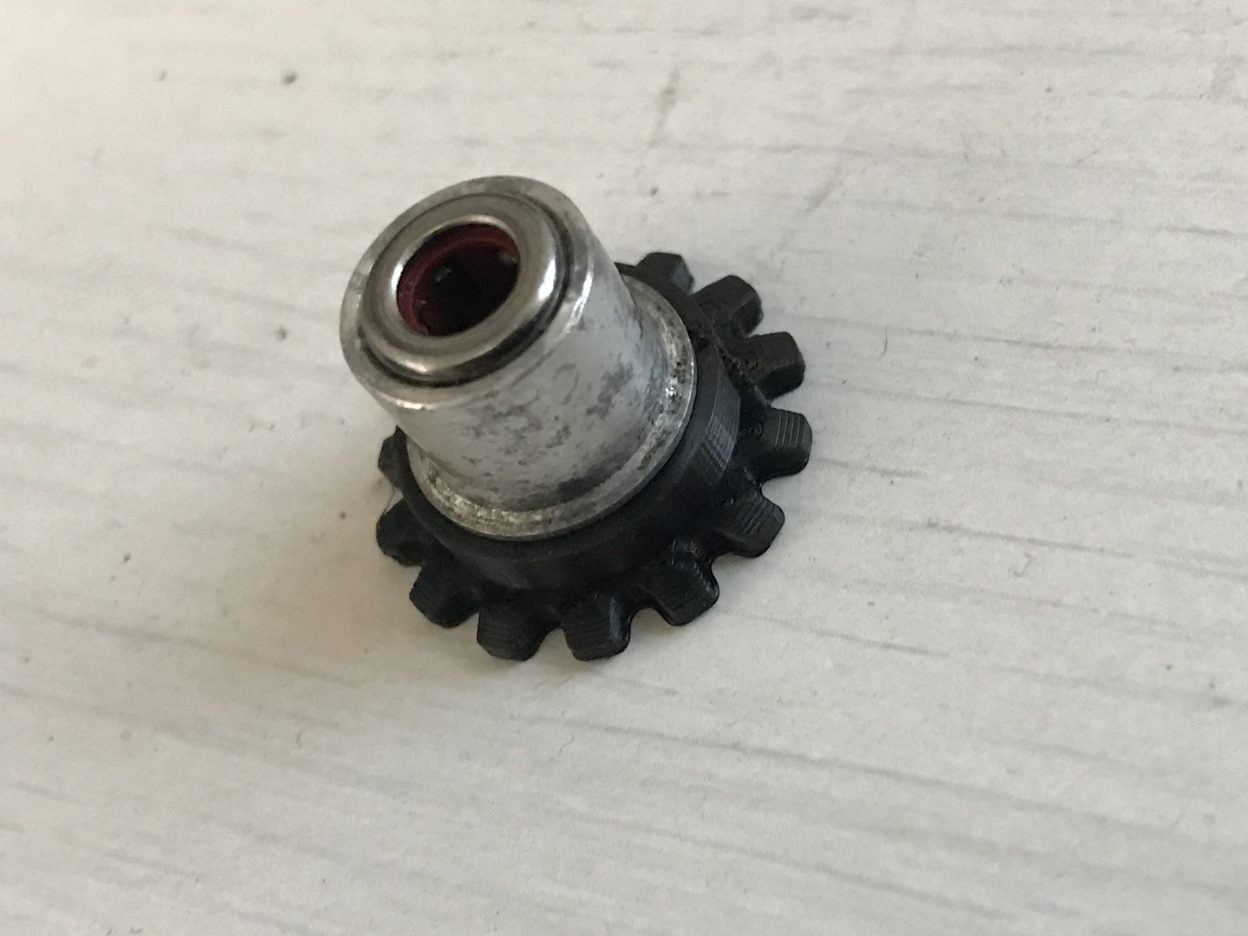

Found a first gen Kyosho EP Fantom parts lot and of course it had the famous broken sprocket. I was able to find a cad drawing off sdp/si for a 15t sprocket (grabbed a 14 as well) and was able to modify it for a press fit on the stock one way assembly. I don’t expect the pla part to hold up to much power, but as a proof of concept it was perfect. I now have an order in with shapeways for a nylon print.
