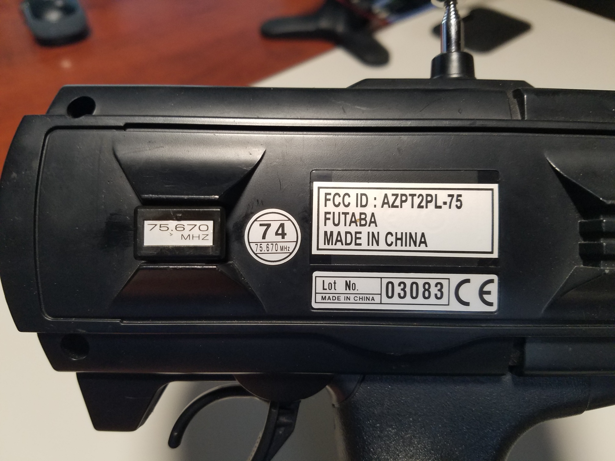

Someone please school me regarding AM radios and crystals (I have a Futaba Magnum 2PL, 75MHz). I haven't used an AM transmitter or crystals since circa 1995, and have only used and familiar with 2.4GHz systems. I'm at the point of installing the electronics in my Kyosho Pro XRT and want to use the 2PL and either Futaba R142JE or R152JE receiver. First thing I need is a crystal set. Where do we buy crystal sets these days? Are these basically an ebay only thing now? The 2PL has 10 model memory so I plan to use this transmitter for multiple vintage r/c's as I finish projects. Does that mean I need multiple of the same frequency crystals?
PIcs of the tx and the crystal that's in it. FYI, this is the only single crystal I have. If any members here on the site sell these, please let me know so I can support fellow member(s).

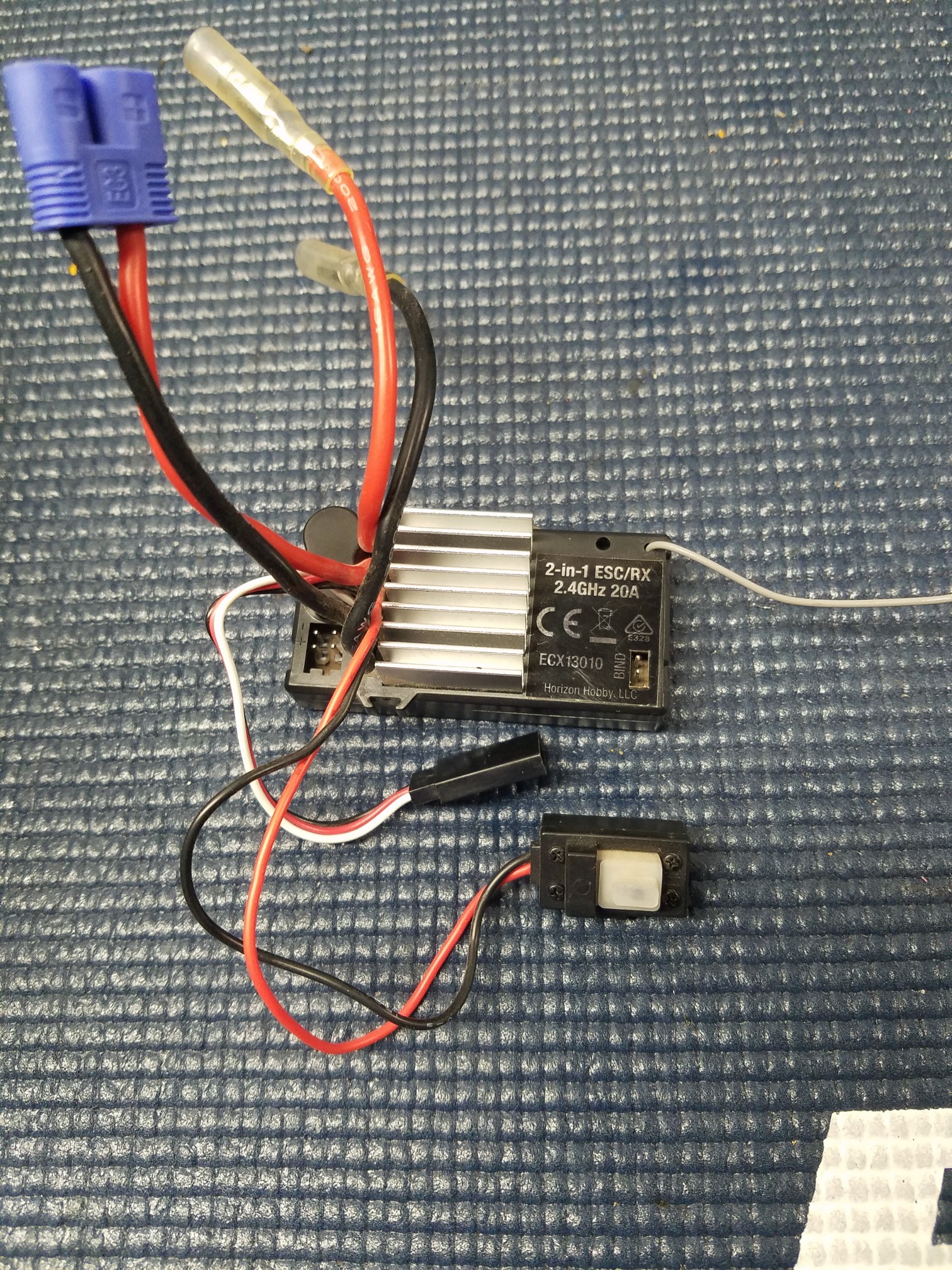

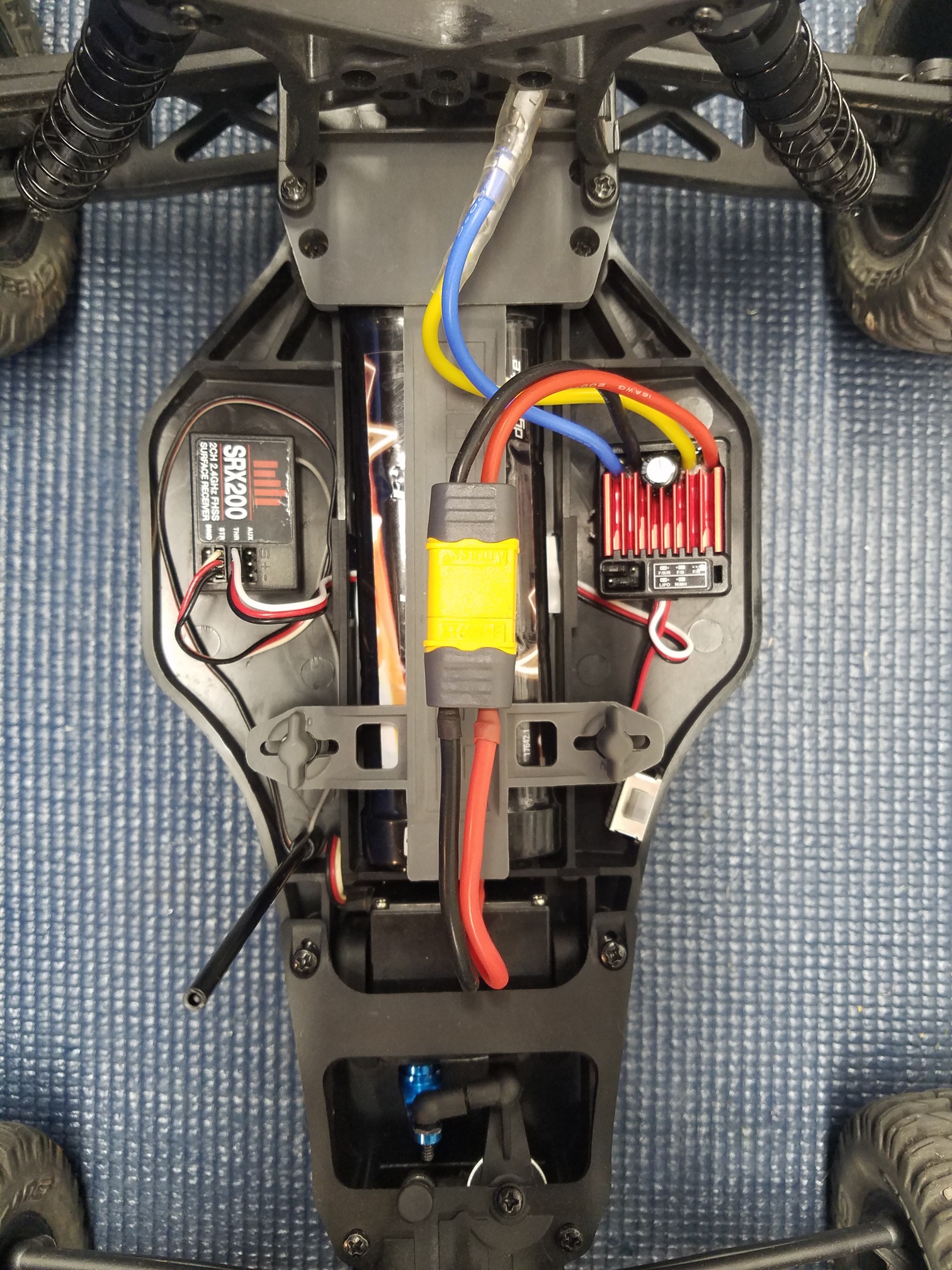

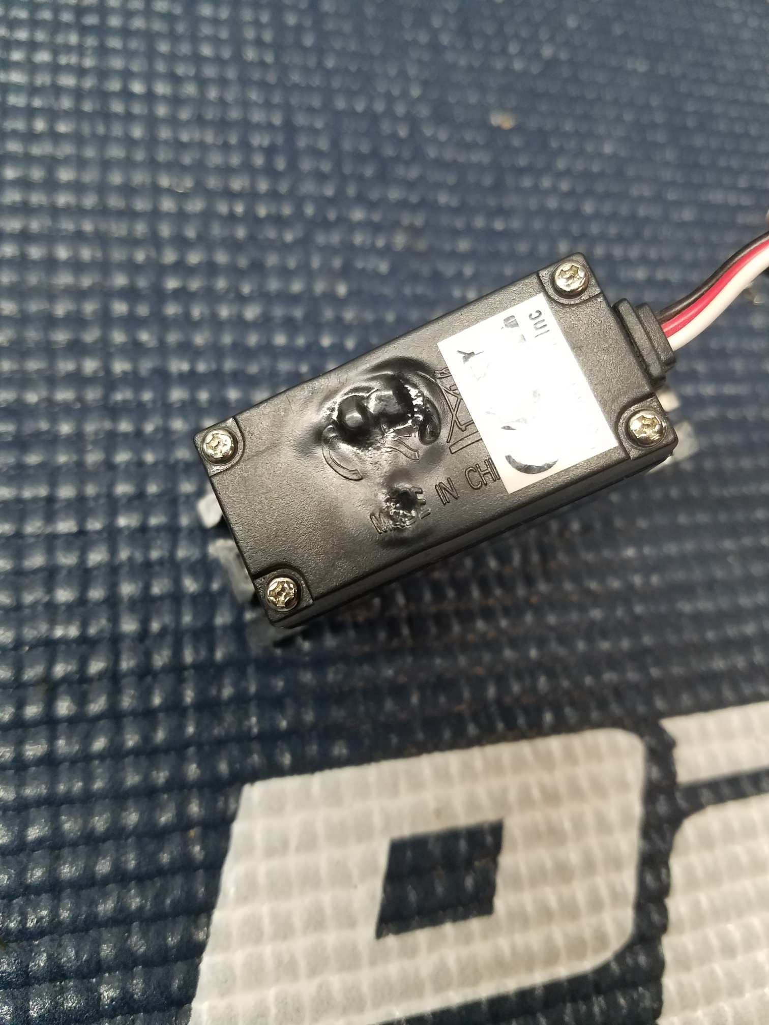

Couple weeks back the boy (6 yr old) and I were out in the yard playing with the rc's. His ECX Amp all of a sudden came to an abrupt stop and died. I checked the factory esc/rx combo and servo, both were toast. The backside of the servo case is melted and the esc/rx no longer works at all, so everything got replaced. We installed an old Futaba FP-S148 servo from the stash, a new Hobbywing 1060 brushed esc and the Spektrum SRX200 receiver and STX2 transmitter from my Arrma Typhon 6s. Also an added bonus, the esc on/off switch is in a much preferable location. I kept the stock Dynamite 20T motor in it for now because it's still plenty fast for him, but have a Dynamite 15T motor for it when he's ready to step it up a bit.
