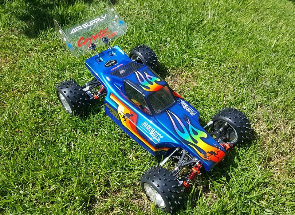

So next up was tidying up the suspension geometry as well as to upgrade the pish original shocks for some Scorpion items. We made some brackets to take some of the flex out of the wishbones, which had been an issue, which also served as multi-point lower shocker mounts. We now have a super smooth suspension movement and the throw is much improved also.

Been a while since anything happened with this build, as we have been focusing on other cars, but the rear wing has gone on now and we are now looking at lowering the bodyshell down a little as it is really only the body mount posts themselves which are raising the shell up a little higher than it needs to be.
Quick mock-up looks fab though 8)
Once the shell position has been addressed the electrics are going in next. I need some sort of Lipo securing system so that requires a little thought also. This thing is so damn light it is ridiculous.
