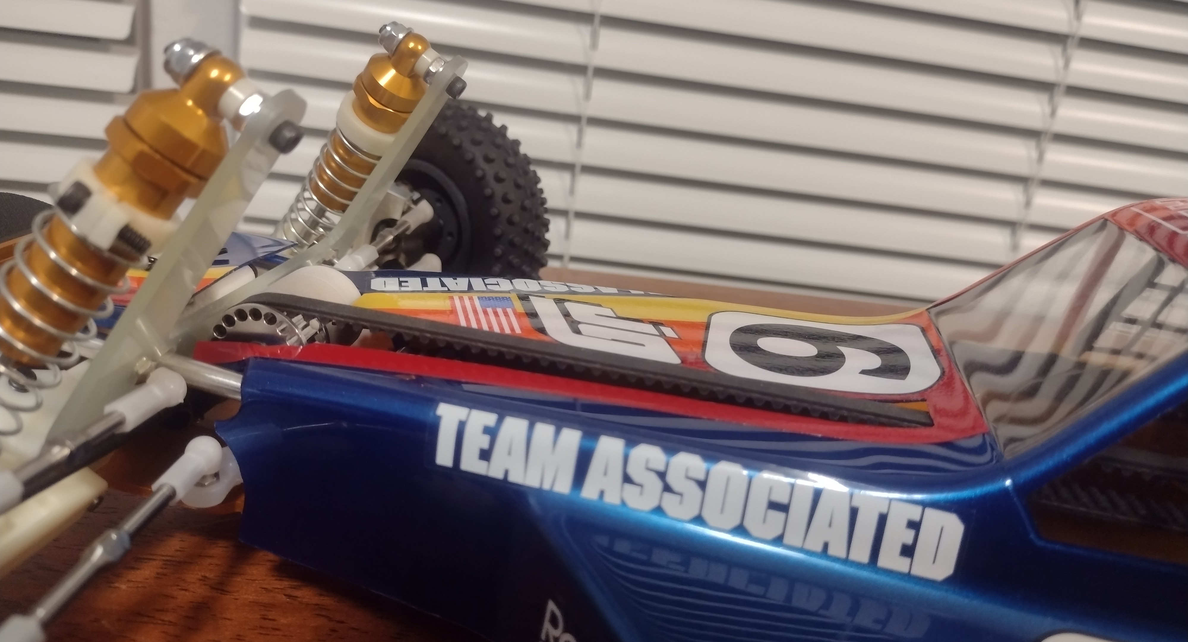

I lowered the body and exposed the kit on my Halsey

mark wrote: Sat Dec 07, 2024 3:56 pm I lowered the body and exposed the kit on my Halsey
That is so cool! If Jeff ever offers this kit again I need to find a car to use it for and do this same thing.
