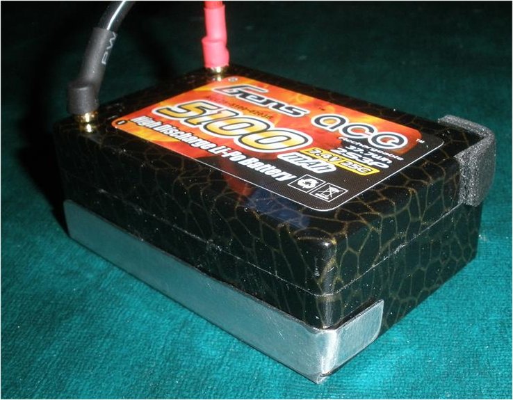

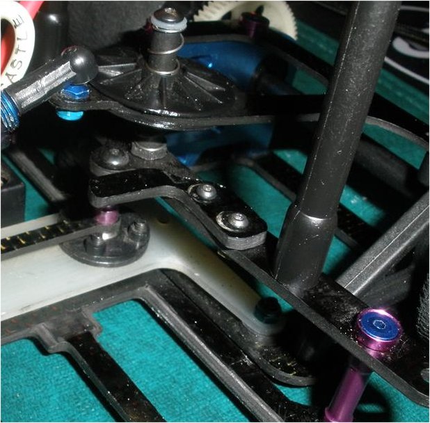

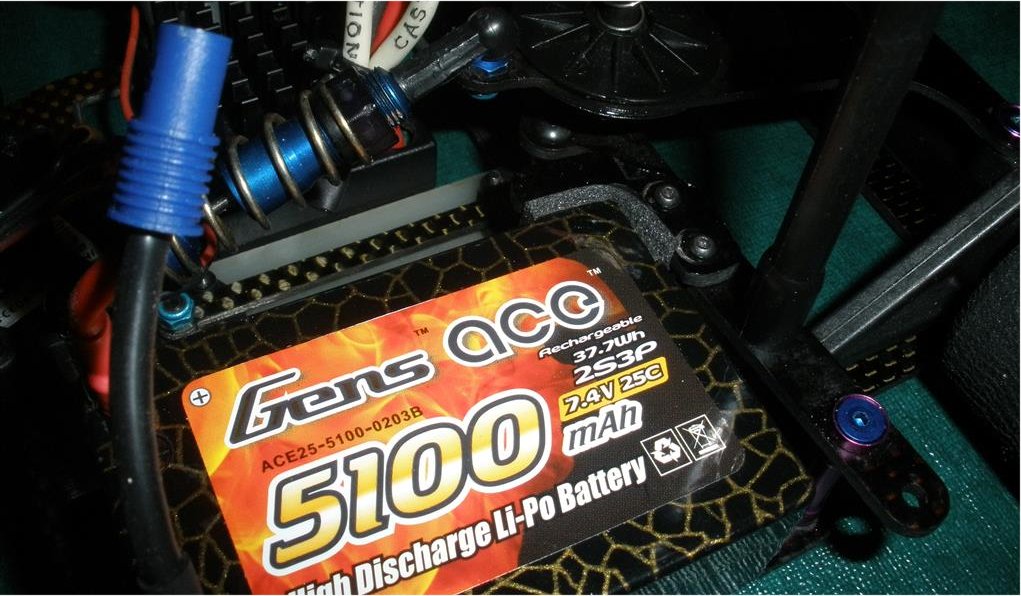

Since I seem to have run into an obstacle with ESC & 1S LiPo compatibility, I gave up on finishing the electronics and began fabricating a custom battery hold-down. It has been quite a challenge as this chassis was never intended to house a hard-case LiPo. I found that the battery was taller than the lateral carbon piece by just enough for me to cut out an L-shaped piece of carbon, then bolt it to the lateral piece to keep that corner of the battery positioned. I'll use the closer screw-hole to add a tab over the top of the battery which will screw down with a wing-nut or something.
I decided to butcher an old computer tower I/O slot cover as it had an L-shape already formed into it, and it's very thin, and seems strong enough to not bend too easily. I made corner tabs in each section and used a file to round the corners and smooth all the edges. The battery will fit like a glove. I sanded it down and it's waiting for a coat of SEM Trim Black to dry. The foam tape at the top right corner of the battery is just to protect it from abrasion when it's pressed snugly against the L-shaped piece.
All that's left to figure out is a way to secure the front of the battery.
