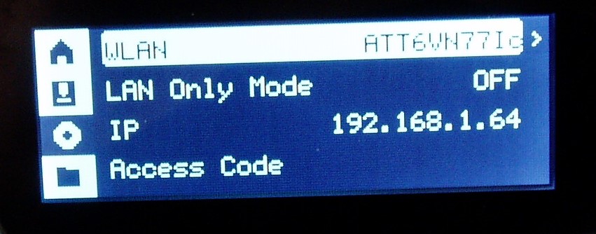

Maybe someone could check this and report back? On my AT&T router manager, the list of connected devices includes "espressif" - is this the P1S? If so, then it confirms that the printer is connected.

My X1c's are listed as "Ampak" as they run a different controller, but a quick google shows others saying the P1 will come up as expressif (as well as smart light bulbs, switches, etc using the ESP32 module)

GoMachV wrote: Wed Nov 13, 2024 12:25 pm My X1c's are listed as "Ampak" as they run a different controller, but a quick google shows others saying the P1 will come up as expressif (as well as smart light bulbs, switches, etc using the ESP32 module)
Thanks Jeff. I thought if I turned off the printer, it might show as "inactive" but that's not the case.
Anyway, I just compared the IP and hardware addresses with what's shown on the P1's display and they agree. So that settles it; the printer is connected.

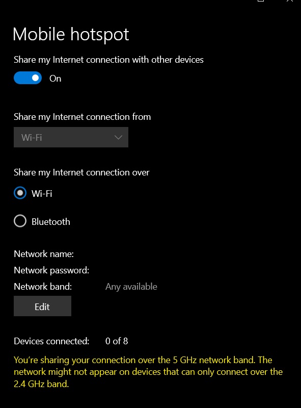

Anyway, I've enabled hotspot on my laptop but this is only for 5Ghz and I think printer is 2.4 - see note at the bottom of this screen shot...
Nothing happens; the display on the P1S hasn't changed. I've tried switching to lan only mode and restarted the printer but it does nothing. I still cannot update firmware or receive a pin code.
Any suggestions?

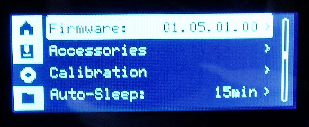

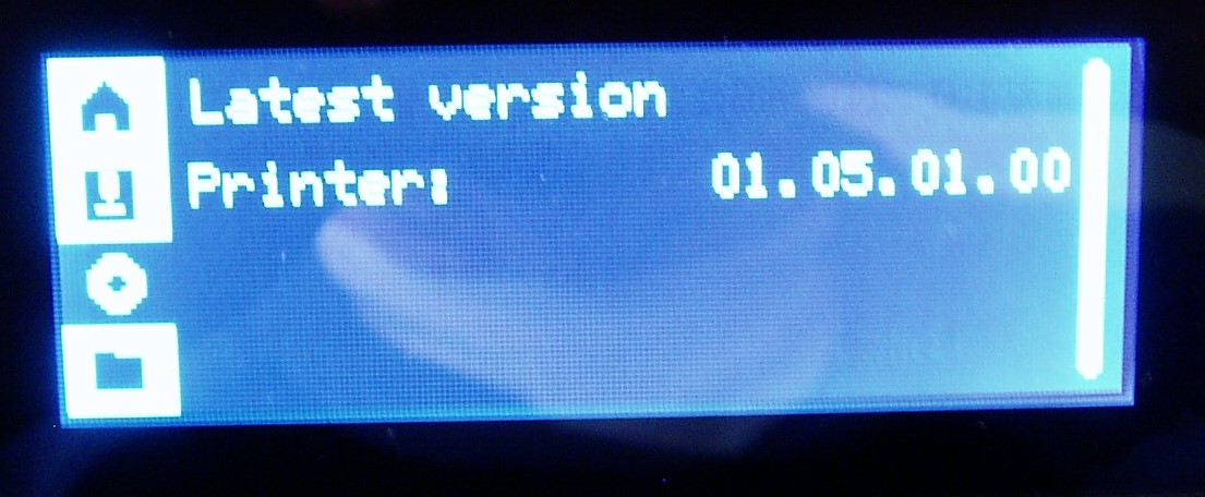

I have been sending Bambu support my printer screens so they will know which version is my firmware. So far, they have ignored my invitation to speak directly via a phone call and they don't seem interested in simply including with their email reply the firmware update file or a link so I can retrieve it from my laptop and update the printer via SD card. Without a file or link, I'm stuck with establishing an internet connection with the printer - which so far isn't working. I'm beginning to think the printer is defective.
So, here is current status; printer screens:

Firmware:

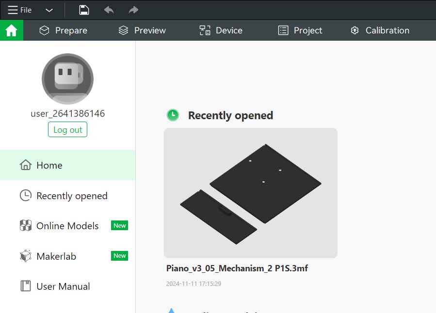

@XLR8 , did you download Bambu Studio already, and created an account already?
on the account screen you have the device name. Try to add this device name in Bambu Studio on Device page by click add

First, yes I have Studio version 1.09.07.52 and I believe it pulled my account info from Bambu Lab website (from when I ordered the printer a few weeks ago). Anyway, it shows I'm logged in but I don't recall ever setting up a new account after installing the software.
