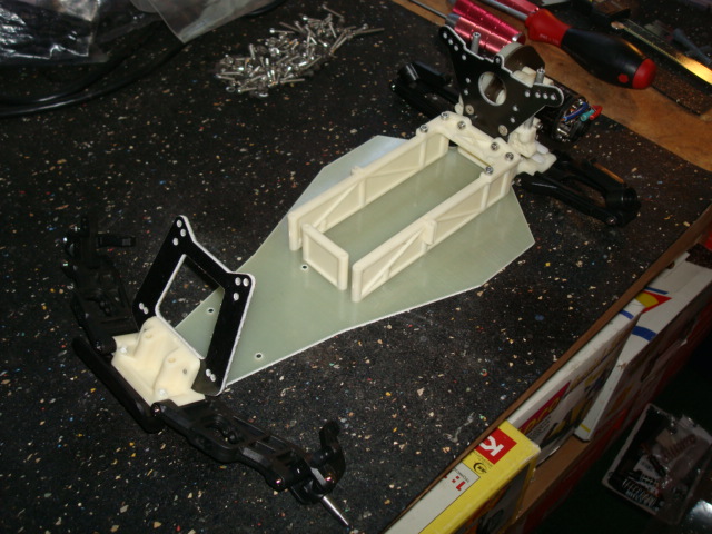

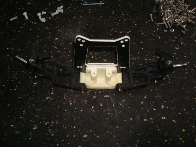

Re: Traxxas TCP buggy build...

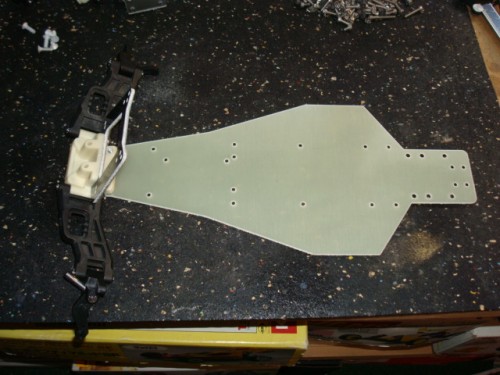

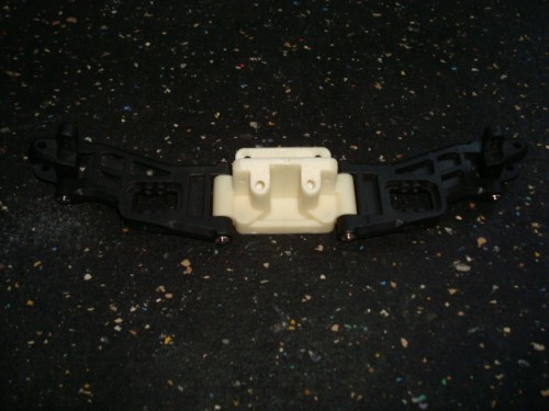

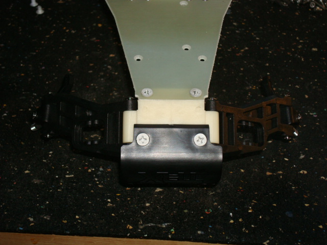

Build 1
Notes: Seems Traxxas suffered from the same ineptness as Associated as far as not countersinking their chassis enough. I will need to countersink all the 4mm flat head holes just a little bit to get it flush.

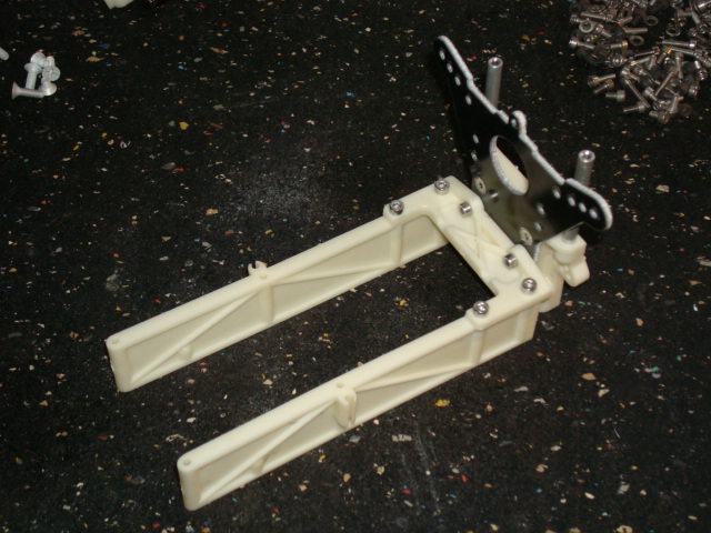

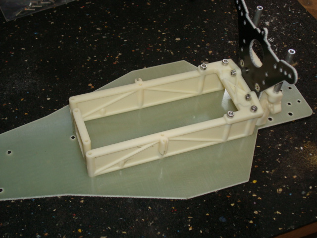

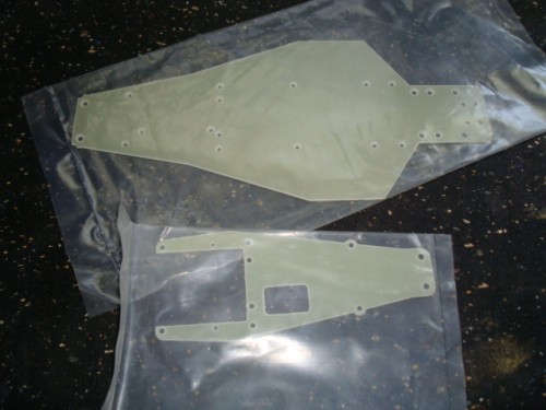

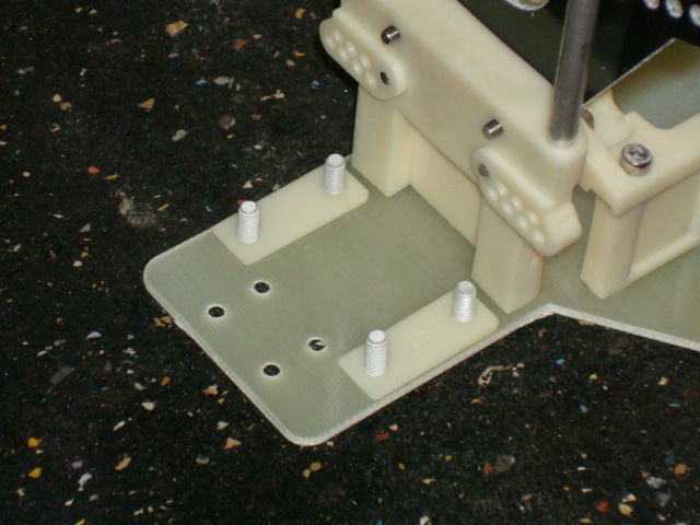

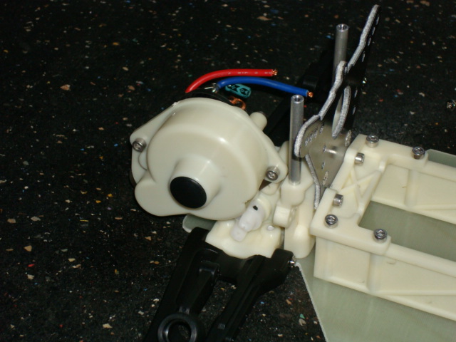

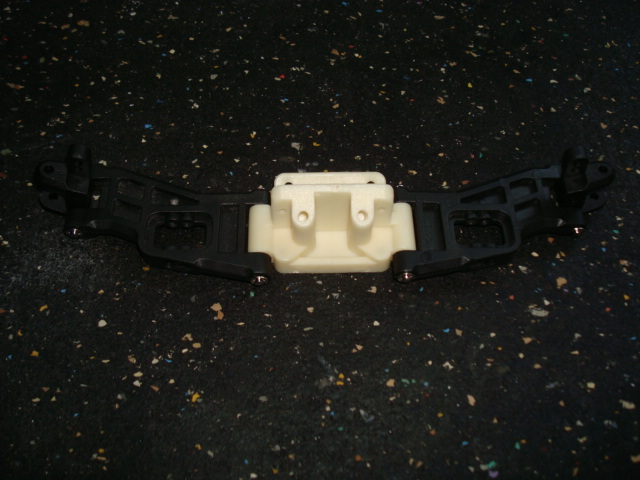

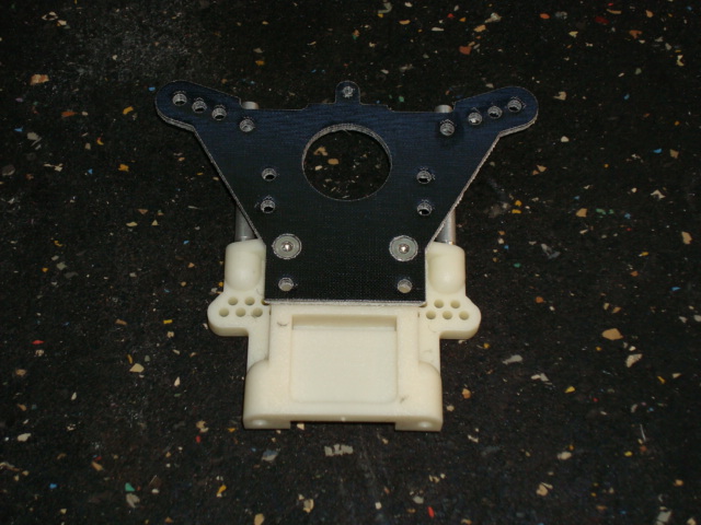

Build 2
Notes: The chassis stiffener is a stout piece. Should do the job well. The rear anti squat shims are a nice touch. It comes with a handful of different angled shims.

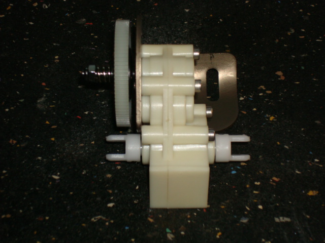

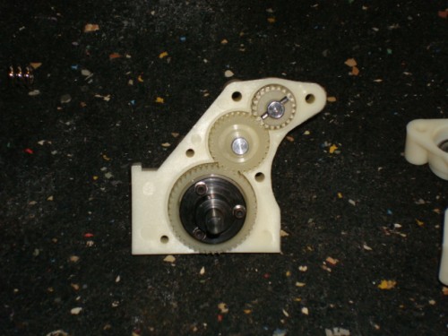

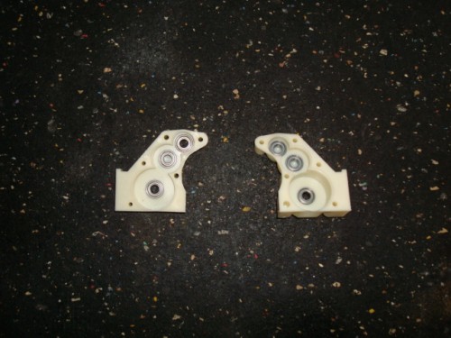

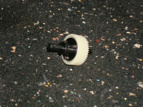

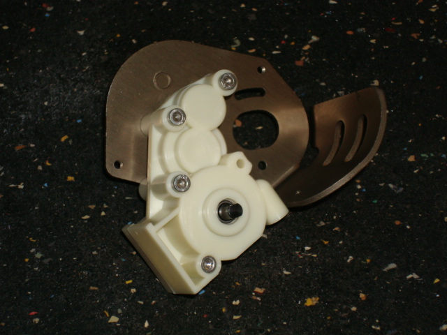

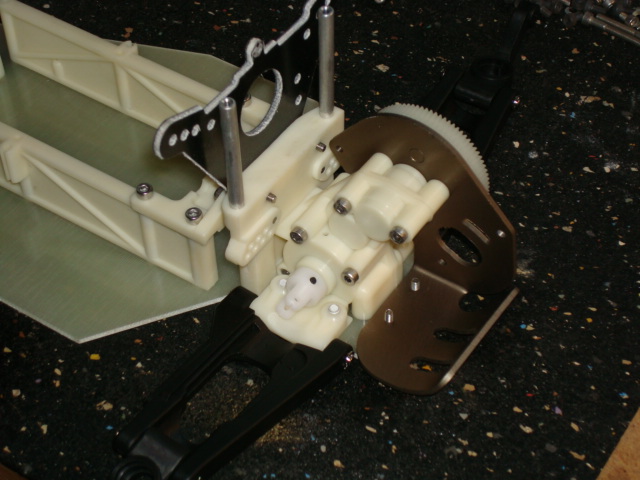

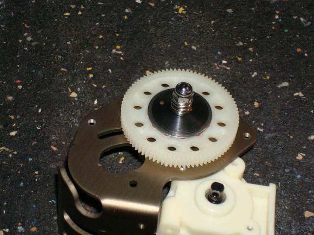

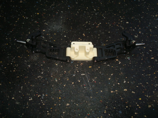

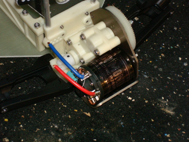

Build 3
Notes: I built the diff a few months back, so I will skip the details of it's assembly. I had trouble with the first one I got. The threads that the diff thrust screw went into had some issues and caused the screw to snap off flush... Traxxas sent me the new pieces about a week later, and the 2nd try I had no problems. It turned out to be a very smooth diff. I'm just not a fan of the bellville washers and no lock nut. (thread lock)
The pucks in the slipper seem to be a retarted way to go. And from what I hear, it is the weakness of the tranny for anything more than a stock racing motor. On a positive note, they drilled and pressed a small brass roll pin in the slipper drives to engage into slots in the slipper rings. Another nice touch is the adjustment hole in the diff housing. It aligns with a small hole in the trans housing. This allows you to place a small allen wrench from the outside and it engages the slotted diff adjustment screw. No need to remove dog bones to adjust the diff.
The trans is nice and smooth!
The tranny housing is keyed to the rear bulkhead, and I had to loosen the bulkhead about 1/8" to get it to slide into place. The tranny is a tight fit between the rear arm mounts, but didn't require and sanding for it to fit. Everything is very tight and slop free.

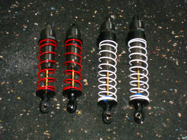

Notes: The traxxas shocks are very smooth, but not without their problems. They have the X rings instead of orings. I did notice that one of the front shocks looked like they were thrown together in a rush and they pinched the rings. The other front shock had the cap (with bladder) screwed down and the bladder was pinched and cut. Had to make another call to Traxxas, and they sent me the parts in about a week.
I ditched the Slash progressive springs and went for the proper kit springs instead.

I'm so jealous! Brandon, you know how bad I wanted another one of these, oh well, at least I'll get to see it at the track sometimes
Those chassis stiffeners are really hard to come by now, I think I dremelled mine to death on my TRX3
